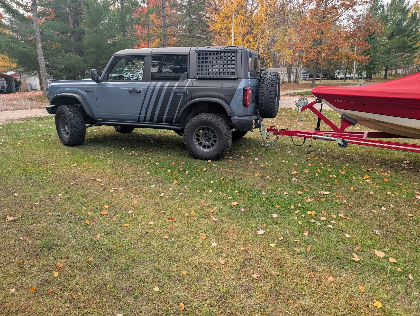

Wow. You were right. They are the best upgrade I've done this far. I towed the ski boat with them and it didn't even sag in the rear. Had to lower the hitch 2 holes. Very happy with the install.
