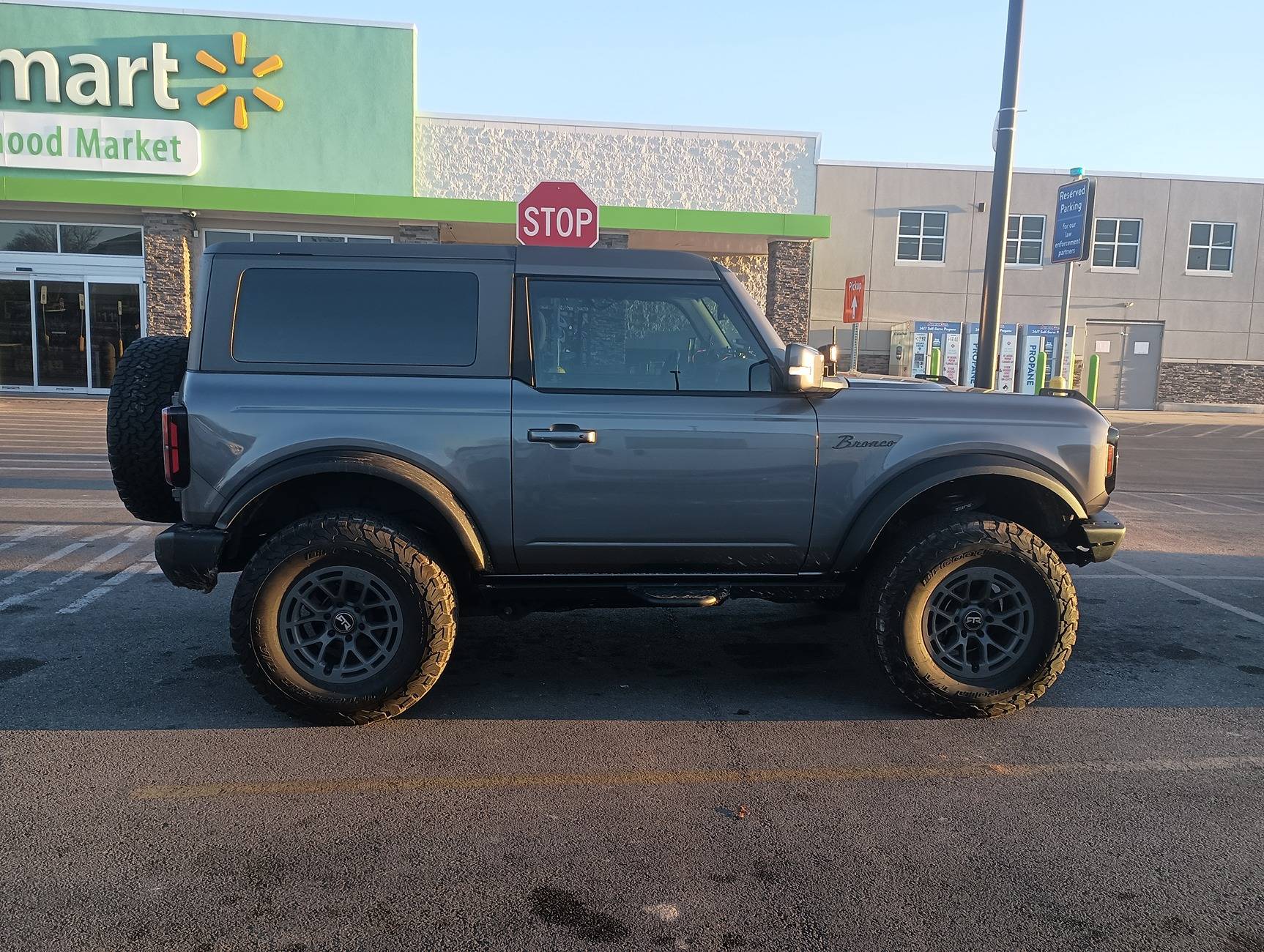

Here is how it looks with about 400# of gear in the back. Mind you, that's after removing 150# from the front (winch and associated hardware). So it might have been more level with the winch hanging over the front.
Ford Bronco Eibach coil over suspension advice needed for my application IMG_20250112_080924890
I took a before picture, but it didn't save, I didn't feel like unloading the 250# of water. I have about 150# of tools in the back as well.
Measurement of 25" from hub to the bottom of the fender in front. 24.25" from hub to the bottom of the fender in the rear loaded.
After unloading the water, it was 24.5" front and 25" rear. So 1/2" of rake "unloaded" with my 150# of tools and such.

mpeugeot, that helps me a lot. Do you know where the front and rear springs were set?
It looks like 250lbs on the rear makes it drop 3/4". That is significant but can be adjusted out if the rear springs were not adjusted near max.
