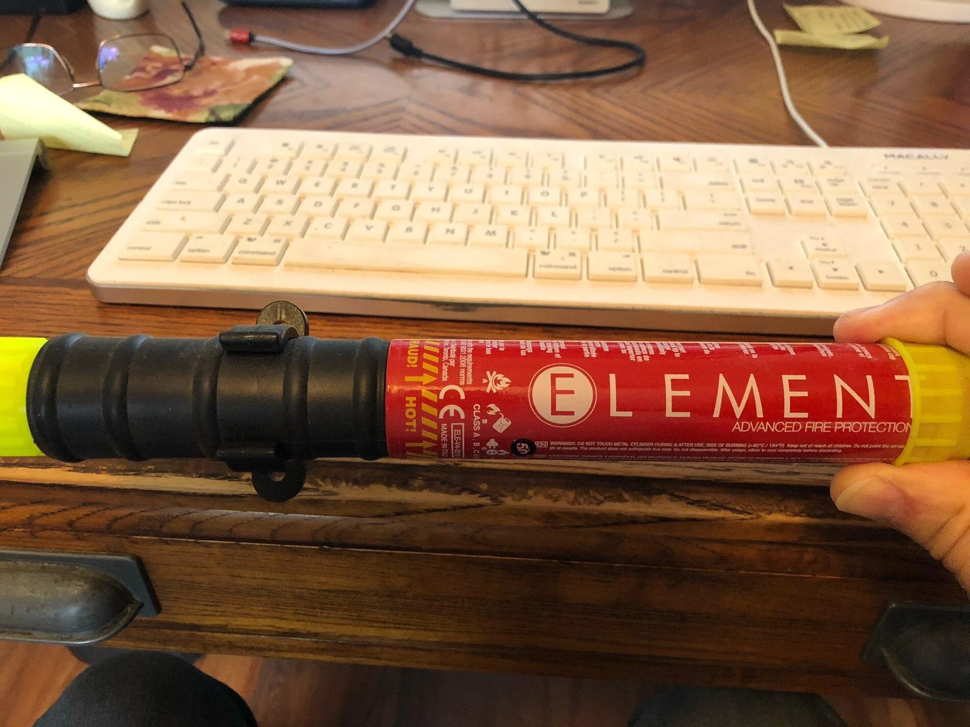

I have 3 of them, two in my Motorhome, one in front and one in the rear bedroom. The third was a spare but will end up in my Bronco. I haven't had to use one but did see a demo, my son is a CalFire Capt and tested them, they work awesome! like a road flare, once ignited will burn for 50/100 seconds (depending on which one you have) and put out a ton of retardant, but leave no residue. As a side note, this is the same tech used on the ISS for fire suppression.

While this product has it's uses I'm sure, it's not a catch all, very few are. You'll need to check if it's even law or insurance approved in applications where extinguishers are required, i.e. RVs and some boats. My main complaints, weird striker cap ignition, closeness needed for use (no range), doesn't shut off.
Might be better off with an aerosol kitchen type like the First Alert Tundra two pack, 3 year for $15 or the Kidde dry chem two pack, 6 year for $39.
I keep 2 Kidde in my motor home and a Tundra in my glove box, if I need more I'm out the door.
One size does not fit all.
This is an ABCK CE & TUV rated extinguisher and will work on Combustibles, flammable liquids, electrical, and grease fires. That covers most any fire you are apt to have in a home or vehicle. It does not 'smother' the fire, but fights the fire on the molecular level by chemically interrupting the chain of combustion, and leaves no residue at all. Much better than a bulky, heavy, short lived chemical extinguisher that expires and leaves a mess. Hey, if this tech is good enough to be used on the ISS then I am good with it.

Stick with a 2.5 or 5 pound A,B,C dry chemical extinguisher for a vehicle.
Dry chemical is non toxic and forms a crust over the fuel preventing the fire from coming back. If this product only uses gas, that crust will not exist. I assume this product is simply displacing something in the fire tetrahedron. If that's the case you risk re ignition.
The fire in the video is very mild and the hood it conveniently already up. They put themselves in a best case scenario for sales purposes. Lifting the hood in an engine compartment fire without nomex gear and a breathing apparatus can cause serious injury or even death.
Dry chemical allows you to extinguish a fire from a safe distance. Looks like for this product you have to get right up on it, even put your arm in the engine compartment. :oops: Getting this close to a vehicle fire safely is not realistic.
They just drizzled a bit of gas on the ground and on top of the engine. This is not nearly as violent as an actual vehicle fire. There's a reason why firefighters wear full protective gear for these types of fires.
Dry chemical extinguishers are proven to work. And trust me they do! I don't see the point of gambling.
These kinds of products have a place in the world. But when you're in the boonies and your Bronco's on fire...........give me the best / proven thing you got! ?
Believe it or not I actually watched these videos and read up on the element prior to posting.
Opinion stands, do what you will the next time you are in a sealed enviroment like the ISS.
