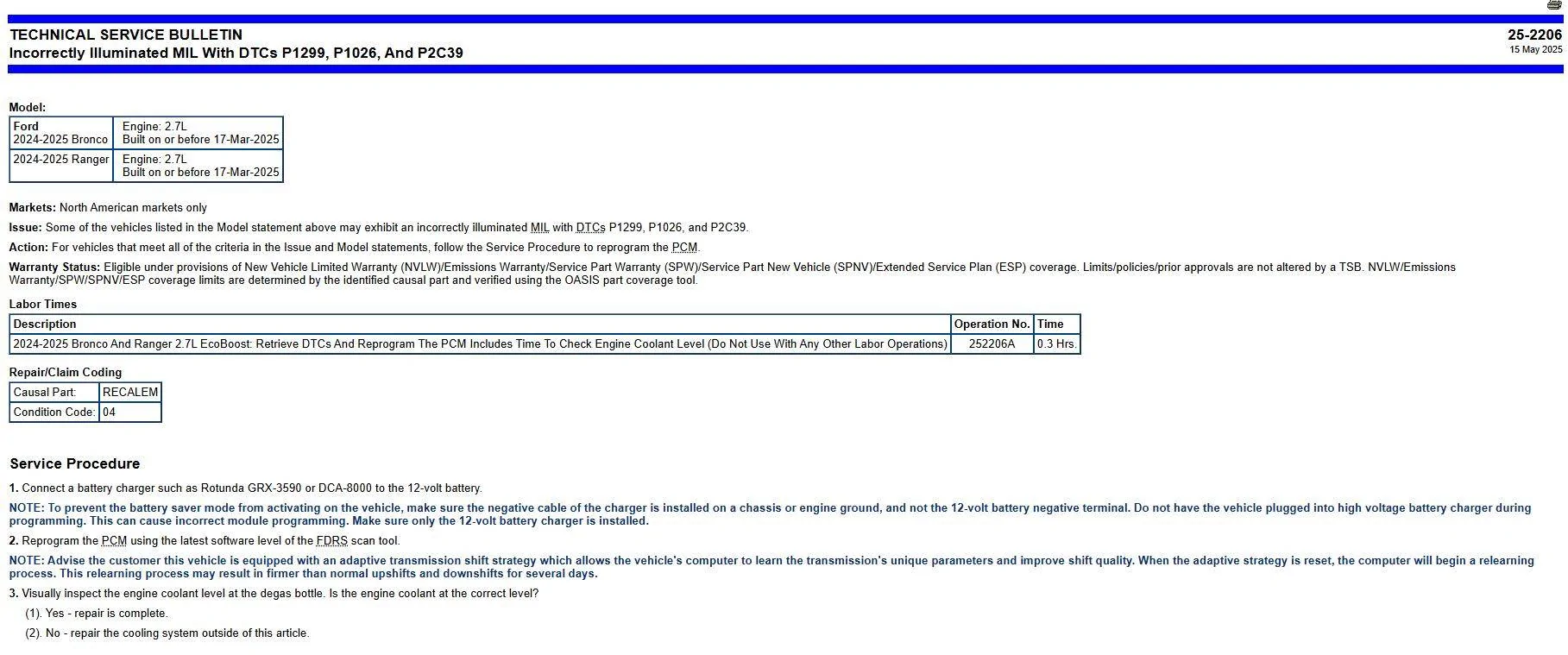

You didnt mention year or engine, but this TSB just released today. Possible this is the issue you had:
Ford Bronco Engine coolant overheating + Powertrain malfunction alerts 1747405869601-g5
