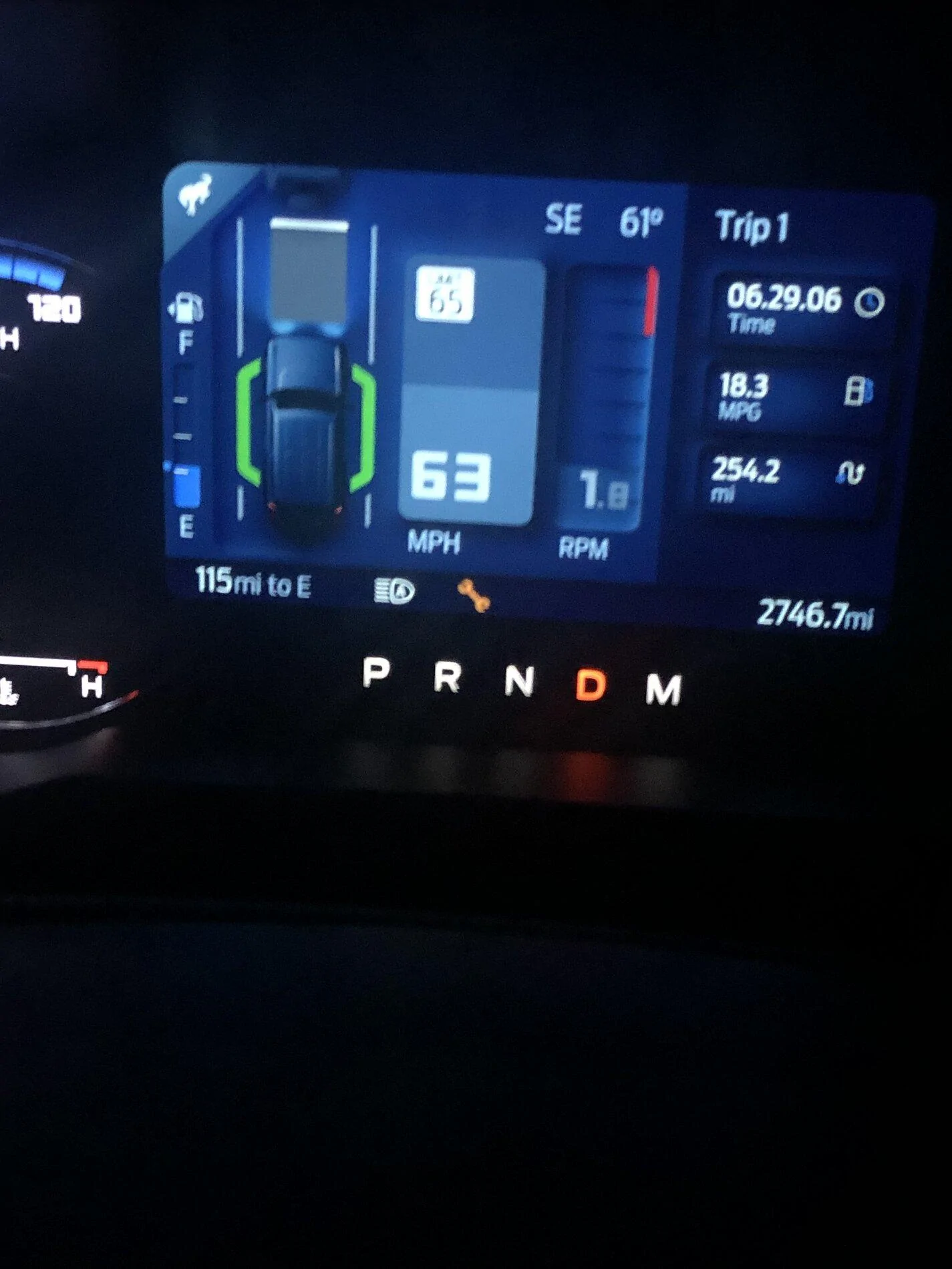

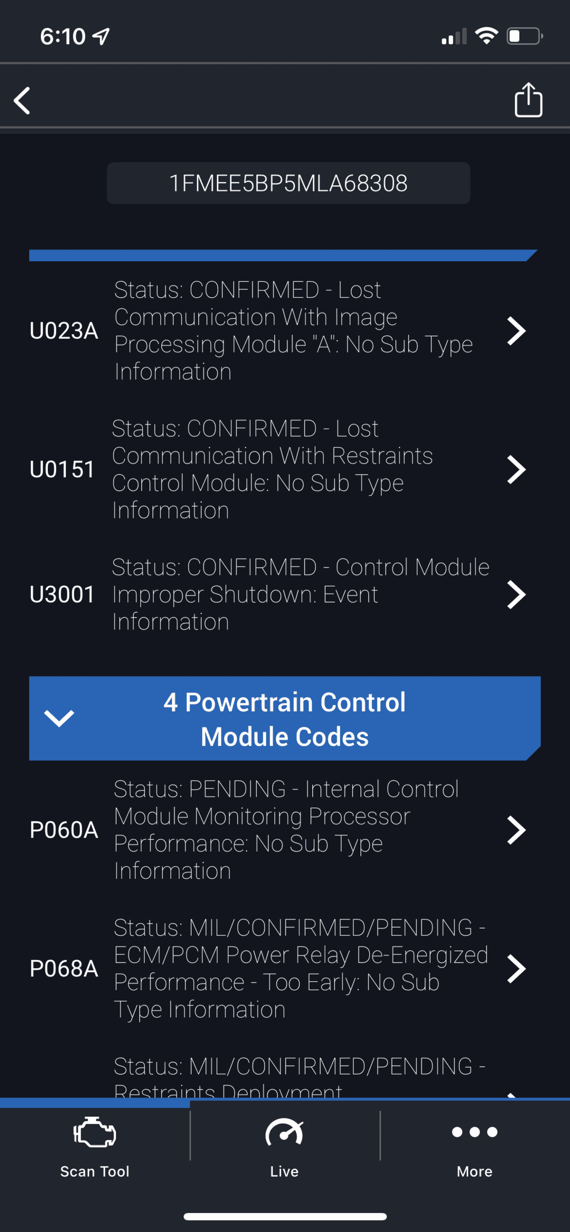

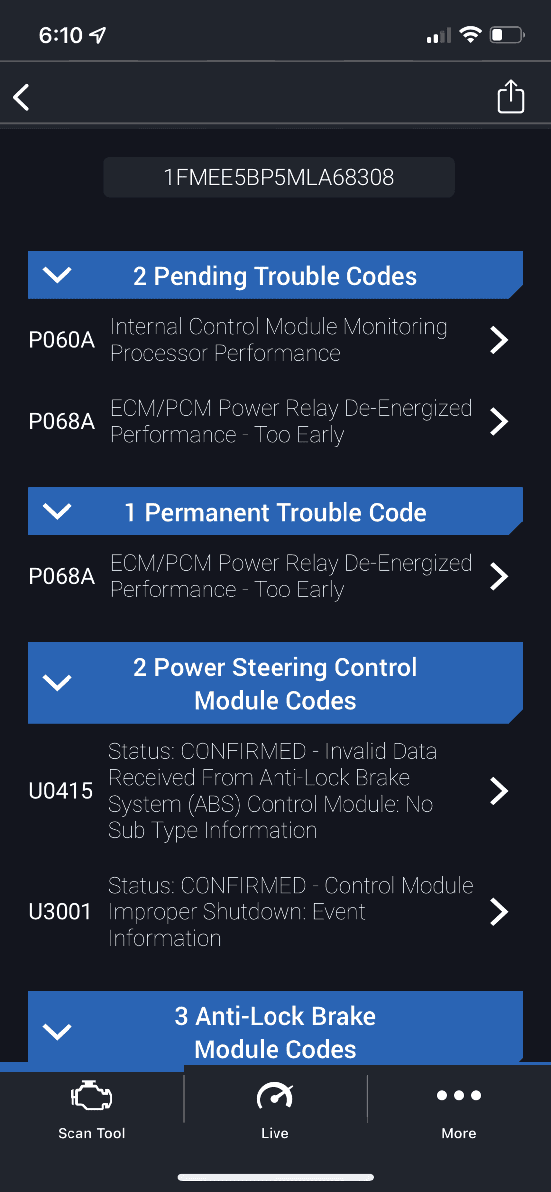

i had this happen Sunday dropped it off Monday, they thought it was a loose connectionon the battery, happened again to my fiancƩe today, dropped it off 10 minutes ago. Will not shut off the engine. I have a video that I cannot upload any help would help lol!
Did a trail cashes valley in Ga that had some water crossings, but took them slow, switched to 4L a few times on the trail then back to 2h the rest of the time.
this is what I got before I took it in.
Joshua
Jan 27, 2021
Cartersville, GA
Ford Bronco Powertrain Malfunction 037276DD-6962-4F6B-9940-B0E652A2E62D

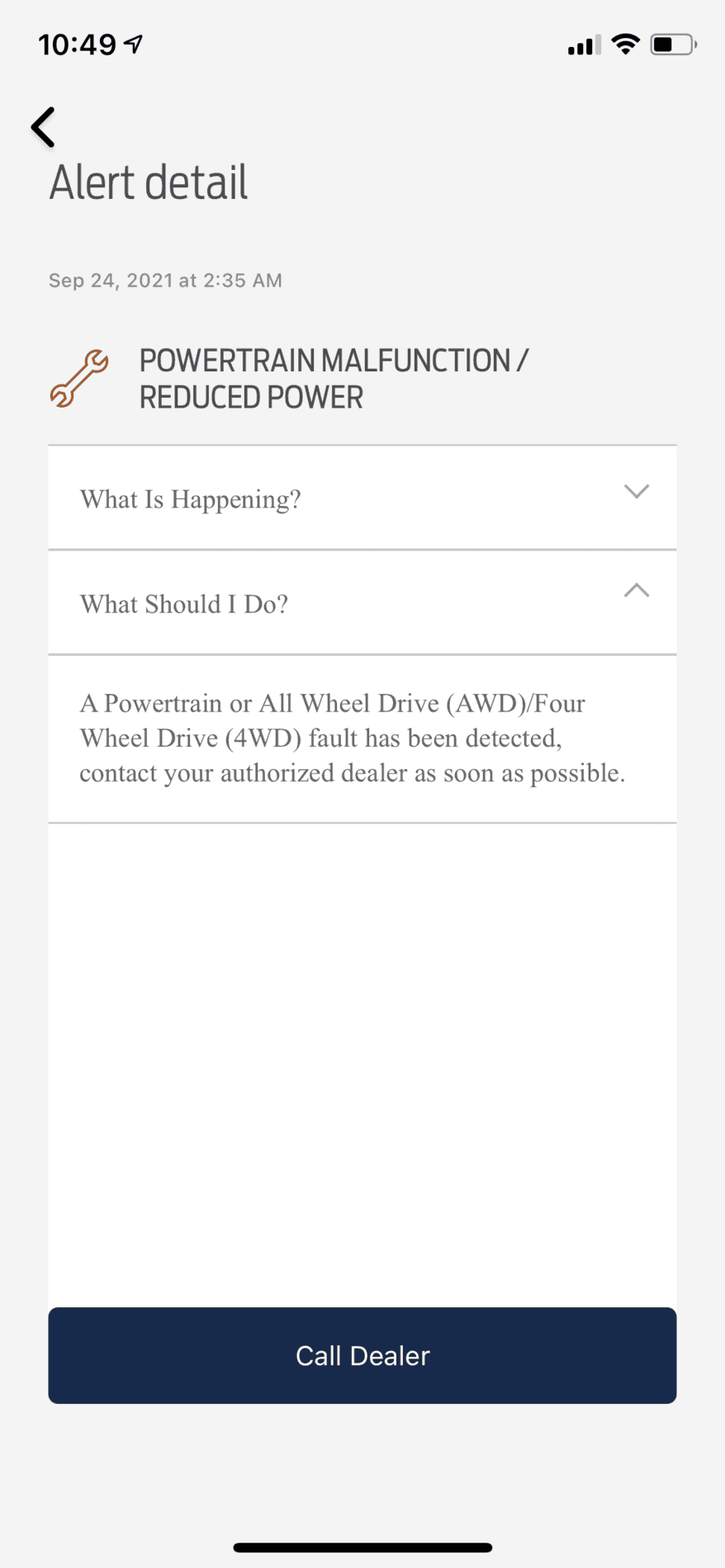

Same error I had. Dealer diagnosed it as the transmission control module and replaced it. Everything has been fine since

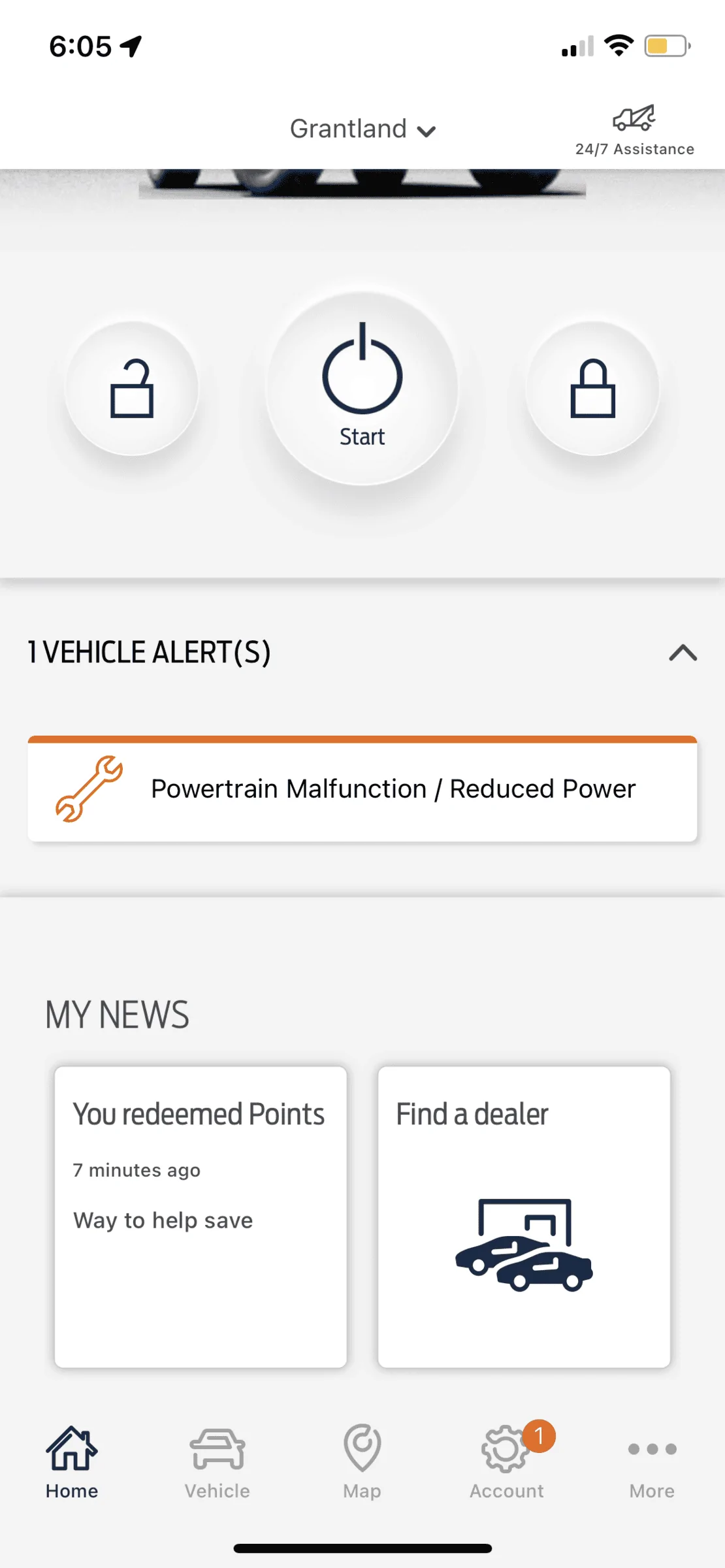

I got the below error for the first time tonight. I typically drive in 2H exclusively. Iā€™ve toggled through all the 4wd ans gost
Modes at a standstill, but Iā€™ve only driven long distances in 2H. Iā€™ve briefly engaged 4A in some slippery situations on unmaintained roads.
This evening, leaving work in a monsoon I shifted into 4A as there was a good amount of standing water on many roads as well as the main highways.
no issues, a nice smooth ride home with lots of puddle splashing. When I hoped in to the car again later tonight I was greeted by an error code for a drivetrain issue. Now just displaying a wrench instead of 2H. I was also unable to shift into ECO mode for my highway drive.
Power and performance seem fine, so Iā€™m hoping the dealership just needs to clear the code(Iā€™d do it myself but donā€™t have a Ford scanner).
Has anyone else experienced this yet?

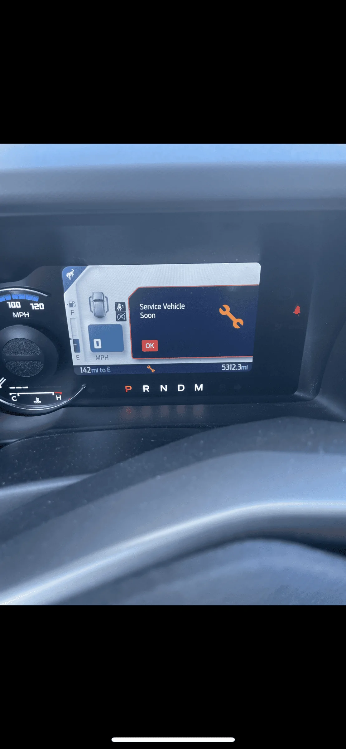

I had these same issues pop up today on my 22 wildtrak 2.7L. Service engine soon, check 4Ɨ4 and power terrain malfunction with almost 3k miles on it. I drove it for a few miles and it was hard to steer and had no get up and go. Was yours fixed and what was the issue?

Yes. Mine was fixed at the time. They had to replace the transmission control module. The issue hasnā€™t popped up again- based on the weather at the time I think mine somehow got water logged.
best I could tell the transfer case was stuck in 4H. Binding during tight maneuvers and able to spin all 4 wheels on gravel. Dealer swore it was ok to drive(and I put a lot of miles on daily)

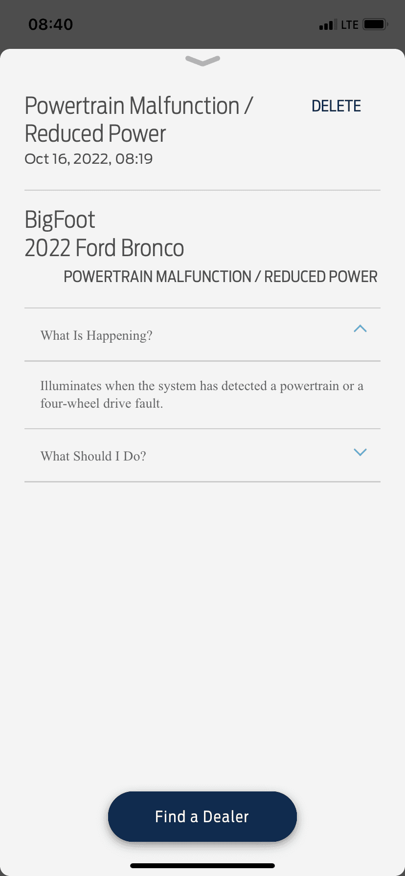

Yā€™all are lucky I already replaced one turbo at 29 miles and now this at 107 milesā€¦.
Ford Bronco Powertrain Malfunction FC26316A-0DD9-4D89-838A-47710204A27C
