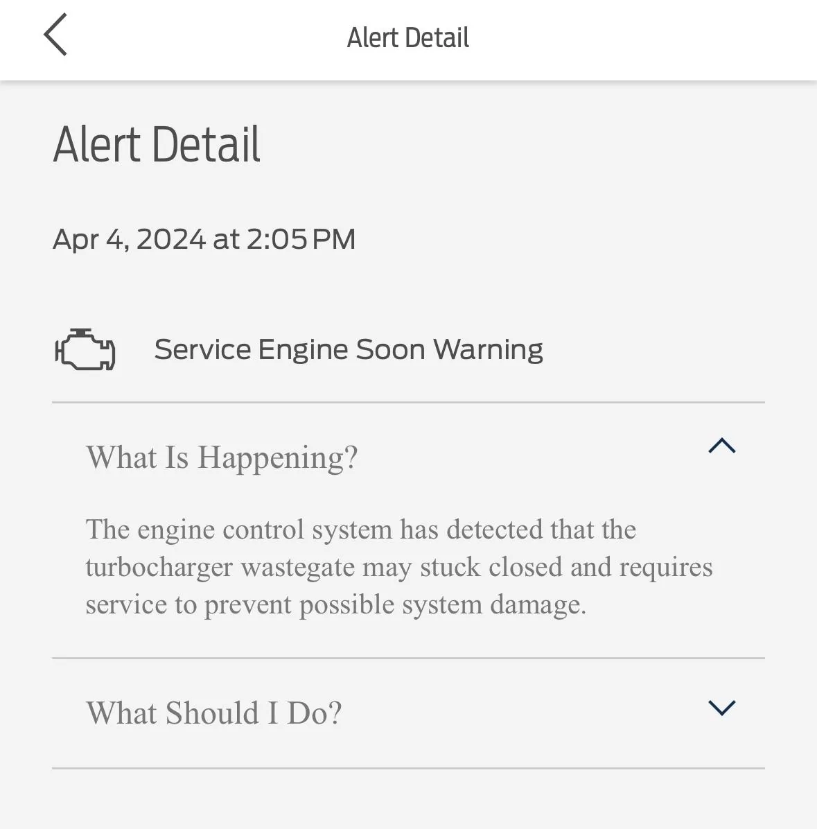

I also have the same issue. Driving last week when the service light came on. Took it back to the dealership the next day. The dealership said it was the Wastegate and they told me there was no ETA on the part. Hard to believe a vehicle with 6,000 miles could have such a significant issue and literally no eta on the part to fix it.

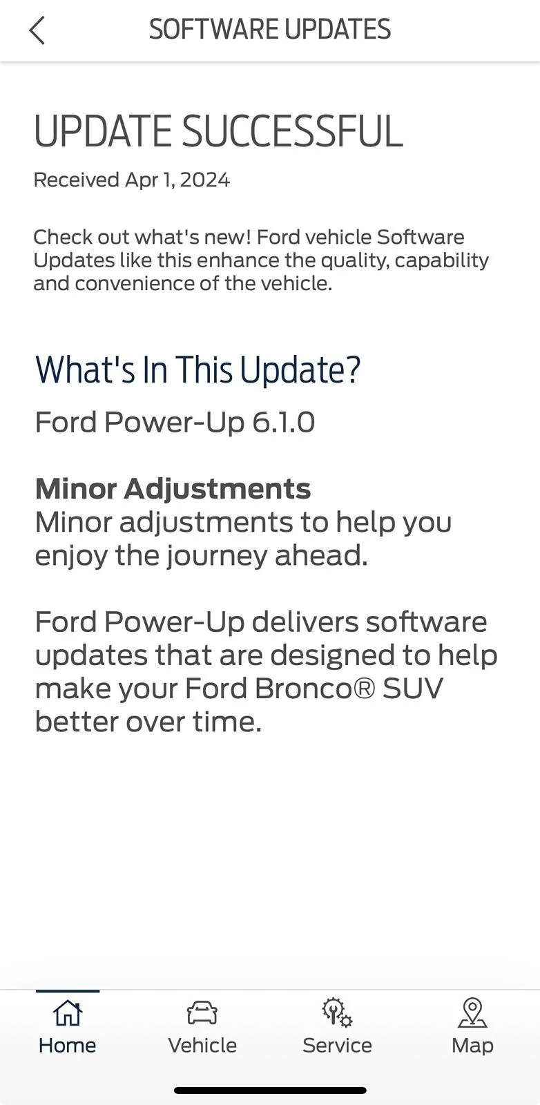

Also, I just recalled seeing a update on 4/1/24. I wonder if this un-did the previous fix???
"Minor adjustments to help you enjoy the journey ahead."
Ford Bronco Powertrain Malfunction / Reduced Power 4-1-24

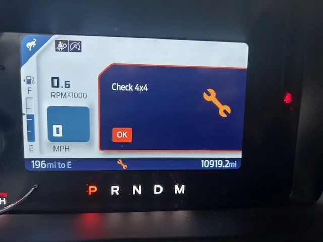

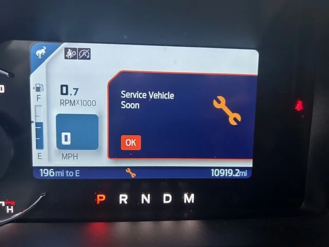

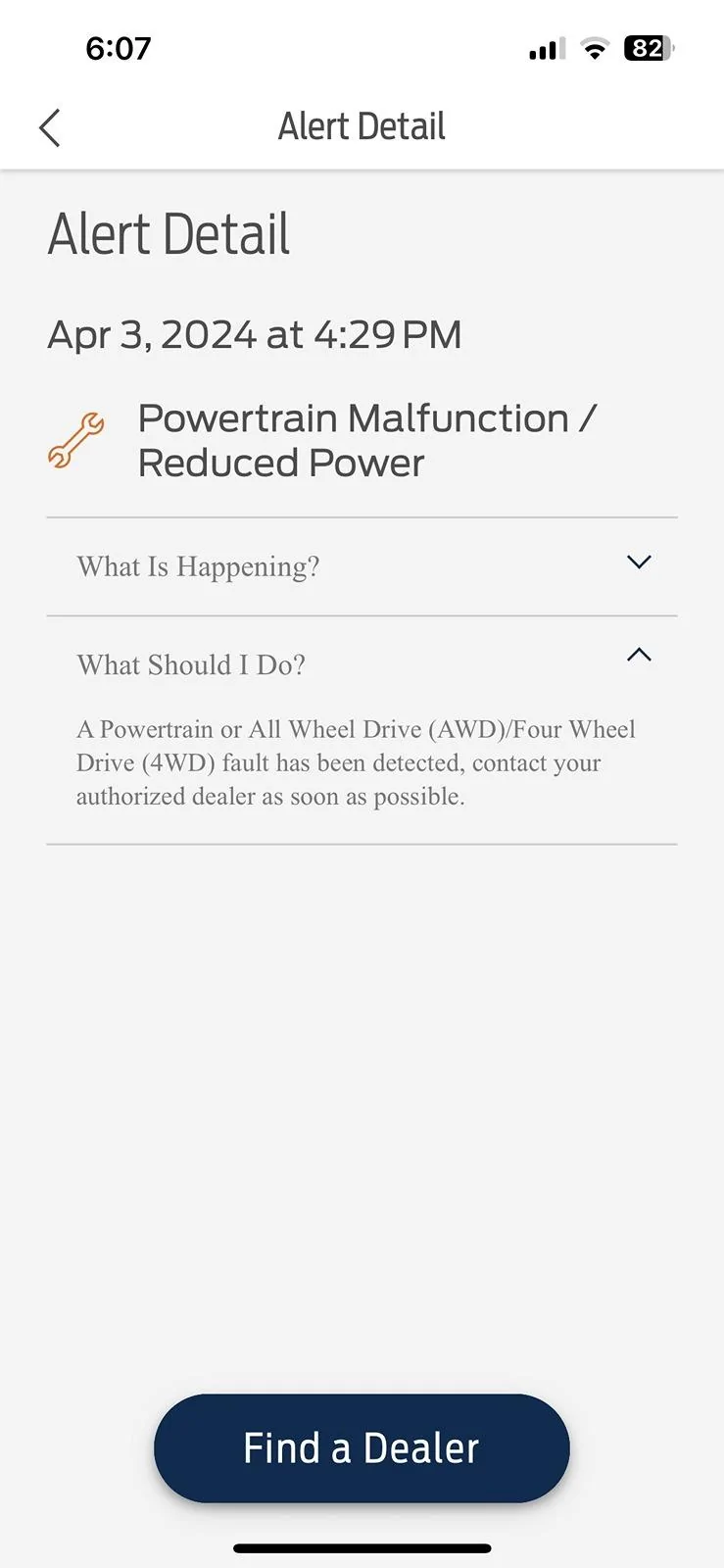

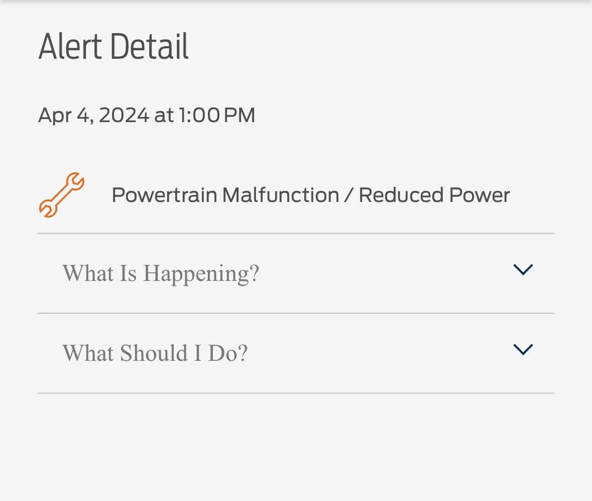

This also just popped up on our Bronco.
First the power malfunction, we parked it turned it off. An hour later came back to check it again and the second error popped up.
Interesting how these started popping up more frequently these past couple of days.
Ford Bronco Powertrain Malfunction / Reduced Power IMG_2648
Ford Bronco Powertrain Malfunction / Reduced Power IMG_2646
