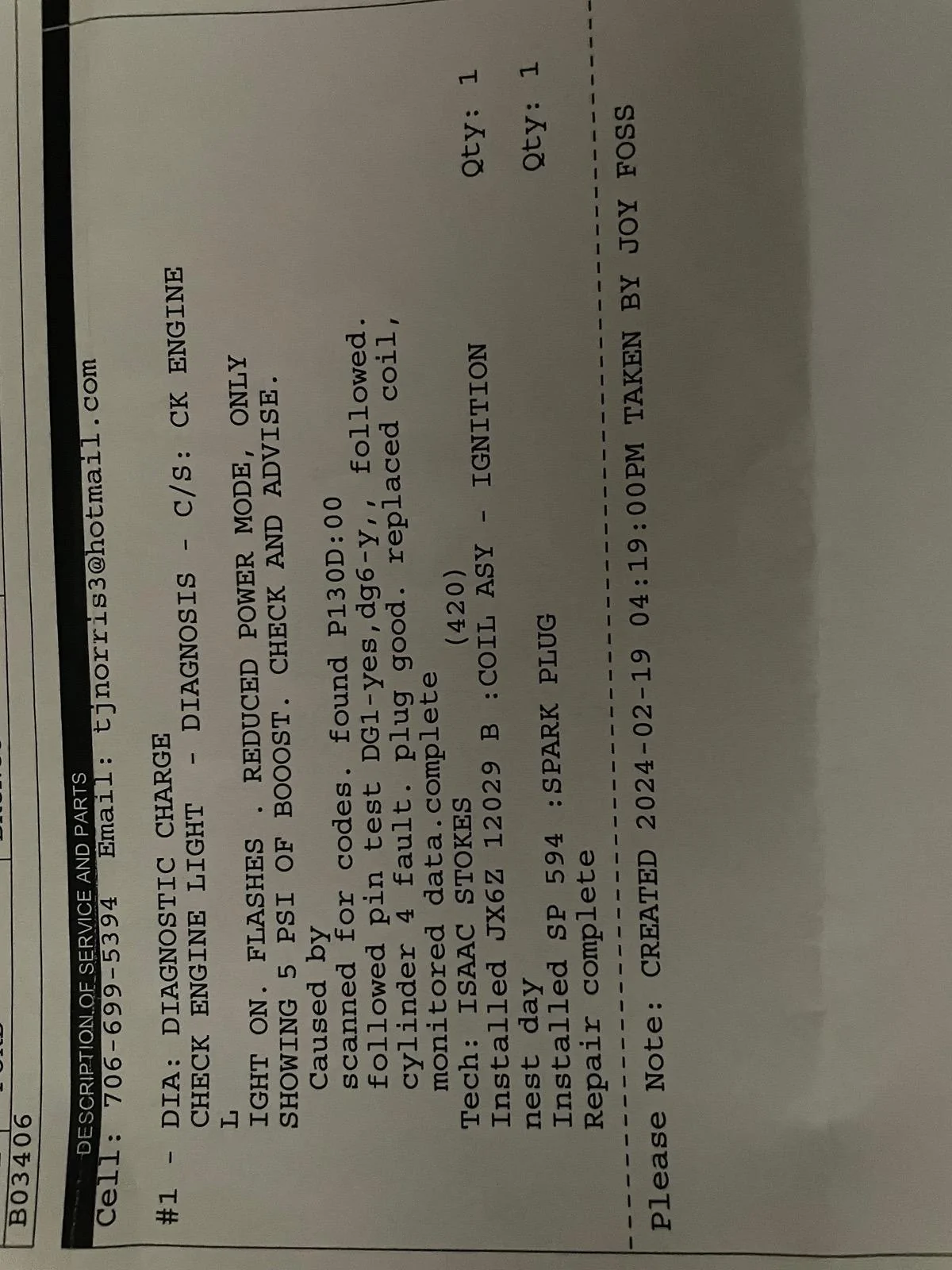

Cherry Bomb. I have a 2022 and from almost new it would intermittently have a hesitation, light would come on, and my turbo would be reduced to 5 psi or less. Usually happened at 70mph or more when the motor became strained going up a hill. Especially did it when pulling my light tear drop camper at speed. Could pull over, restart, and it would be normal, but would usually occur again if same parameters met. Took to dealership multiple times, even with the camper, and they would think fixed and would reoccur. Finally appears it is fixed as I took the camper to the mountains in Tennessee recently and had no issues. Have attached the dealer work sheet showing codes and what they replaced. Good luck.
