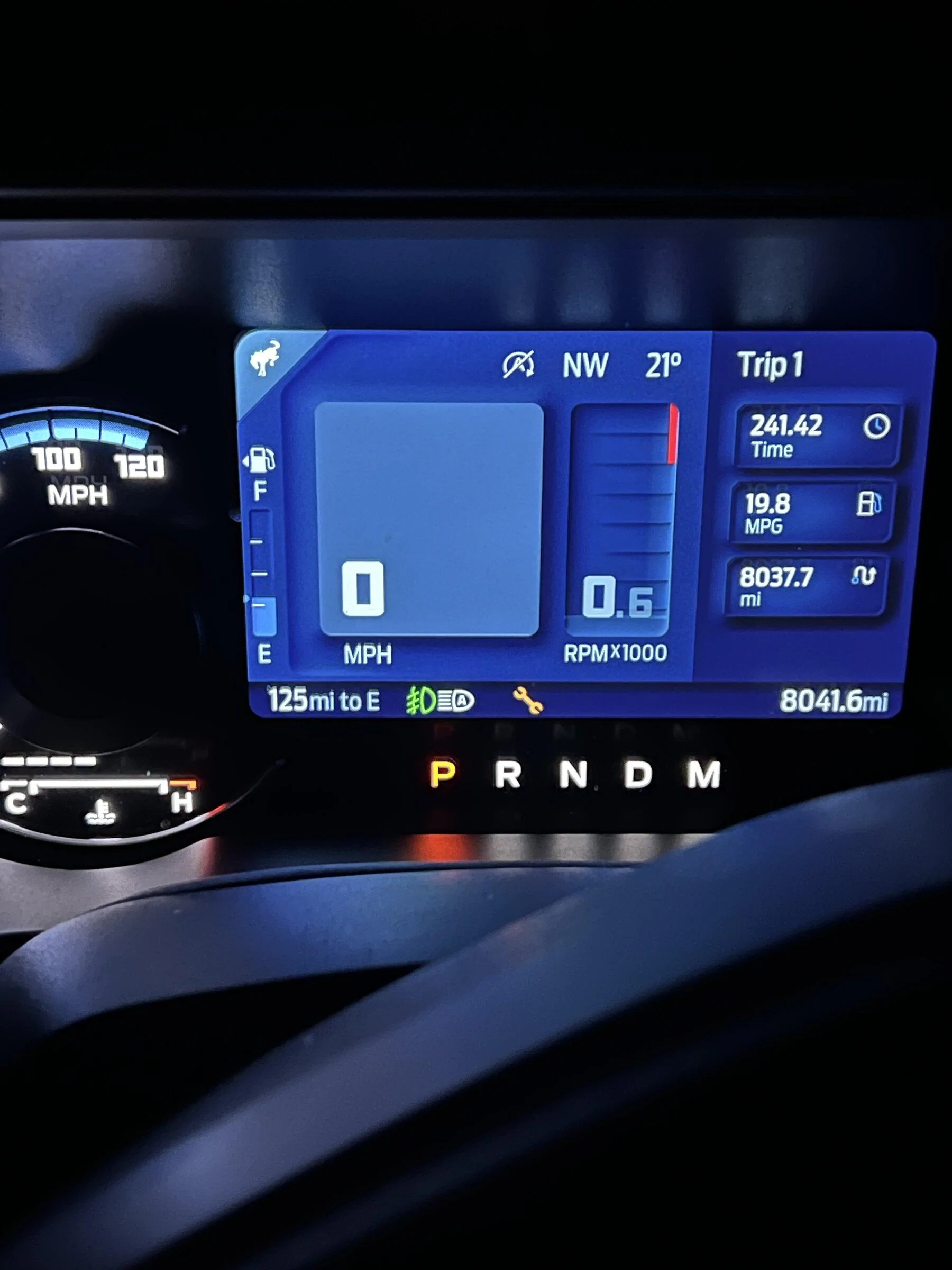

On my way into work this morning and all of a sudden thud, low power and shifting was weird. Had the car running 10 minutes before I leave every morning to warm up because of how cold it’s been. Got into work and won’t go into reverse. Any other people have this issue?? Have the 2.7
My wife just had the same think happen this morning on our new Bronco sport Big Bend with only 3k miles on it.

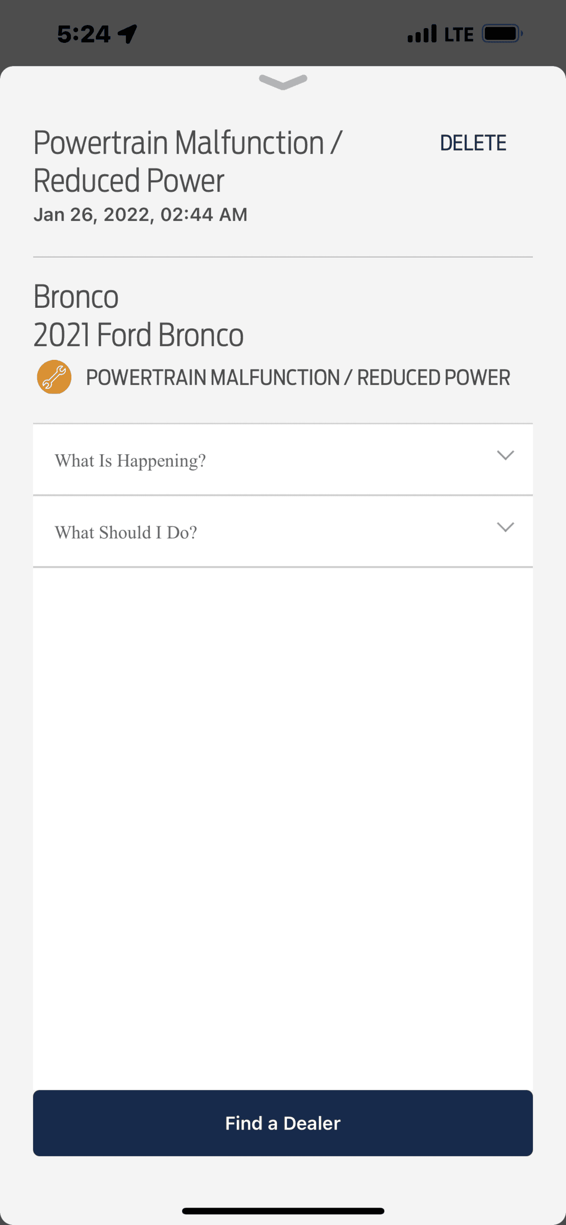

I just got my Black Diamond Bronco yesterday (2022 first batch, 2.3 , automatic transmission). The powertrain warning light came on during my drive home at 60.6 miles on the odometer. The vehicle did not behave differently, no lurching, noise or anything. I take it back to the dealer next week for service. Thank you for all the above posts as they are very helpful.
