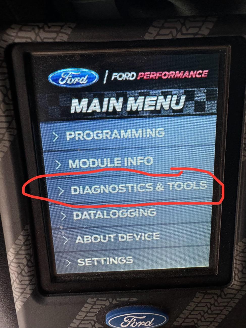

Step 1:
Ford Bronco Error codes after Ford 2.7 tune install [UPDATE: needed the AWD system relearned] IMG_6296

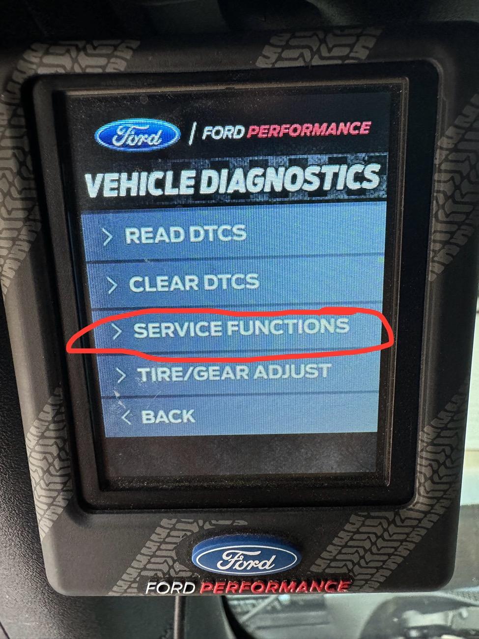

Step 2:
Ford Bronco Error codes after Ford 2.7 tune install [UPDATE: needed the AWD system relearned] IMG_6297

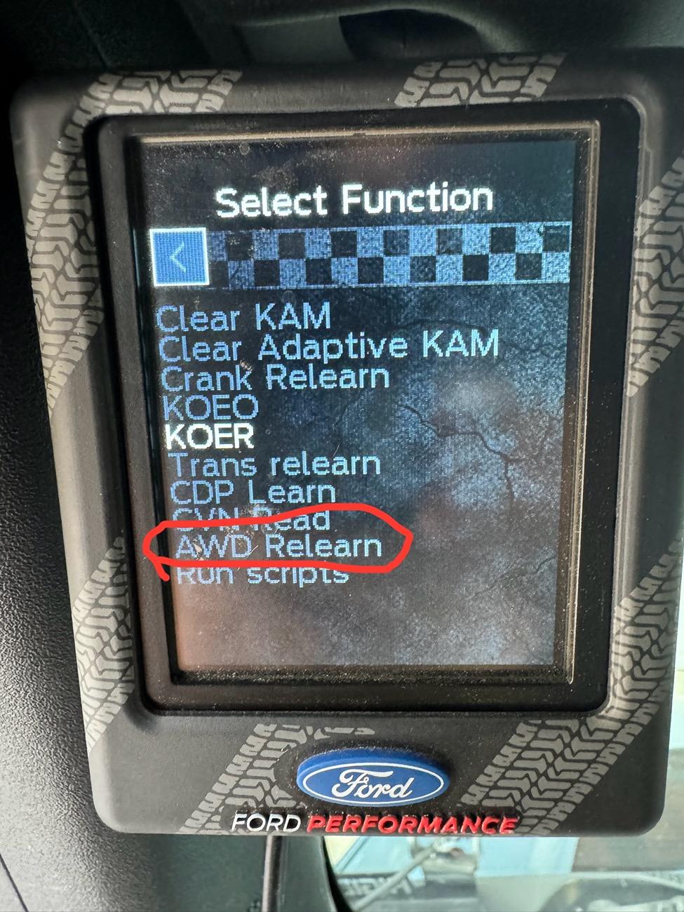

Step 3:
Ford Bronco Error codes after Ford 2.7 tune install [UPDATE: needed the AWD system relearned] IMG_6298
Step 4: Follow instructions on the screen and it will be done.

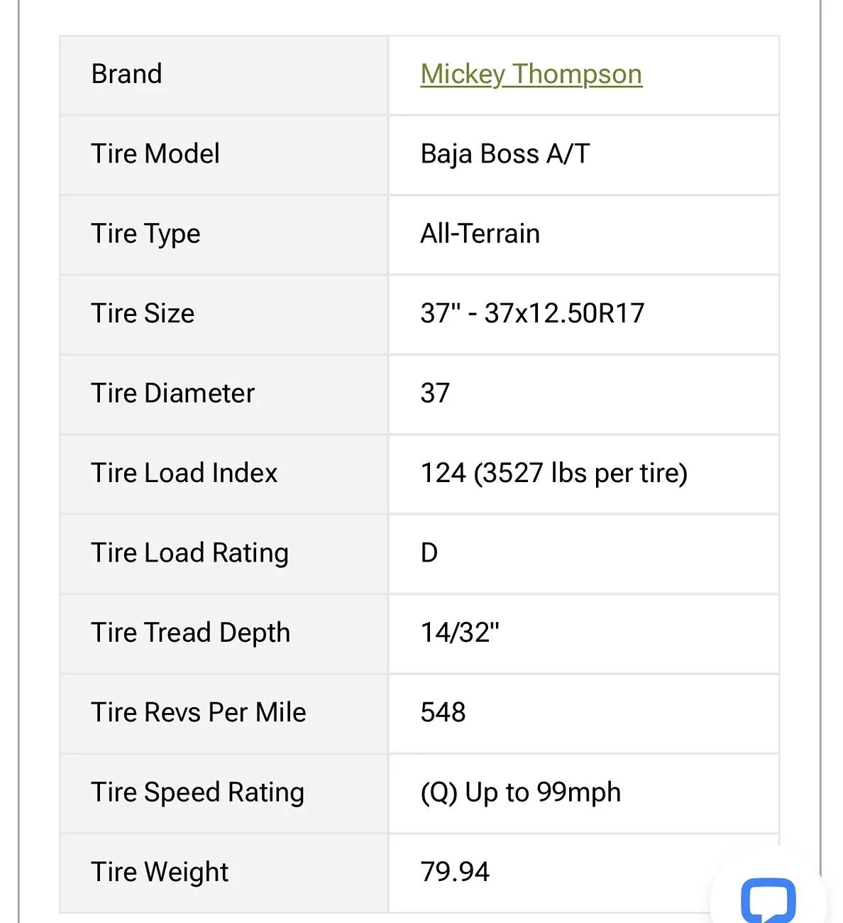

I installed the Procal tuner and tune but getting error codes as well. Thanks to this forum and thread I was able to clear the service wrench lights with the AWD relearn but I’m still getting a U0422 code and my stability control says it needs to be serviced.
Also after driving about 50 miles yesterday, I noticed the CC doesn’t work and my Speedo is Way Off. I adjusted to the 548 revs per mile for my 37’s but at 70mph on Speedo I’m closer to 80mph on GPS.
Any advice or tips?

You can't set the Revs/mile any less than 579 or you get this.
548 sounds like it would be for 40's ... my 38's measured true at 562 via GPS, but I run at 579 (slighly under sized - I'm about 1.5 MPH off at 70 MPH) so I can keep cruise control. Most people are running 580-590 for 37's.
(note: revs/mile works backwards - a lower number for a larger tire)

Ok, I will Put in a higher value and see what happens. FWIW I got the revolutions info from the internet so I thought it was true haha
