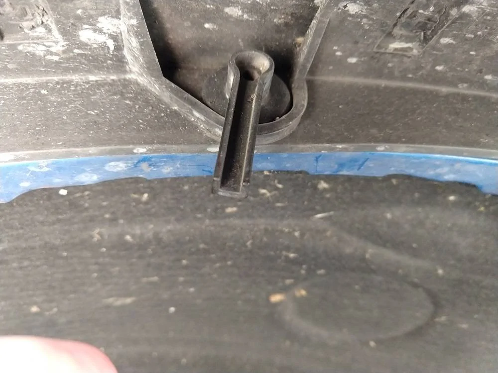

I'm unable to remove the flares from my 2023 non-Sas Bronco. I moved the levers as shown in the photo below, but the flares remain fixed to the fender. I pulled as hard as I feel comfortable doing, given the metal fender was distorting and not wanting to let go of the flare.
Something doesn't add up, because the YouTube videos I watched made pulling off the flares seem easy. But they are not letting go for me. Any advice?
I just did this for mud flaps. A couple days ago I did the driver's side, and today the passenger side. On my non-Sas OBX I rotated the levers 180 degrees. I first tried just the center position like you but it wouldn't budge, and I didn't try very hard before I went all the way the opposite direction.
And the first time they come off, it's a solid tug and a huge cracking sounds. Once you've broken your cherry on that, they come off easier.

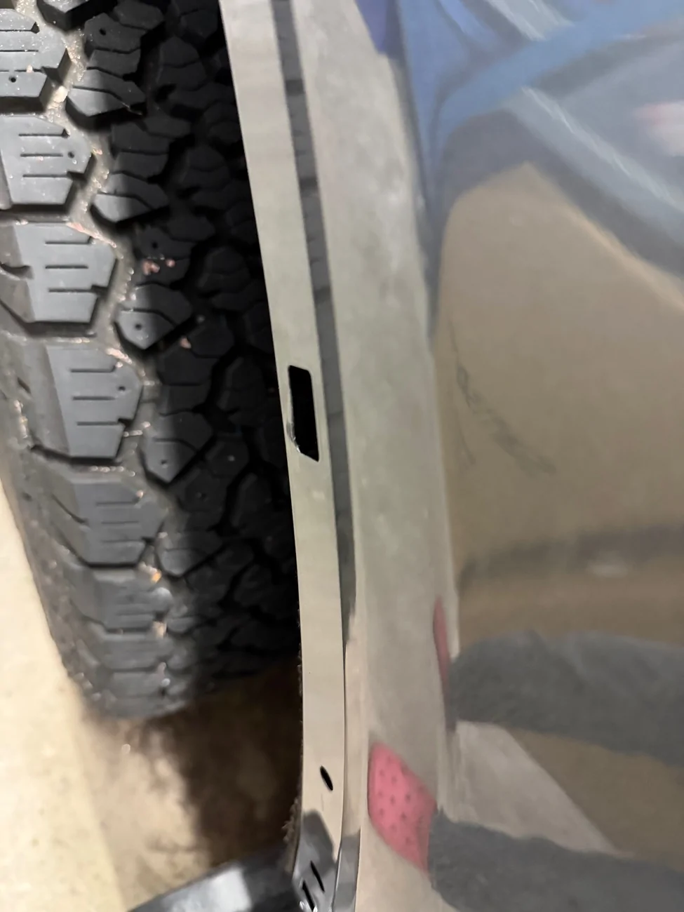

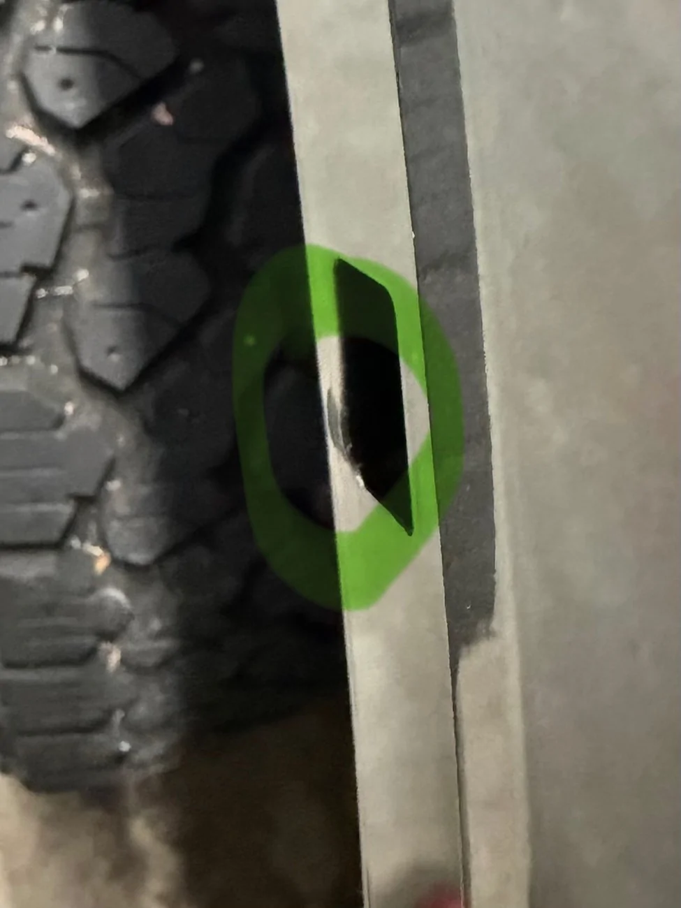

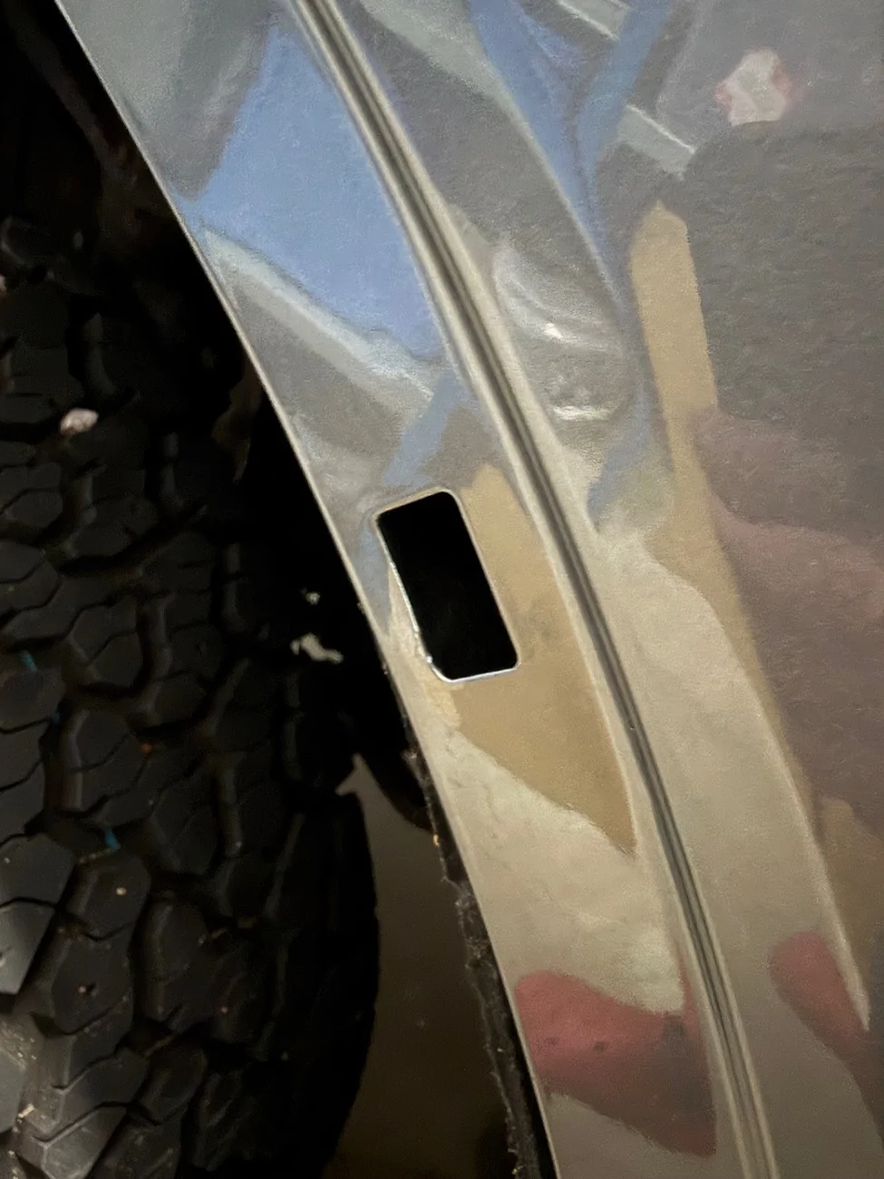

Hi,
I removed my front fender flares yesterday to install uag mudflap and it was a disaster.
i watched a few videos on how to r3move the fender… and did the same but one lever wasn’t enough released.. I pull the body around the fixation and chip the paint. I am wondering how to get it fixed. inattached some pictures.
if I r3install the fender it make a gap.
also the IAG fixing plates that they provide for the front where so weak that they collapsed at 7 nw, they were saying to us3 10nw. It unlarged the pin hole and also chip the paint….
I one really concerned about the salt (live in the salt belt) any advis3 how to fix it are welcome
thanks

I was thinking of using a clamp with two pieces of Teflon and some cardboard placed between the body panel and the Teflon. This would allow a slow and even pressure to bring the metal back to its original shape.
Afterwards, I planned to touch up the paint using touch-up pens and possibly apply a small amount of brown grease to help prevent corrosion. What do you think?
I should probably do the same at the second location where the iag front Mudflap support supports were supposed to be installed.
I’ll post a photo later showing how the threaded rods deformed and enlarged the mounting holes in the body bracket.
