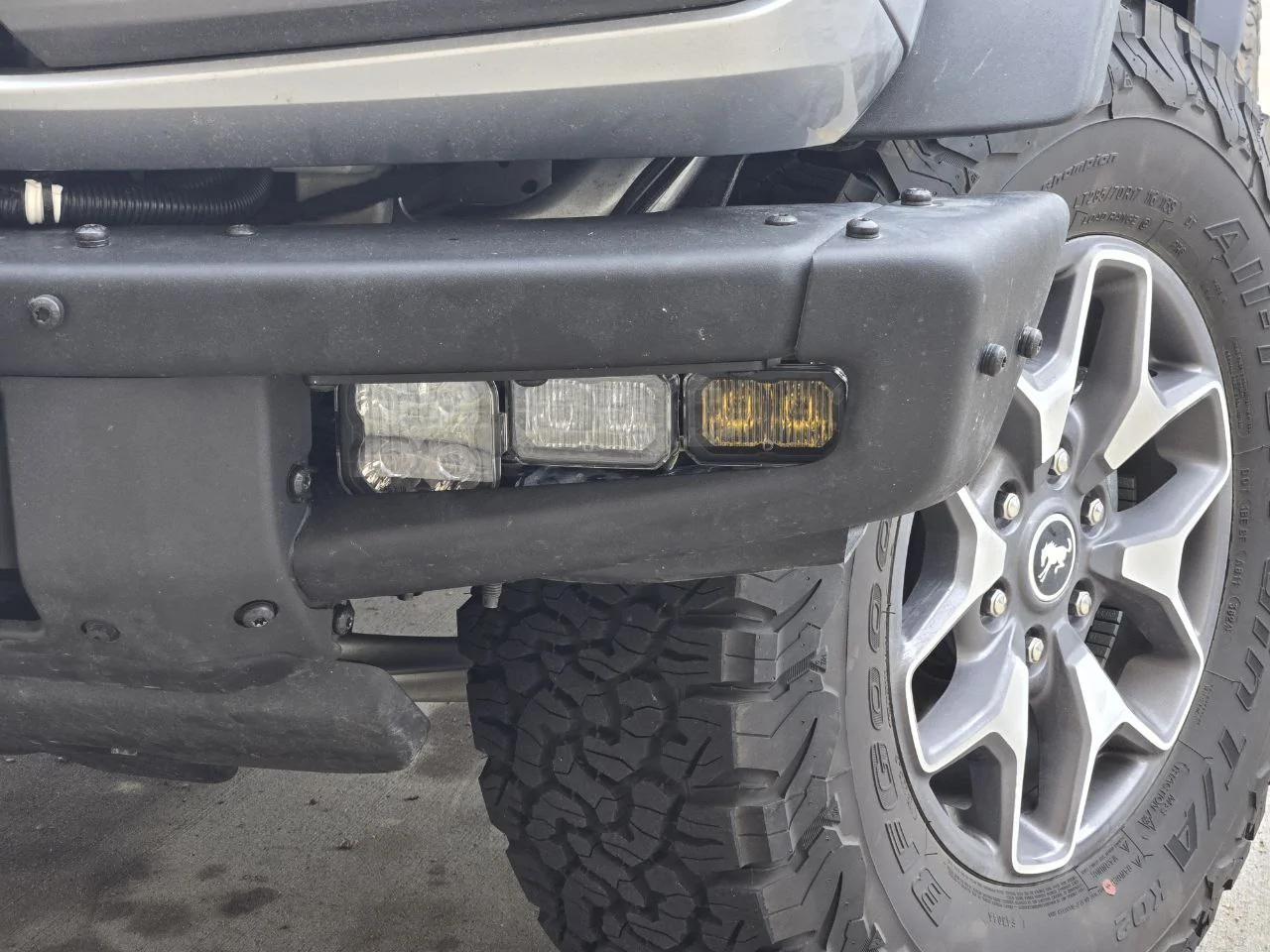

I have one pair each white Pro Drive SS3/white Pro Fog SSC2/yellow Sport Fog SSC2.
The drives are incredible for lonely backroads to augment the highbeams, the more powerful white fogs offer great close-range fill, and the yellow fogs work very well in actual fog - I'm a big believer in selective yellow for inclement weather in general.
The Drives, as a highbeam augment, are not made to show to other drivers - they will definitely NOT appreciate it. The white Pro fogs are a bit harsh to look at from the front and I'll get flashed occasionally for them; the aim is good, they're just intense. The yellow Sports never seem to anger anyone.

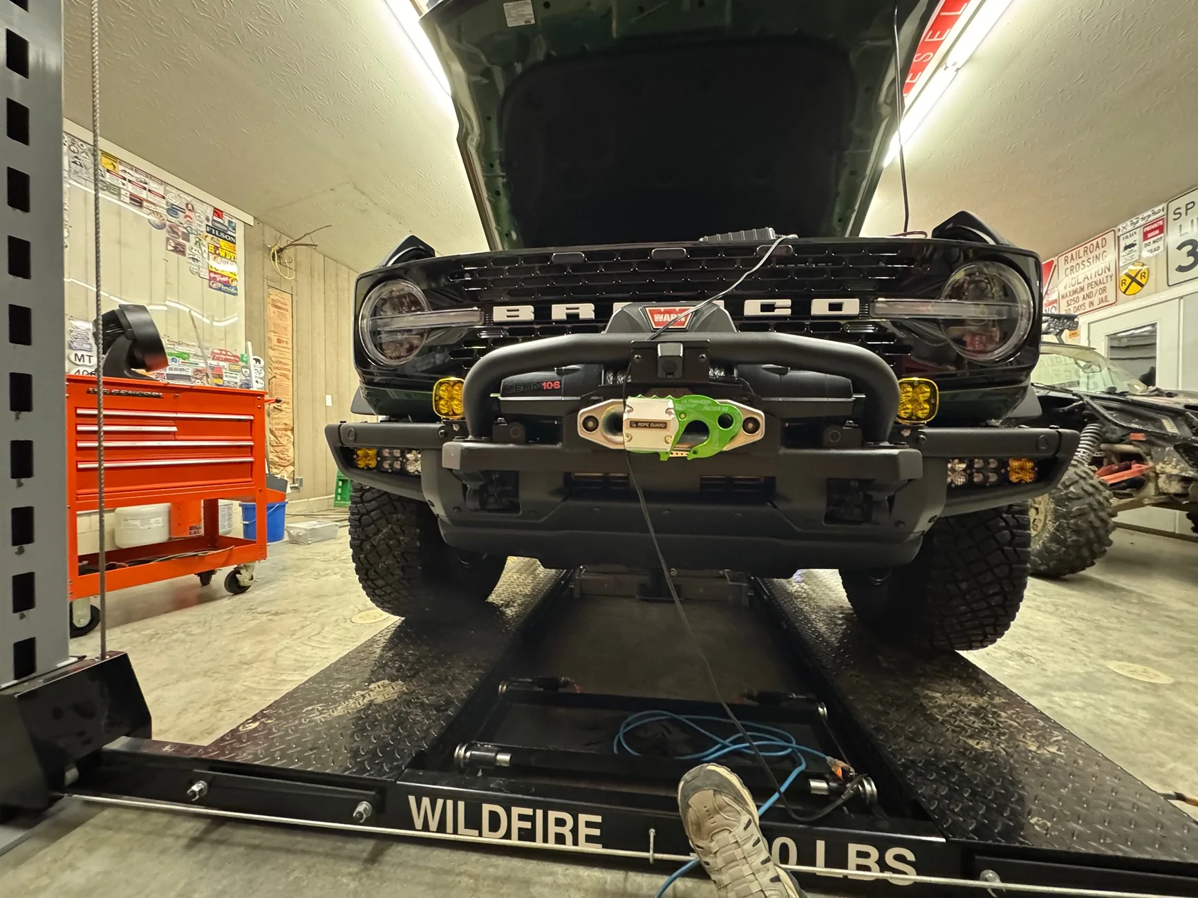

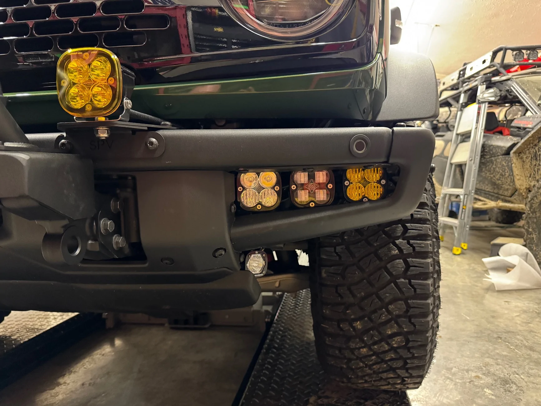

BD cases are slightly smaller allowing 3 to fit in the bumper. SAE in the middle controlled by factory fog switch everything else is upfitter.

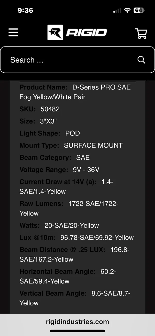

… I am waiting for BF sales but think Rigid D-Series PRO SAE Fog Yellow/White Pair is tops
Yellow or White combo switch ability
Both are SAE @ 1722 lumens
But can turn both on together for 3444 lumens off road …
