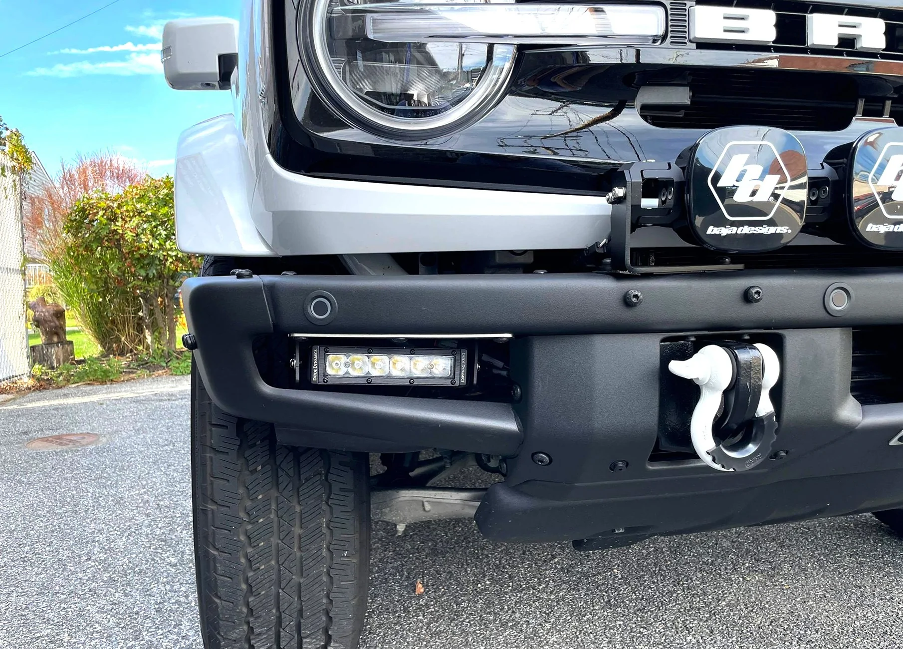

It's an easy to install kit. Here are some photos from our demo truck (before we powder coated them, they are now black powder coated brackets)

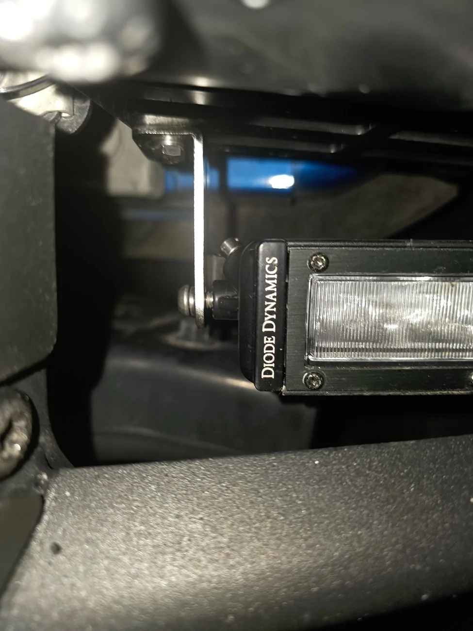

Just got them install and loving the level of light I get out of them! Though im a little lost on getting them aligned. I have them aimed on the bracket as low as it can go yet they seem to be high as I can see if shining through windshields when they pass me there is a nob that spins but doesnt seem to do anything? Picture below any suggestions

Just pivot them down then. Also, your not tightened up all the way as I can see still see the threads on the bolt.
Just turn your headlights on and then pivot the light so it's shining below your headlights on the ground as it's acting as a "fog light" Then tighten the bolt when you get it where you want.
I'd recommend tighten it enough so that you can still pivot the light down without it losing where it's aiming then tighten it the rest of the way down.

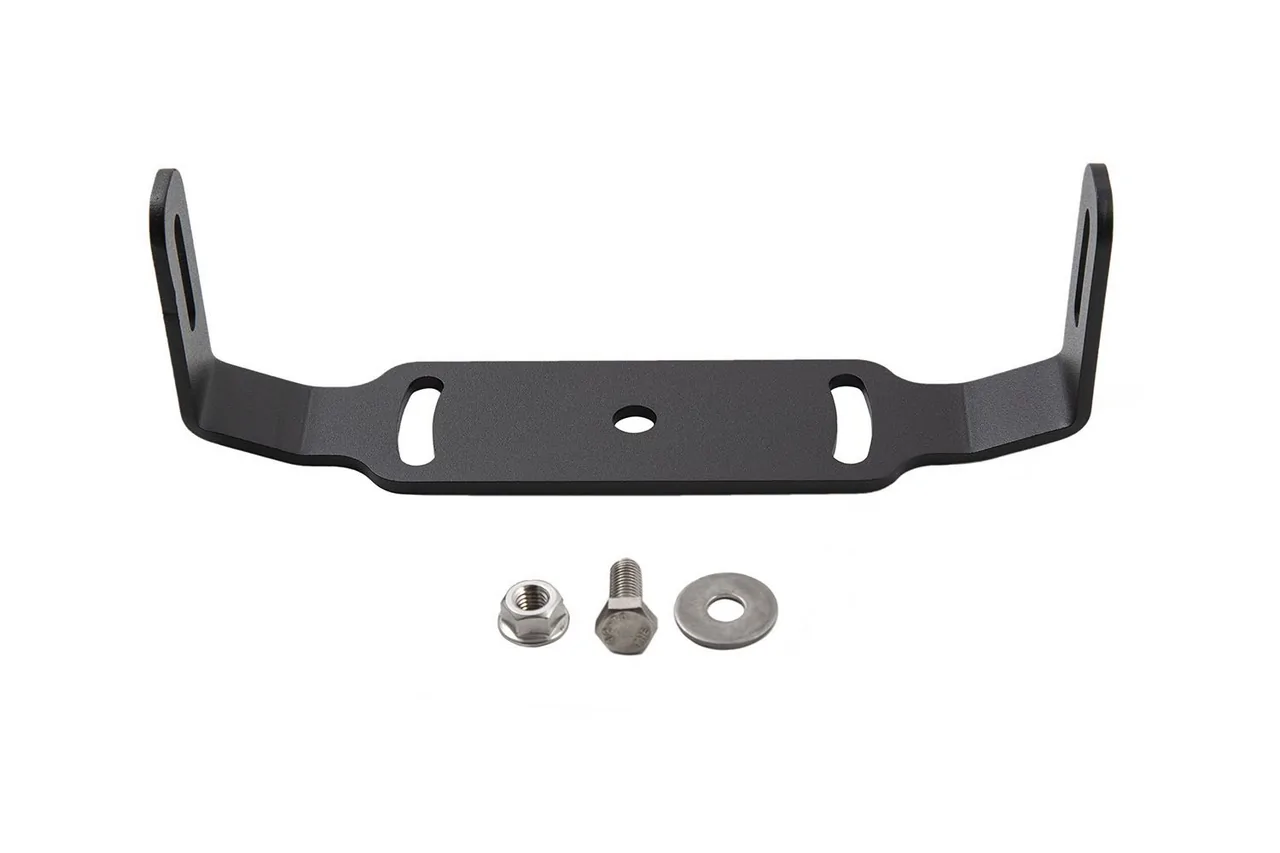

Also, your not using the right brackets... your not supposed to use that tiny L bracket. If you bought a fog kit from us then we included a larger U Bracket which holds the light... those smaller L brackets are not used with our fog kits

Awsome thanks for the help
