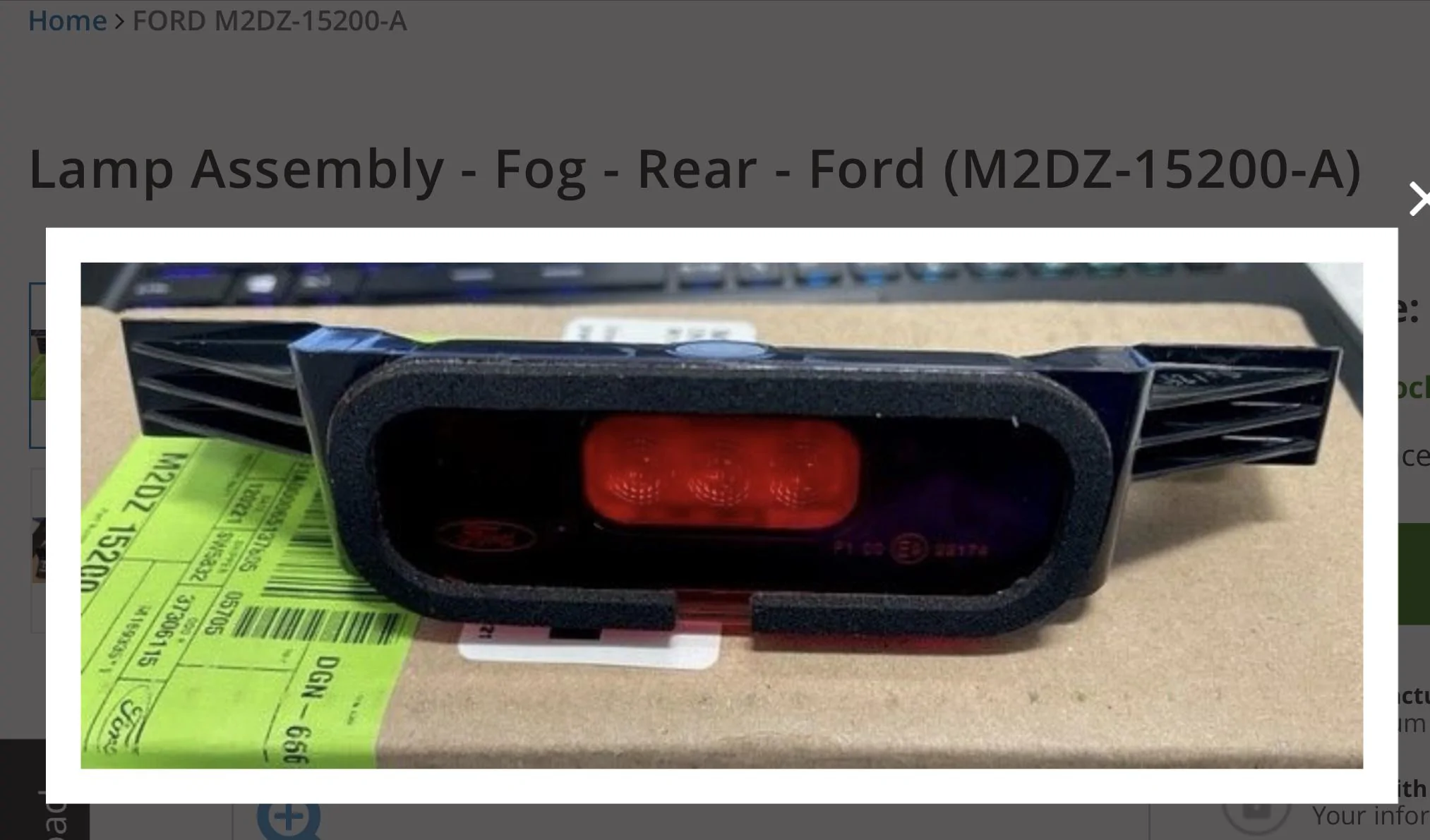

I do not know the answer to either Q, but the factory rear fog light has a red cover.
Ford Bronco Installing Rear Fog/Chase Light Using Factory Switch & Harness 4769C53E-DDD0-49D2-8020-609D5EB3CC48

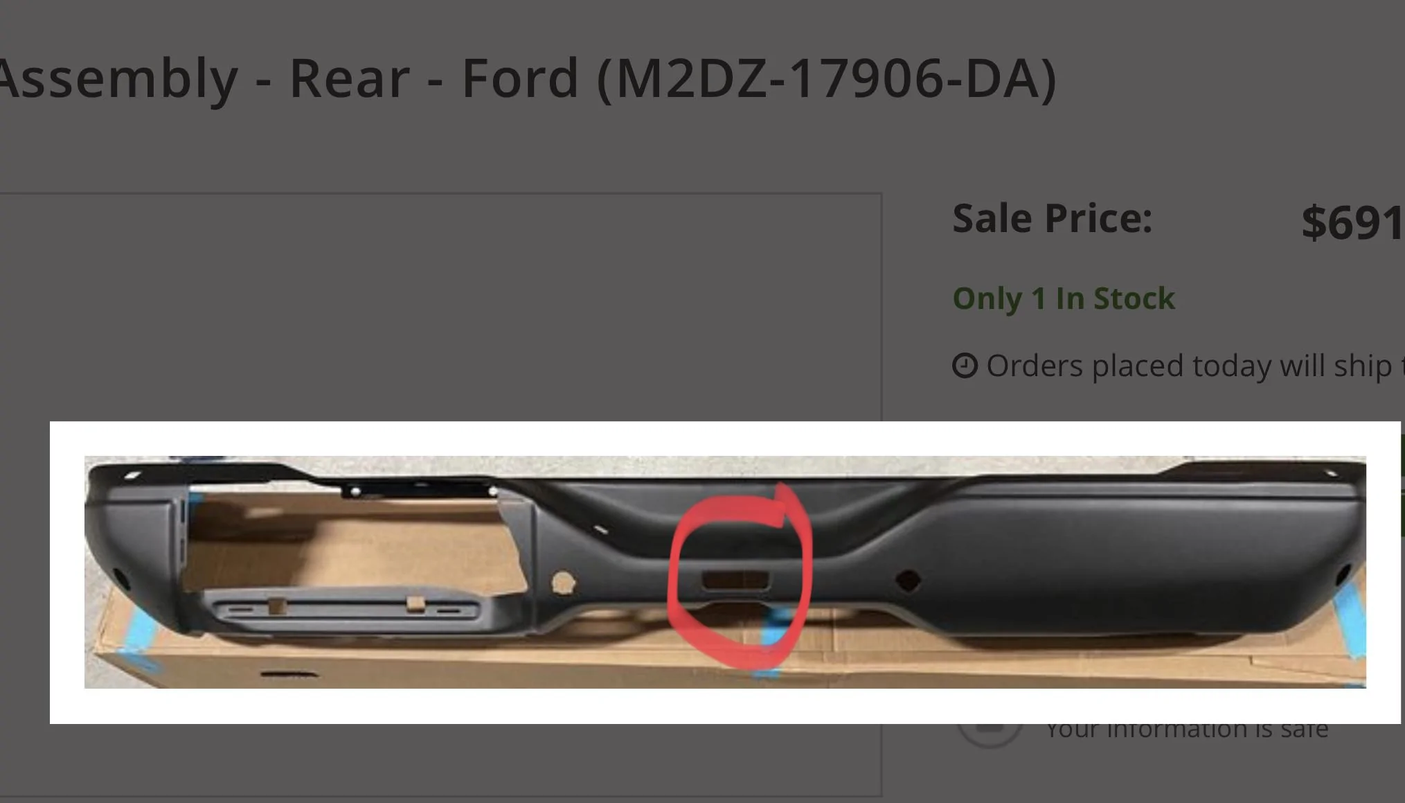

Here’s a pic of the “other” bumper where the factory rear fog light fits.
Ford Bronco Installing Rear Fog/Chase Light Using Factory Switch & Harness 5AAC9942-60CC-4421-88D3-AA0AF1E3A752
