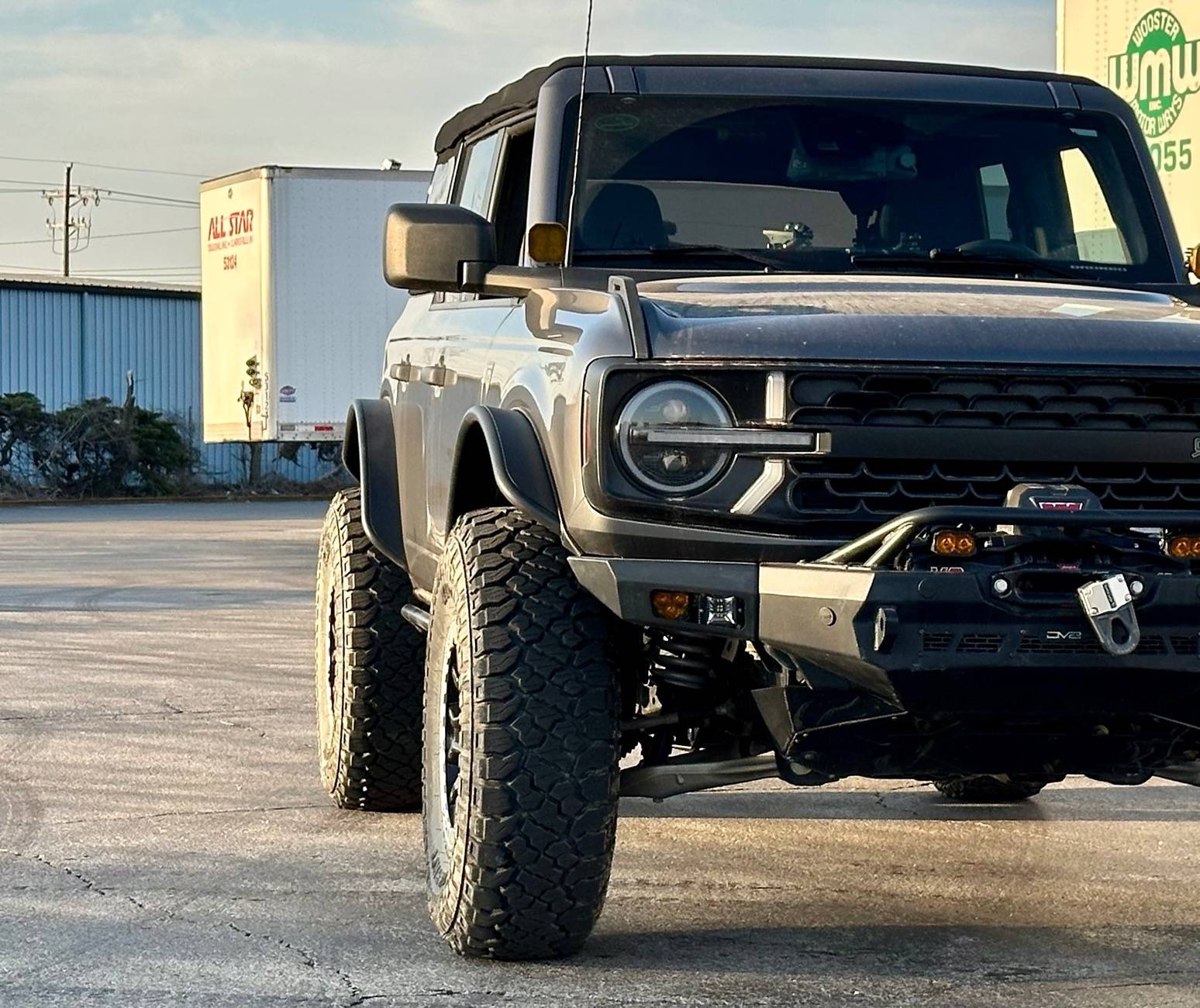

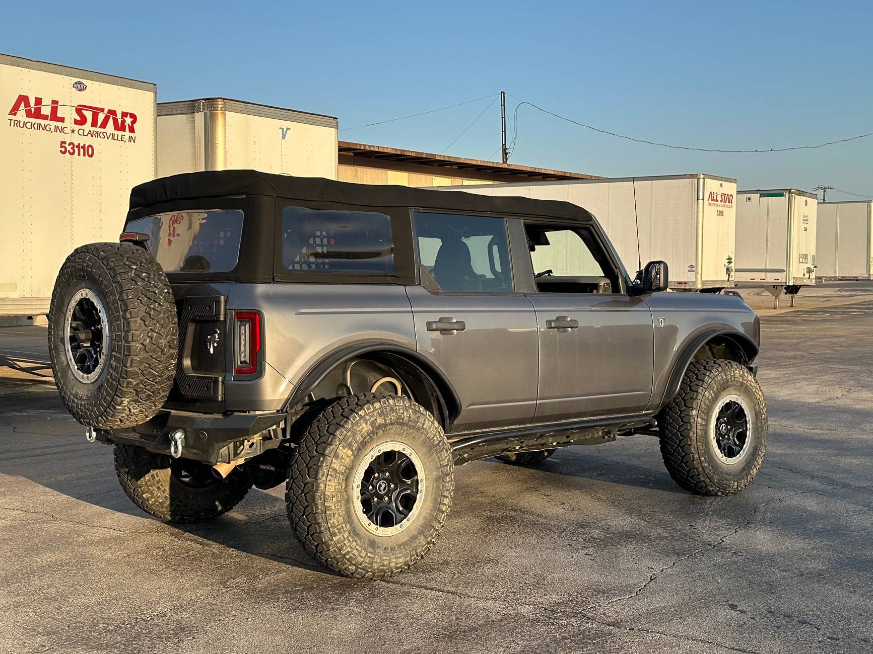

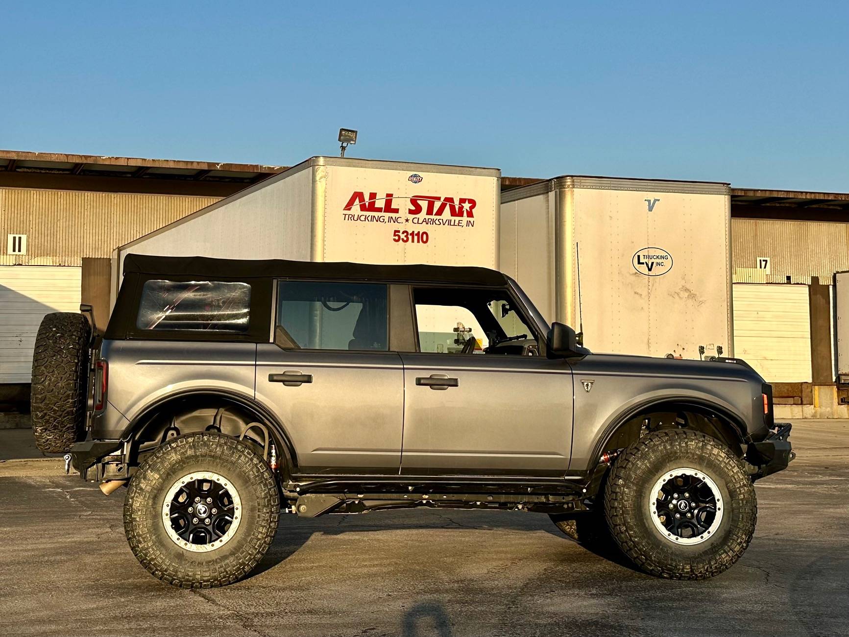

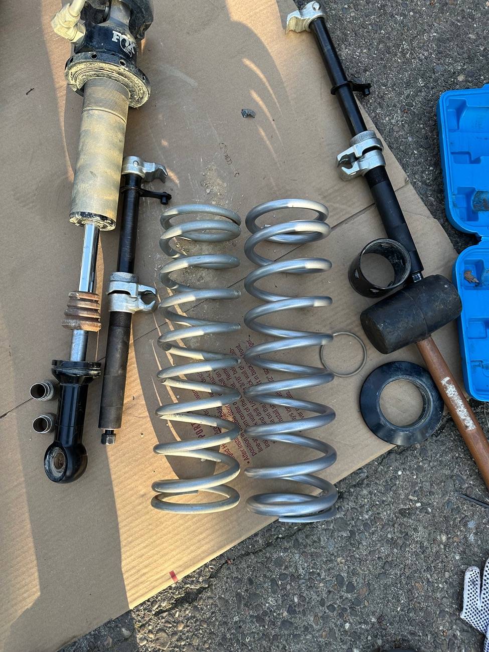

If your running fox you know all about the rear sag and how soft the fox factory springs are that come on the Elite kit. I absolutely love the way they ride but just a little too soft in the rear, they bottom out quite easily.

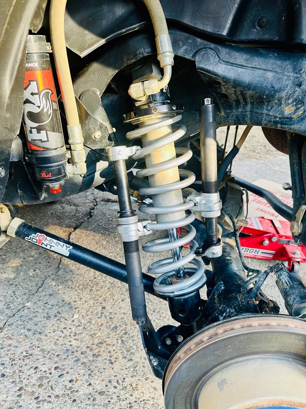

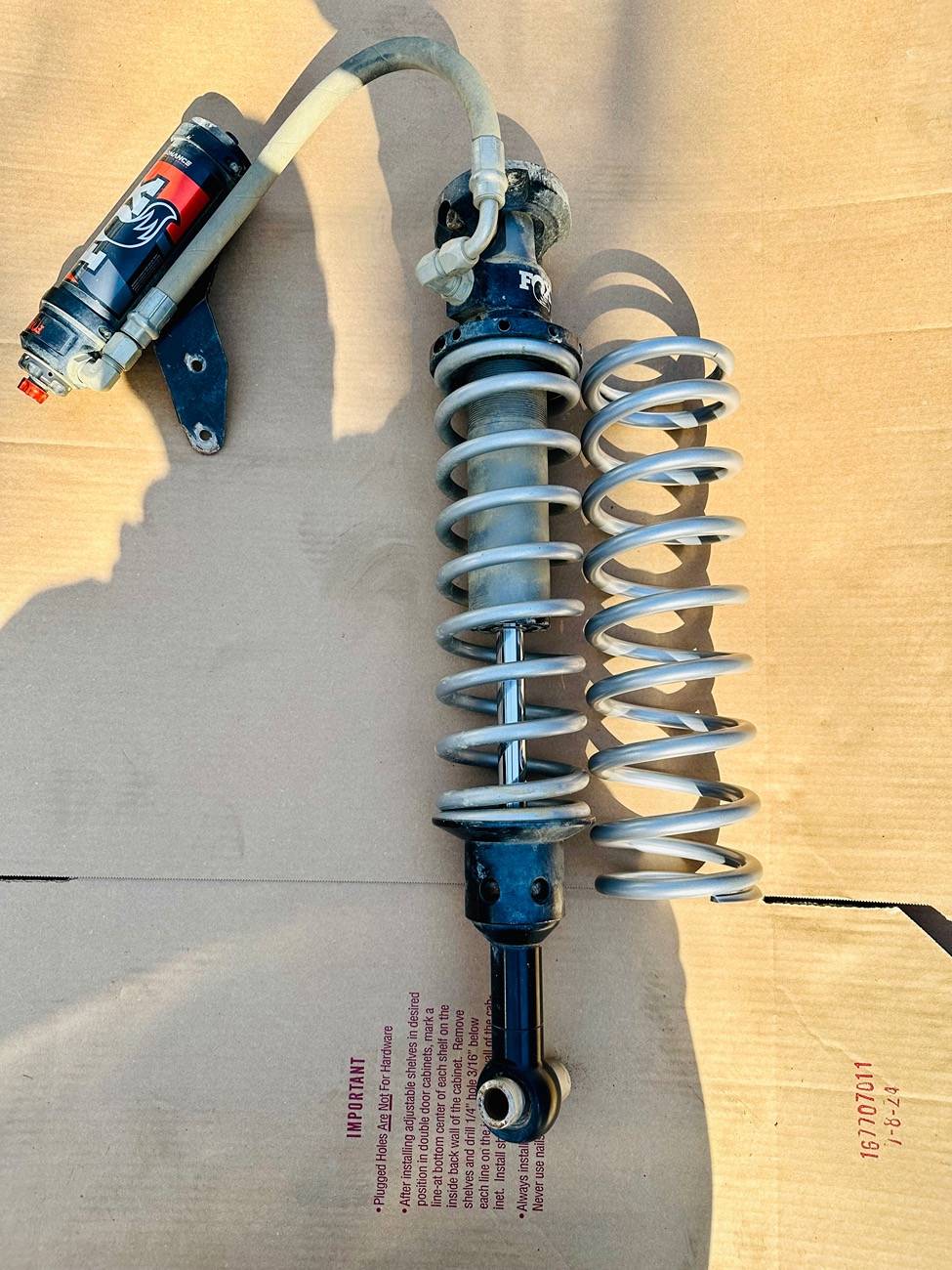

The install is pretty easy just make sure you decide on how much preload you need before putting them back on the Bronco. I didnt find the directions till I was installing the 2nd spring. You want no thread showing. If you have any thread showing it’ll probably be way too much unless you have lots of gear loaded in the back or a hardtop and RTT. I did find out you can make adjustments on the rears without taking them off by squeezing some spring compressors in there, you can compress it enough to make adjustments.
I ended up with no more sag. I’ve got 1.5 inches of rake now. The ride still feels just as good as it did maybe just a tad firmer but honestly I couldn’t tell that much. This is also on 3 clicks up on low speed and high speed compression settings which was the factory preset. I turned them back down to that preset to see if I could feel any difference. But in these new directions it says the preset should be set at 6 clicks up on both. So. I’m still need to make some adjustments to those settings and find my new comfort zone. Fox says 22% firmer and I’d say they are definitely that. I’m happy with them and the install wasn’t bad at all. I highly recommend the upgrade fox should have sent us these coilovers with the HD springs installed in the first place.
I ended up with no more sag. I’ve got 1.5 inches of rake now. The ride still feels just as good as it did maybe just a tad firmer but honestly I couldn’t tell that much. This is also on 3 clicks up on low speed and high speed compression settings which was the factory preset. I turned them back down to that preset to see if I could feel any difference. But in these new directions it says the preset should be set at 6 clicks up on both. So. I’m still need to make some adjustments to those settings and find my new comfort zone. Fox says 22% firmer and I’d say they are definitely that. I’m happy with them and the install wasn’t bad at all. I should’ve filmed my second coilover because I was a lot faster and smoother because I just did one of them, but the whole job didn’t take very long. I highly recommend the upgrade fox should have sent us these coilovers with the HD springs installed in the first place.

I'm sure you'll have some settling of the rear springs, but can't you add some preload to the front to help with the rake.... assuming you'd rather have less? How much rake did you have before the spring swap?
Frankie945
Frankie945
Frank
Apr 8, 2021
58
880
2,199
Louisville KY
Q50
I think it’s fine as is might settle a half inch. Once I load all my off roading gear and tools it’ll be just right. It use to sit low in the rear.
