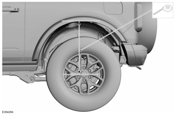

  1. Measure and record the distance from the center of the hub to the lip of the rear fender with the vehicle in a level, static ground position (curb height).

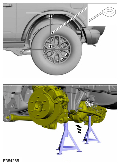

  1. NOTICE: Do not position the jack on the front control arm or rear control arm on any vehicle. Damage to control arms may occur.
    NOTICE: Make sure that the jack insulator pads are correctly positioned to prevent direct contact with other components.
    Support the rear suspension.
    Use the General Equipment: Vehicle/Axle Stands

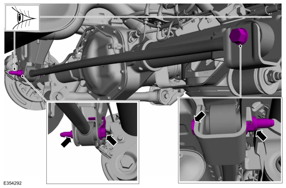

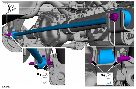

  1. NOTE: Note the position of the component before removal.
    Remove and discard the panhard rod bolts and nuts and remove the panhard rod.

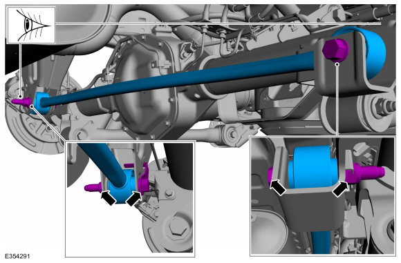

  1. NOTE: Make sure that the component is installed to the position noted before removal.
    NOTE: Panhard rod to frame bolt must point rearward to avoid damage to surrounding components.
    NOTE: Only tighten the nuts and bolts finger tight at this stage.
    Position the panhard rod and install the new panhard rod bolts and nuts.

  1. NOTICE: Tighten the suspension bushing fasteners with the suspension raised by a jack to curb height or with the weight of the vehicle resting on the wheels and tires. Otherwise, damage to the bushings may occur.
    Tighten the panhard rod bolts and nuts.
    Torque: 159 lb.ft (215 Nm)

  2. NOTICE: Do not position the jack on the front control arm or rear control arm on any vehicle. Damage to control arms may occur.
