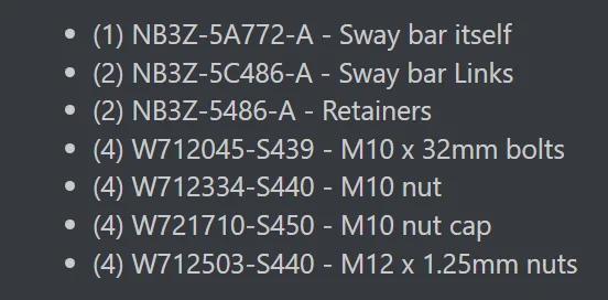

I decided to try a rear sway bar – want to see how it affects the handling of my 2 door. I ordered the parts yesterday. Thanks to @RagnarKon for having listed the part numbers!

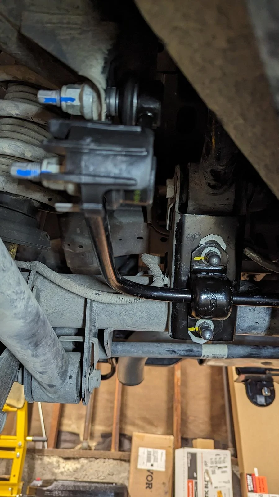

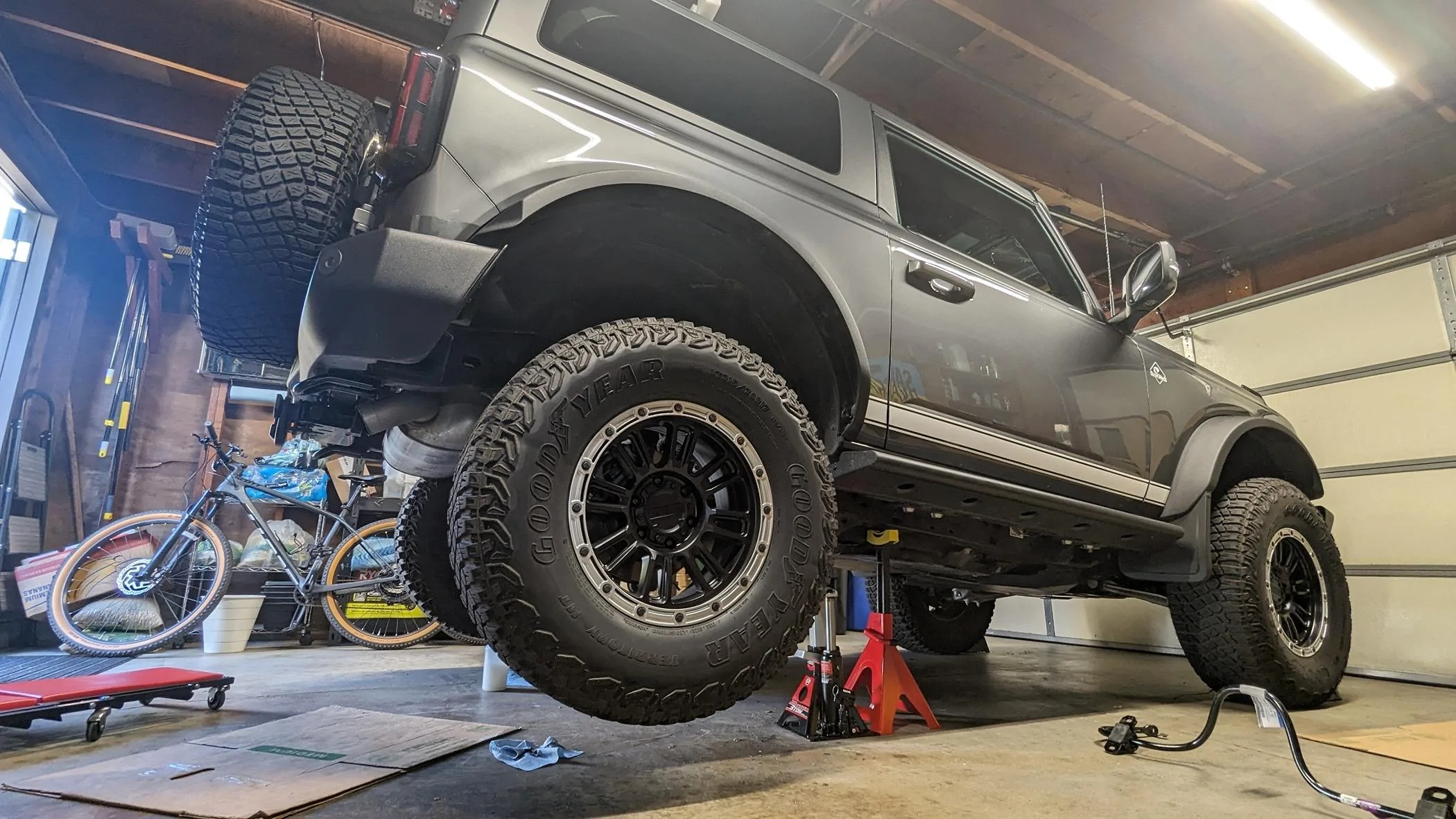

The sway bar was installed last week. I managed to get it done using hydraulic jacks.
Ford Bronco Torque Specs Rear Sway Bar? 1710918273353-il

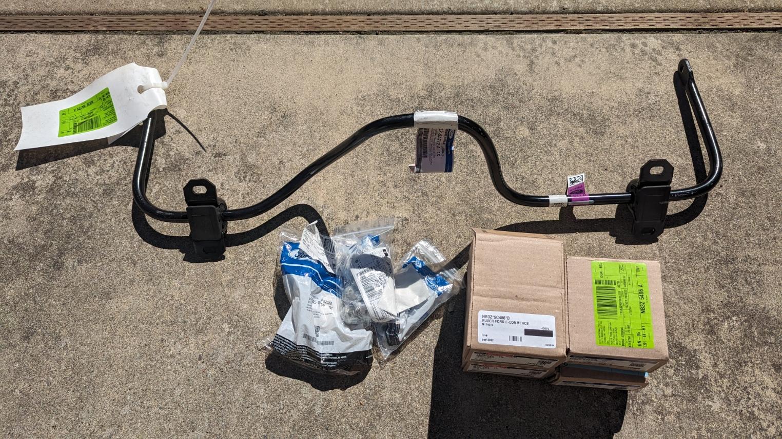

A correction to the parts list – there's no need to buy the sway bar clamps (NB3Z-5486-A). The sway bar comes with preinstalled clamps and bushings, so that makes the total cost of the parts below $300.
Ford Bronco Torque Specs Rear Sway Bar? 1710918314828-vk

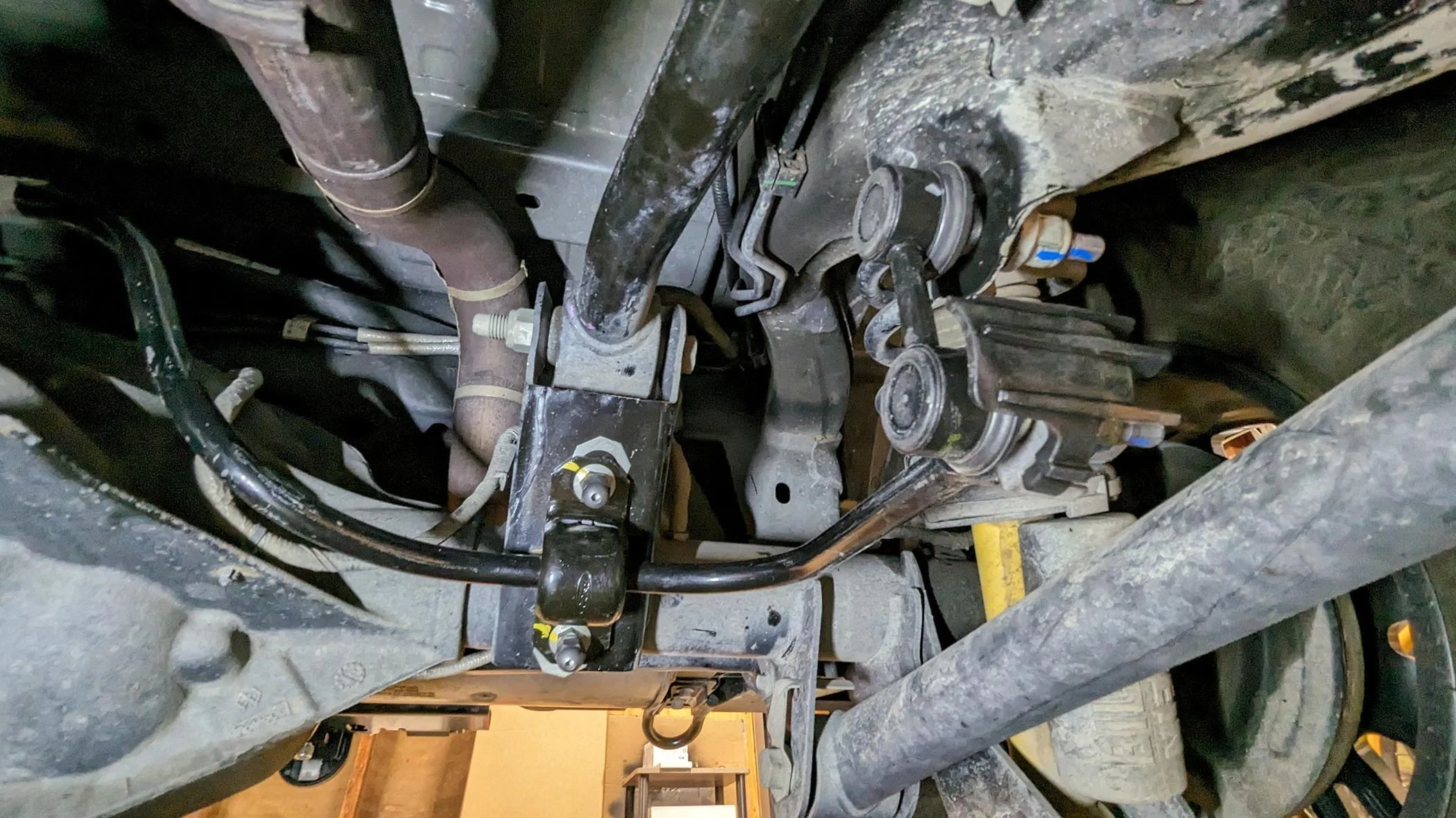

Snaking the sway bar into its place wasn't an easy task without a car lift. The rear wheels need to be at least 6 inches off the ground to provide you with enough space. I suggest feeding the sway bar from the passenger side. I don't know about the 4 door Bronco, but the fuel tank in the 2 door doesn't leave you much wiggle room.
Ford Bronco Torque Specs Rear Sway Bar? 1710918465373-s3
Ford Bronco Torque Specs Rear Sway Bar? 1710918529546-te
I haven't had the chance to go off-roading after installing the sway bar; so far, I only have impressions from driving it over the omnipresent potholes on the Bay Area roadways and some winding roads that lead to the ocean. It definitely was worth installing it! The Bronco has become more composed over bumps and less wallowy in a curve. I feel like I have more control over nosedive - it's now easier to pull to a stop smoothly. The difference is not like night and day – this sway bar is pretty thin and flexible, but it definitely has made the handling more pleasant.
