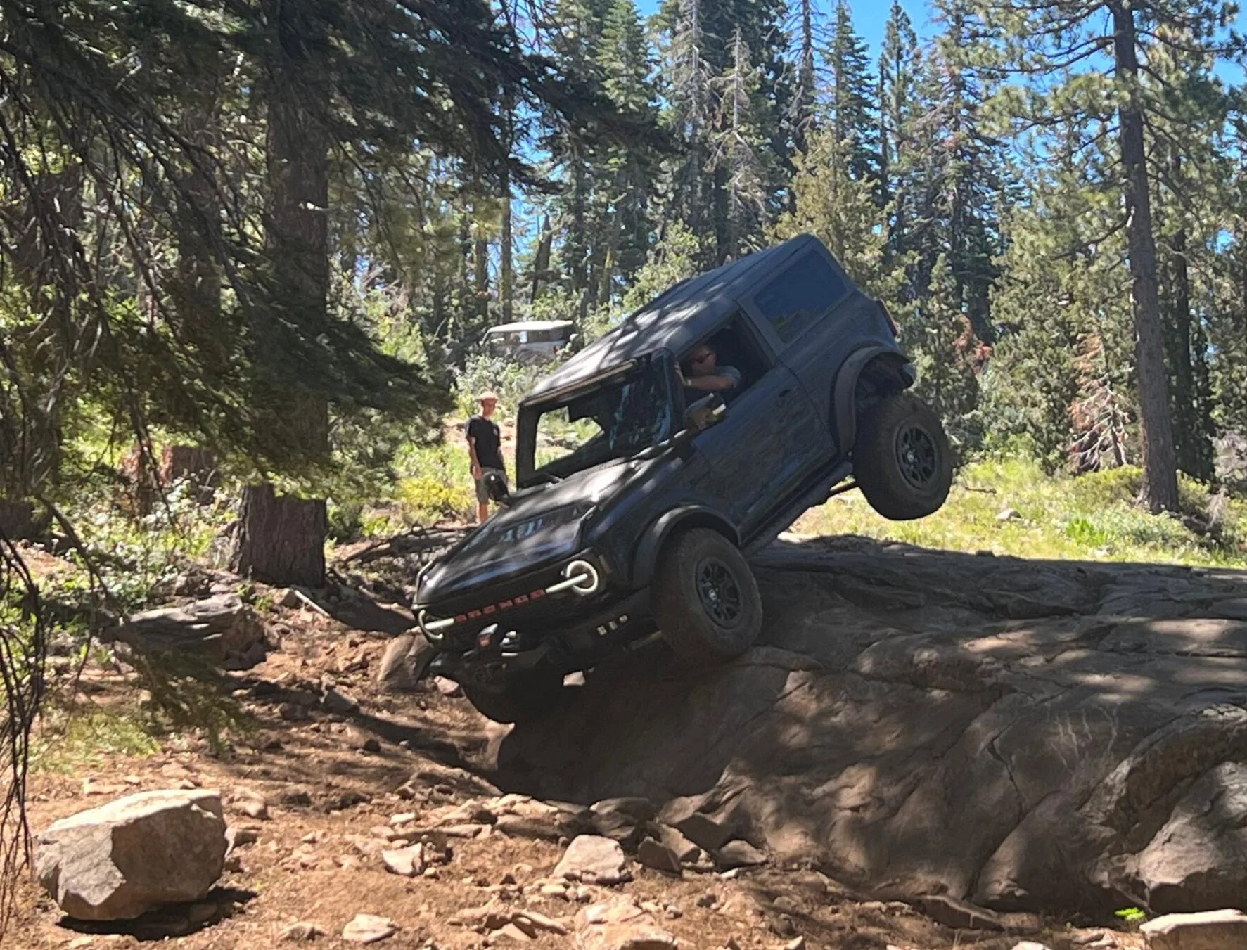

Adding a sway bar to the rear is going to affect your rti score, this is why Ford omitted it the first year to have good stats against Jeep. Going to lose some flex in other words.
My 2021 Two door flexing.
Not sure that's a sway bar issue... lol
Good times!!!
Team 2 Door = That's bad ass!!!
Edit: Bet if it was a video you could see the purpose built 2 dr coming in for a landing .... 🤣
