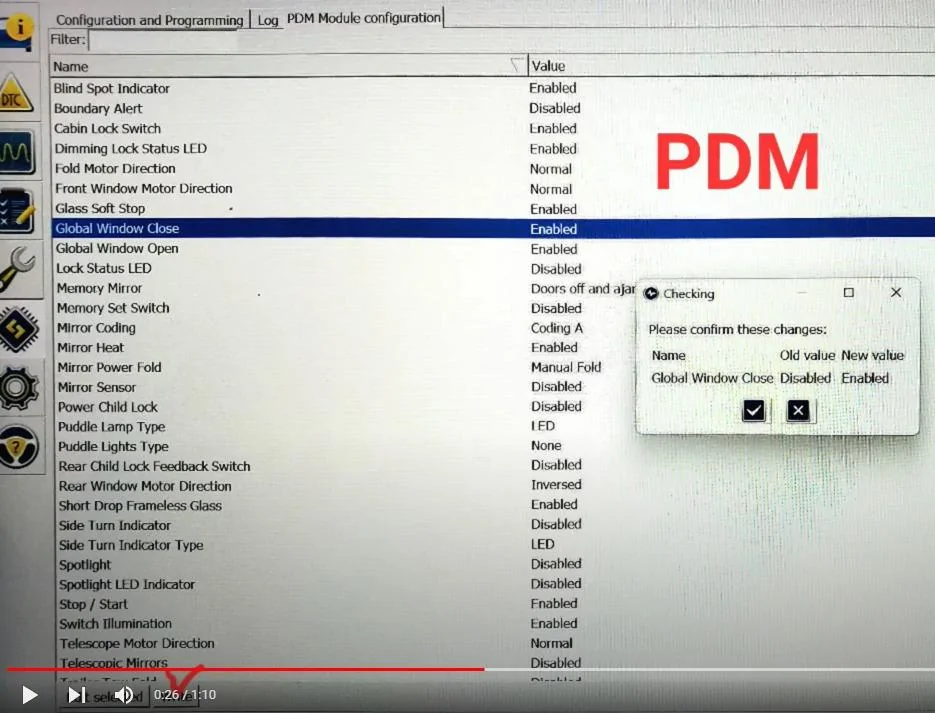

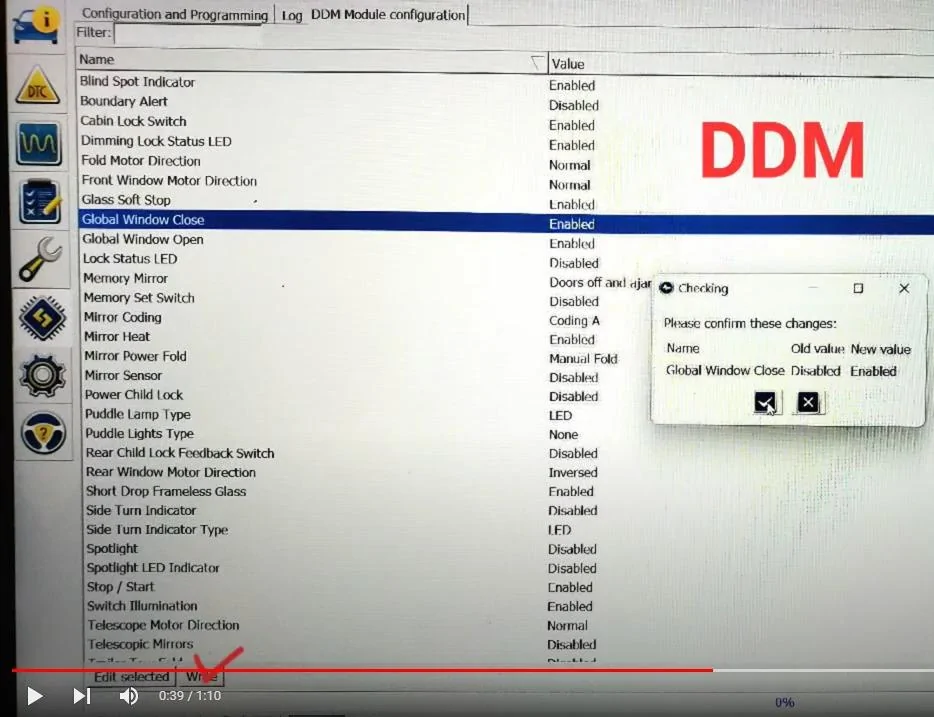

I have it working. 2D Badlands. Found a video showing how to enable it via the easy menus, not the hexidecimal AB menu.

Title is "
[EP.7] 2023 Ford Bronco Global Window CLOSE Enabled. Key Fob. FORScan / 브롱코 윈도우 오픈, 클로즈 리모콘 활성화. 창문"
Need to figure out how to disable the double lock click horn toot.

Can confirm this method works on a 23'. Thanks for this!

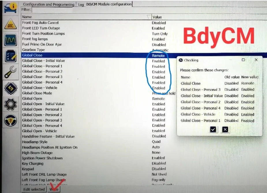

On the BdyCM module, are you making all 7 changes?

Based on the 1, 2, 3, 4...I think these are in reference to each door/window. If you look at the Global Open, which is on by factory...they are all enabled for 1, 2, 3, 4. This would make me think that a 2dr Bronco won't have 3 and 4 and just 1 and 2 but I cannot confirm since I have a 4dr and will be testing this out tomorrow morning (attempting to turn this on).
