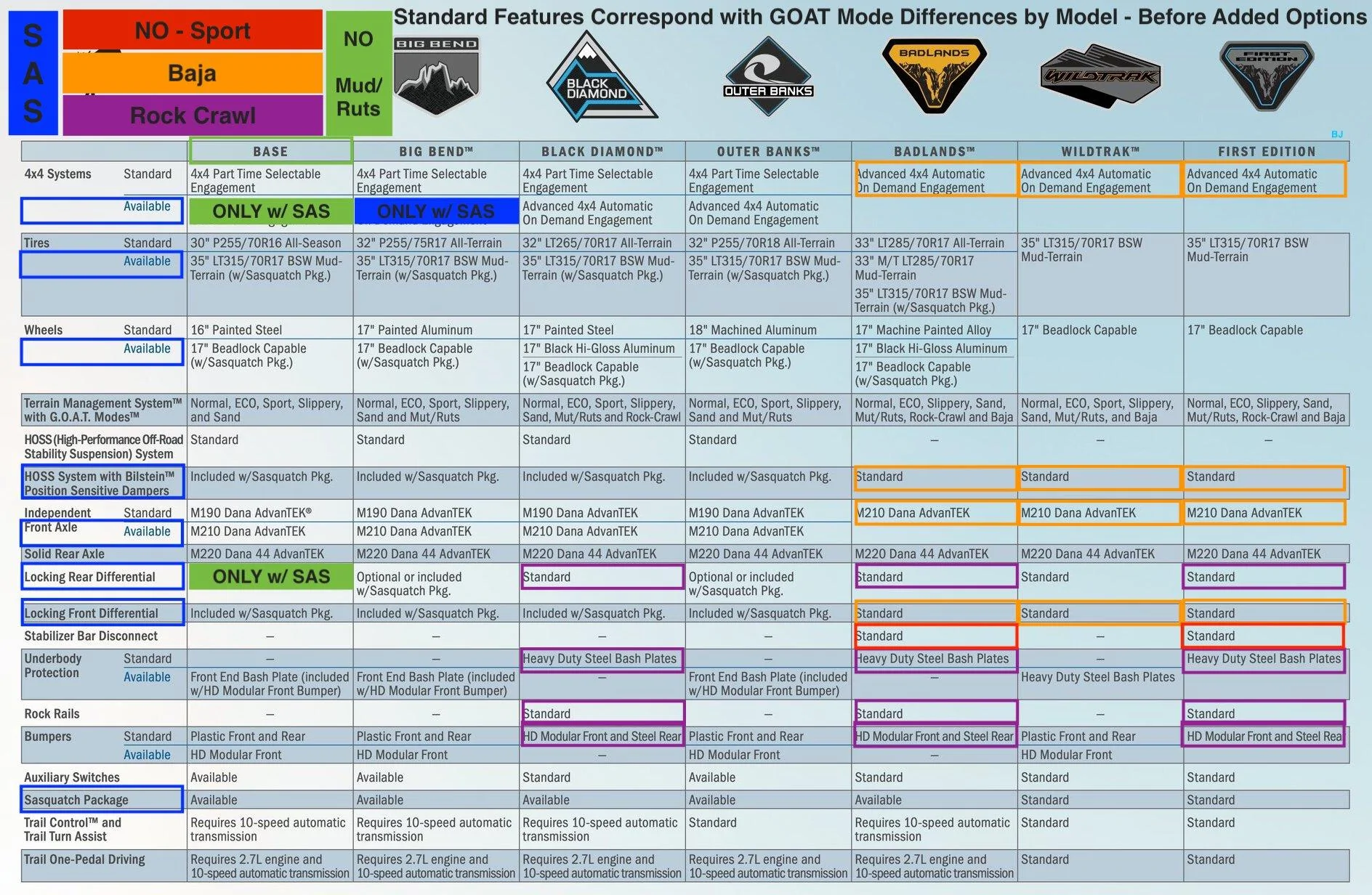

How they came up with who gets what GOAT Mode "Preset" is Marketing.
It is clear from the Default Options Chart that MudRuts goes with rear locker option, Baja goes with Adv 4wd/Bilstein suspension(SAS), No Sport with SBD, and Rock Crawling is just to sell Bumpers and Rock Rails.
Im betting the Computers should have all programmed, just need to be activated.
Ford Bronco GOAT Mode Question Comp_Chart_Edited

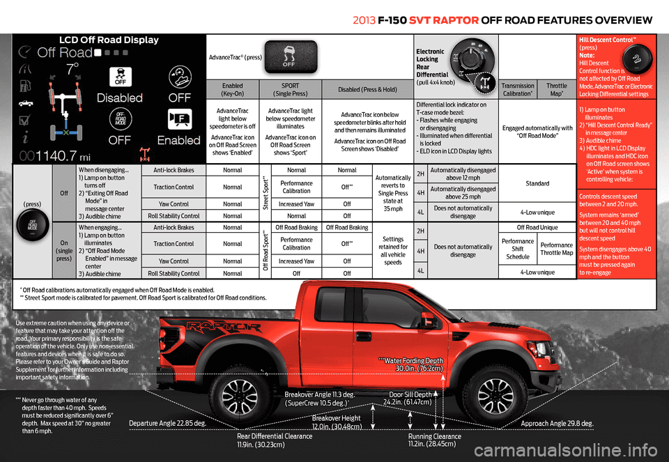

Here is the 2nd Gen Raptor Modes Overview. They simplified from Gen 1. Again, should give some insights to Bronco. Either way... they will eventually have a chart for Bronco. Most important... You Do Not Need any presets to use the Bronco. Just pick the 4wd Mode and engage lockers as needed. I used to use my minivan as a pit vehicle for Score Baja Races while wife and kids sat at the Hotel Poolside. Picking the right line is way more important than any goat mode.
Ford Bronco GOAT Mode Question 2019_Raptor_Modes
