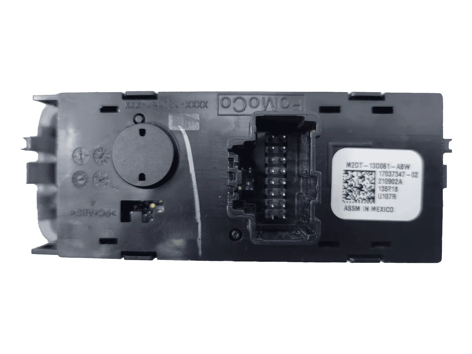

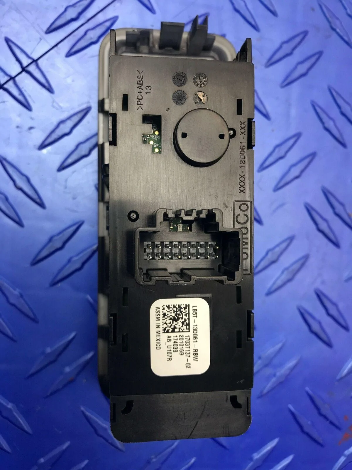

I have a 2022 base model myself and its been having the problem as well. The lights will randomly turn on at random times. I was working out of town and could see my bronco from my window and I looked up and there it was with the headlights on. I walked out and opened the door and it was dinging like a key is in the ignition or headlights left on. The screen is on and gear indicator lights are illuminated. I noticed the light switch is the same as the 2020+ Explorer and the plug even matches. I was wondering if that would be a fix for this problem? It is very annoying to travel and be worried about a brand new cars battery or the life of my screen being shortened due to this flaw. A used explorer switch is around 50 bucks on ebay. I'm sure pull a part places are around the same price...
Edit: top is bronco and lower is explorer, they both are stamped xxxx-13D061-xxx
Ford Bronco FIXED: Headlights turning on when switched off explorer light switch 2020
