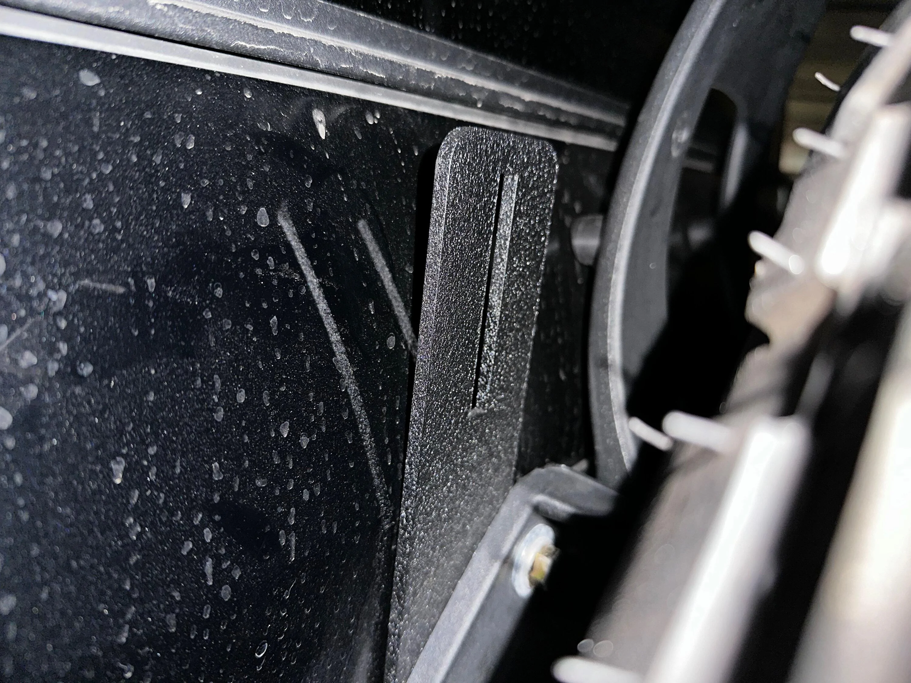

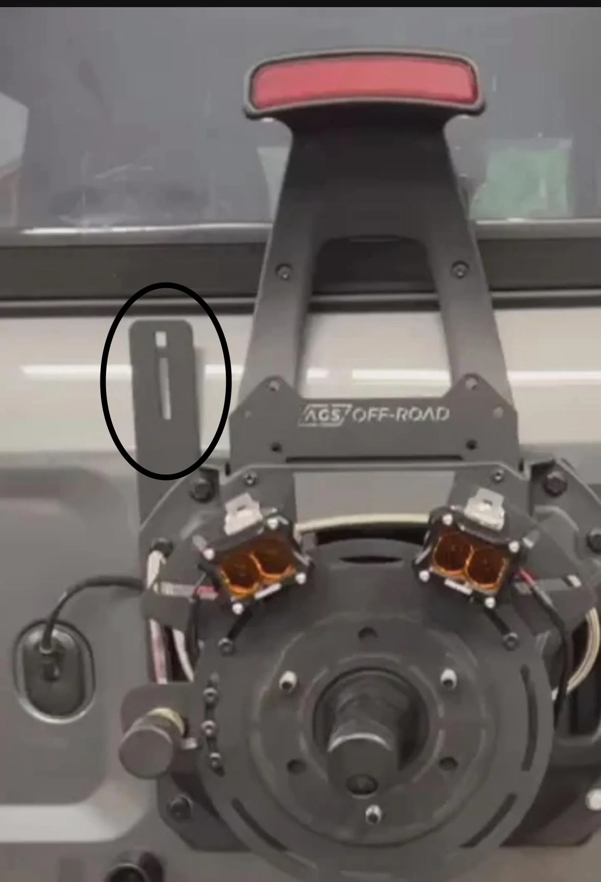

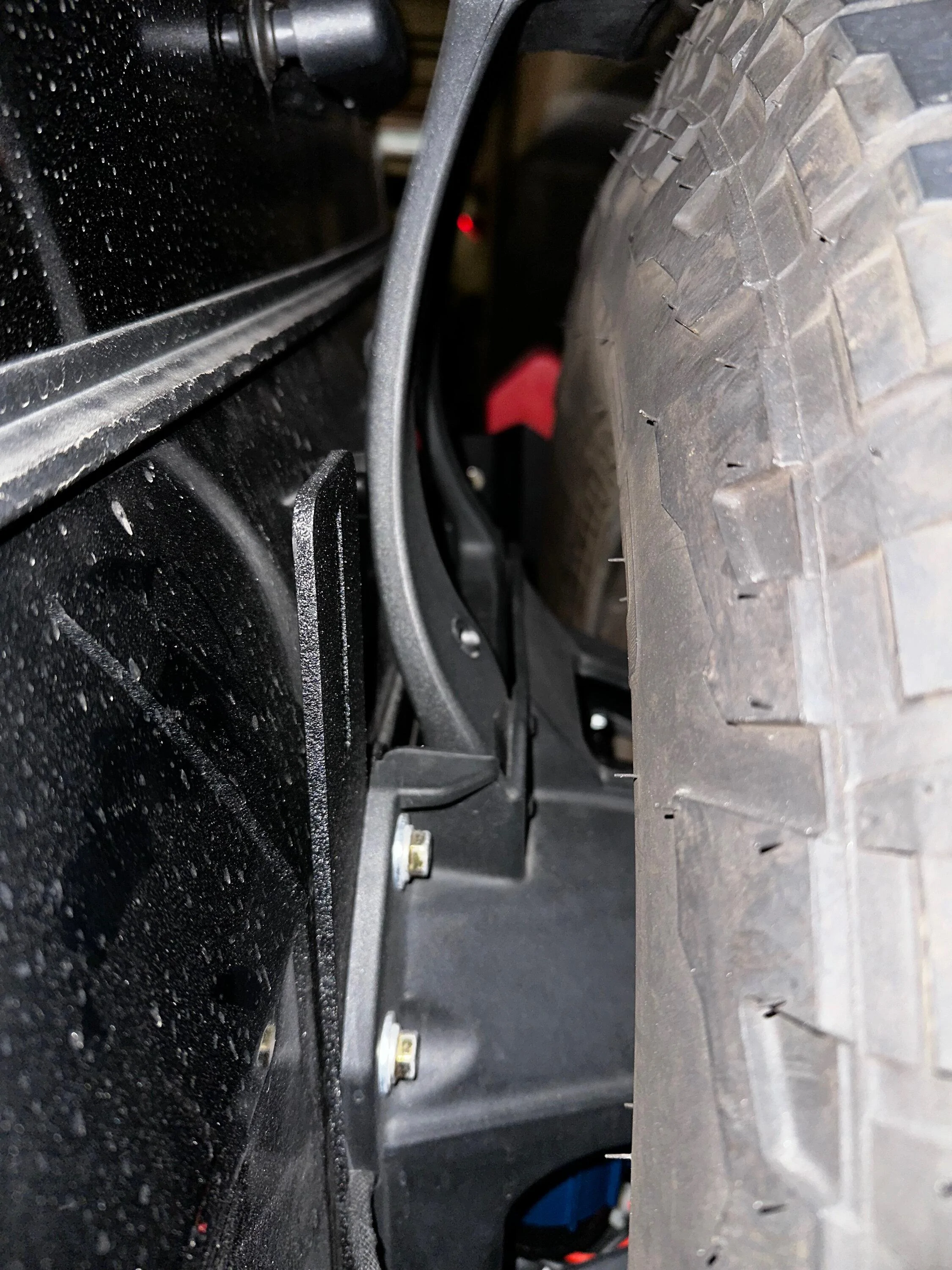

Hi, Friends - I'm trying to think of a solution to attach the WeBoost bracket to the antenna bracket on my tailgate reinforcement that will still allow me to use the elbow joint to fold the antenna down 90 degrees behind the tire when I'm not off-road. I'm thinking maybe just an "L" shaped bracket. I might have to go to a metal fabricator and have one made. But I'd think if I went that route I could drill two holes on the verticle plane of the bracket to slot two bolts into the tailgate bracket. And then on the horizontal plane I could drill holes for the weboost mount. But would appreciate any feedback of other ideas here. Thanks!

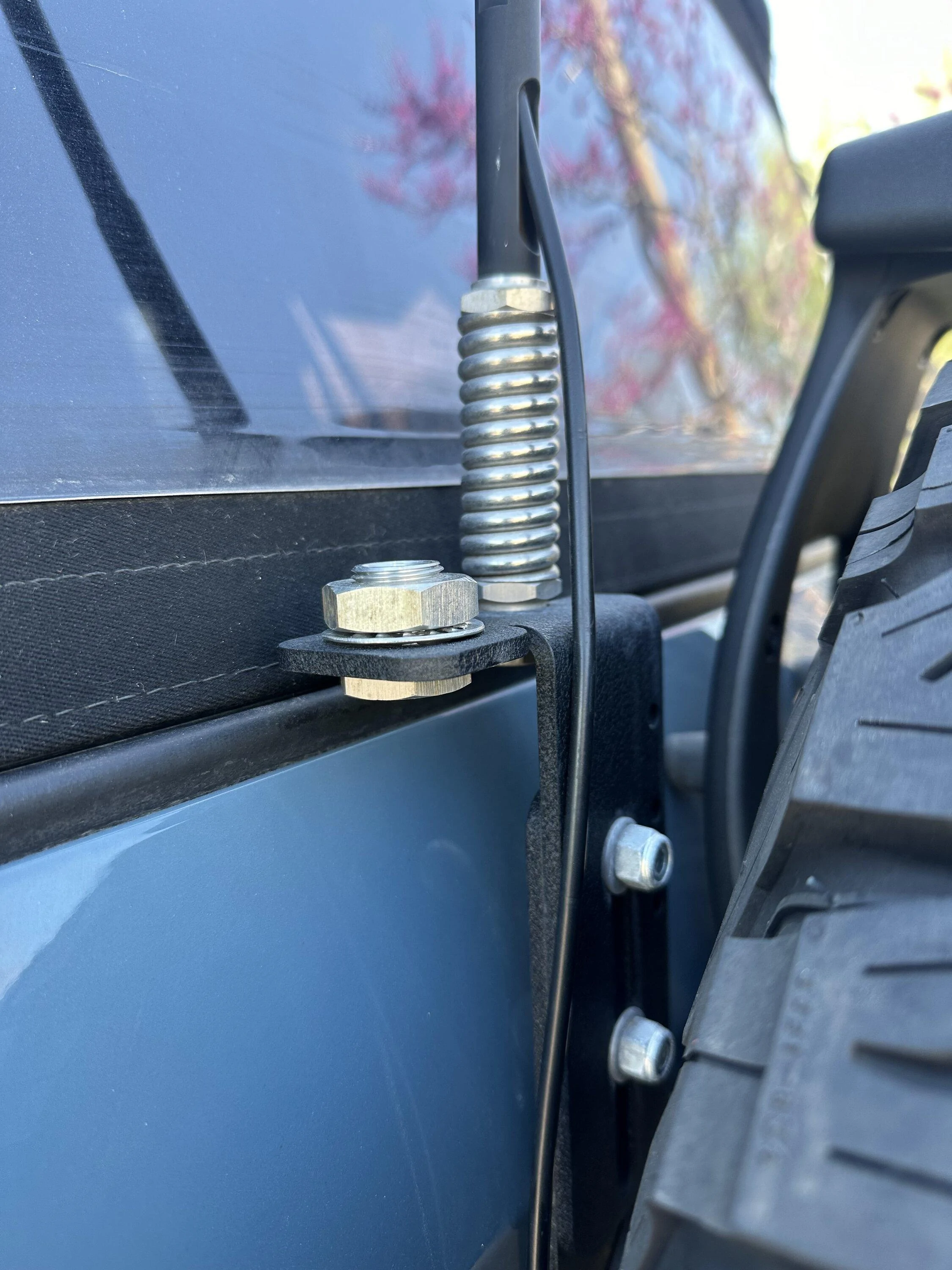

Email them and ask for Antenna/Chuck Mount + hardware. That’s what I did. Easy install

Sorry @Roofus I’m just realizing that solution doesn’t allow for you to fold it down. Mine barely peeks above my soft top roof if it’s any consolation. I had to go to the hardware store and get a nut for the antenna.
You may be able to drill into that piece they provide you and mount the adjustable elbow, although it might touch the window or tire. Curious to see what you end up doing

Totally get what you’re saying. I don’t think I’m going to get a real good picture of how to get this to work in a way that allows the antenna to fold down behind the third brake light until I can mock it up. So I went ahead and ordered the AGS part that you highlighted. It appears the weBoost foldable mount has a small plate on the bottom. My hope is that plate can be welded to the horizontal plane of the AGS bracket then I can attach the weBoost mount so it can still be folded down. i’ll report back once I have all the parts (hopefully end of week) and can mock it up.

Just following up. Did some mock up last night. If you attach the chuck bracket flipped from the direction in your photo, and bolted down between the vehicle and the compressor bracket (rather than side closer to the tire as pictured) then the alignment will slot right between the rear wiper (on my hard top) and the rear brake light. You soft top guys should have even more room since you don't have a rear wiper.
So as far as the alignment, it's definitely possible. But now I have to figure out the best way to attach the 90 degree mount to the chuck bracket, which is complicated by the existing holes. If that piece was flat, it'd be easy... Trying to figure out if it would be best to try to weld a flat plate to the top of the chuck bracket that I can drill holes for bolts, or try to use a funky assortment of hardware to use a combination of the existing holes plus drilling out the others. Not great options without access to a welder or drill press at the moment.
