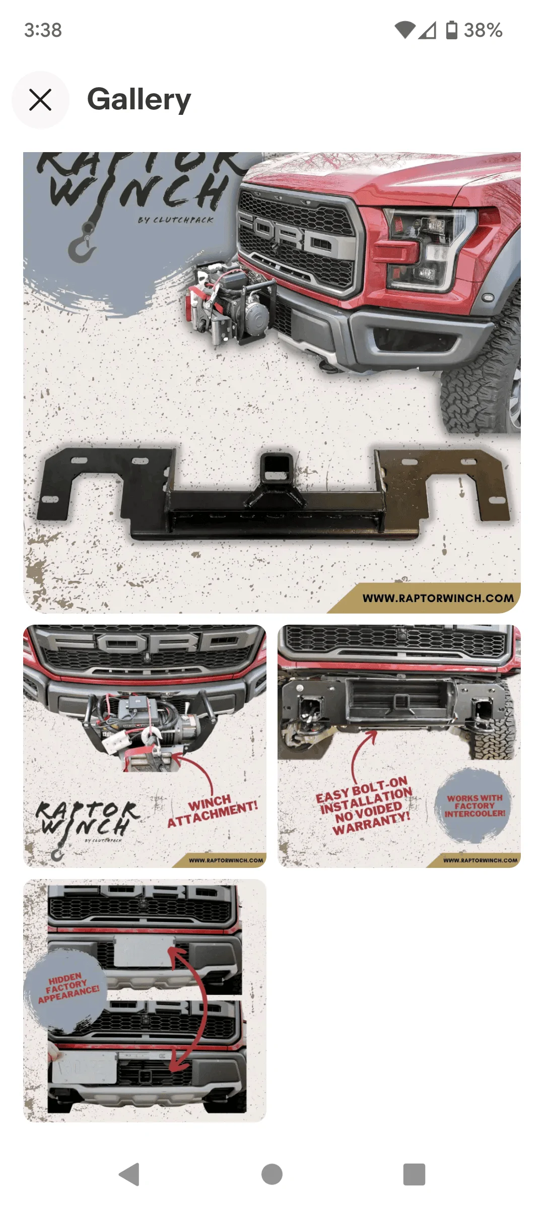

These guys are developing one for the bronco
Ford Bronco "Hidden" Receiver For Removable Winch Mount? Screenshot_20230127-153803

An interesting idea, but a setup like that introduces a heck of a cantilevered load. I’d be worried about bending with a load. Replacing one of the tow shackles with a more direct setup is the compromise I’ve thought about. Love to see more details as they progress. Driving to work with a 10k winch at 80 mph just seems wasteful to me.

Winch or no winch, this hitch is perfect for bike racks and cargo carriers. My 2-door needs all the space it can get..
