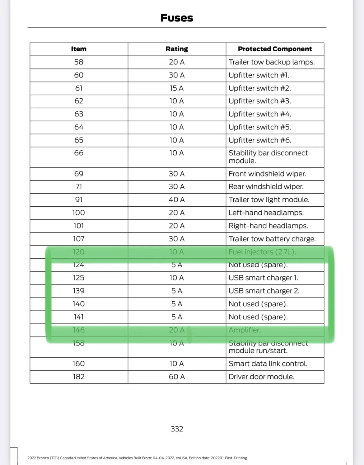

Hello, I want to buy a strip led light to install right on the front edge of the hood, and lights up when I start my Bronco. I have seen it in a lot of vehicles, but not in a Bronco.
So my question is, which fuse under the hood should I use? I will buy a fuse tap (piggy tail?) but I do not know which fuse should I/could I use for?
Normally I would think on the daytime running lights, which starts when I start my Bronco, but that fuse is in the inside panel and I would like to use the under the hood fuse box.
Also I would like to know if I can use fuse 140 and 141 which are “not used (spare)” for a 5A
Does anyone know if 140/141 are ignition power ?

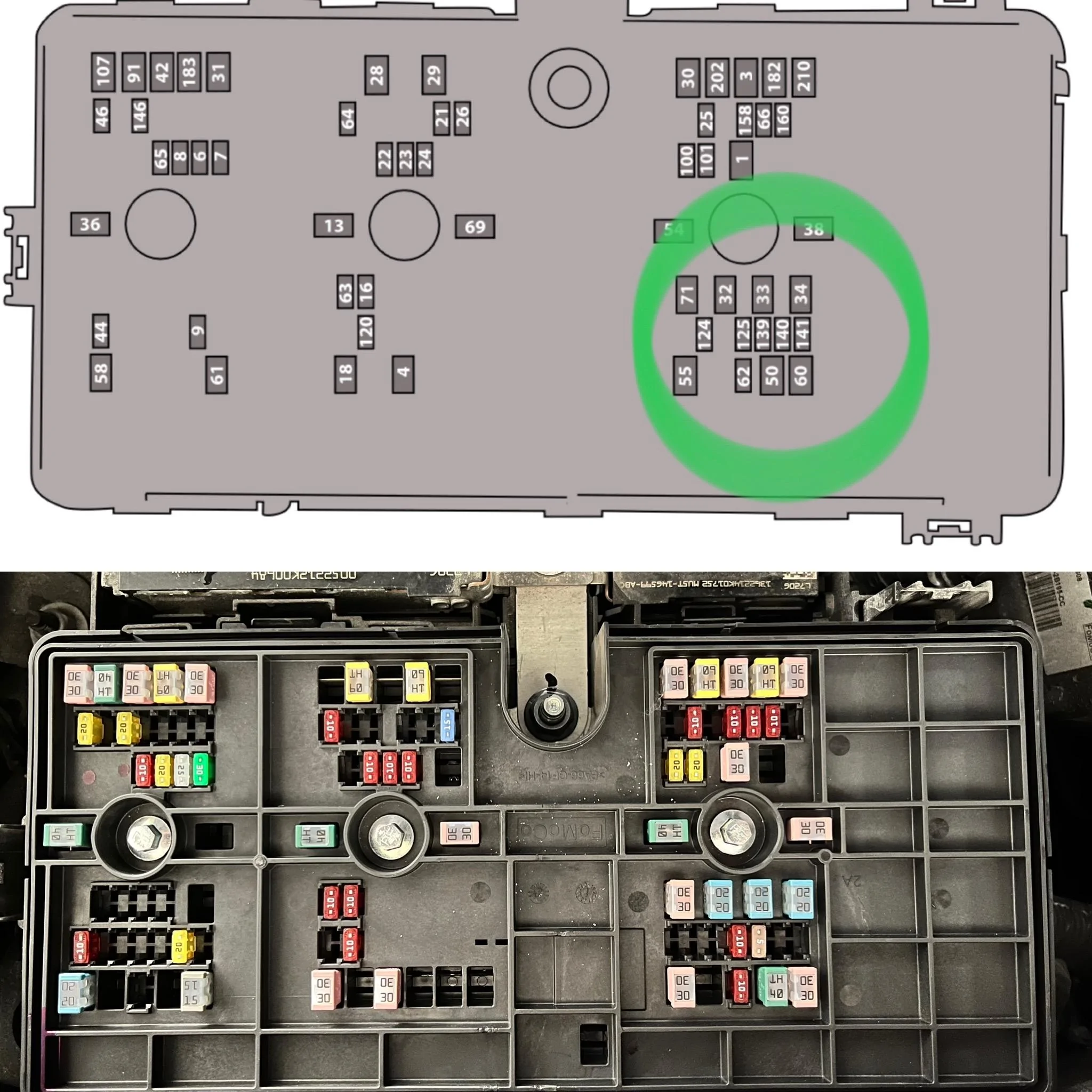

From what I've read, the problem with using the under hood fuses is the seal around the fuse box itself. You need to figure out a way to get wires in or out of it. I've also read that the spare fuses listed do not have power to them. So, you'd want to use a multimeter to test if that's true.

I bought the Mabett grill lights and the wiring came with fuses and a 90 degree plug and the wire came out of the side of the plug. I tried in the slot they suggested, #25, but it didn't fit and the wiring didn't run the right way..
I tried a bunch of spots.. the spares you are talking about do not have power, so they don't work and the USB spots have power all the time, so the lights will be on all the time.
I settled on #22 - the 360 camera spot as it fit well and likely that camera doesn't need or use anything close to 10A.
Yes, I did modify the seal slightly to get the wires out... the inner ridge I put a slot in with a Dremel, but the outer ridge had a slot for a wire in that location and a few others. I put some sealer where I ran the wire, should be fine.
