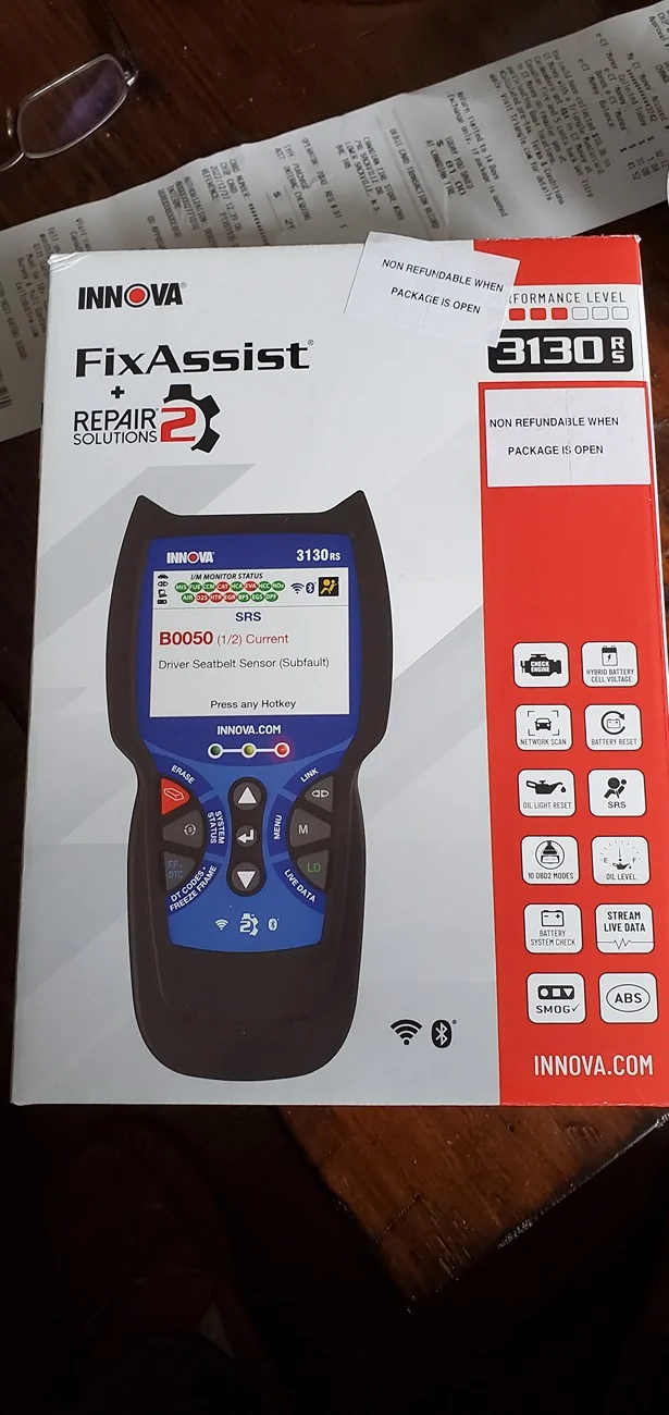

I bought this a few years ago. I'm not advanced enough to take advantage of all the features but it will scan for and clear all but permanently set codes that require dealers to reset. This one is Innova's middle of the road scanner and they are a US company but I think readers are physically made in China. Anyway it works great.

Thanks for the reply! Have you ever tried to clear the wrench light with it? I actually just ordered a BlueDriver bluetooth pro from amazon a few hours ago. I should have it in a few hours and hopefully that works. Fingers crossed.

My understanding is that most OBD2 code readers will clear codes but if the problem hasn't been fixed, the code will come right back. You need the reader to find out what components are failing, fix them and then clear it if you can.
I 2nd this brand, I have a different model from them and use it on my other cars. Have not needed it for the Bronco yet.
