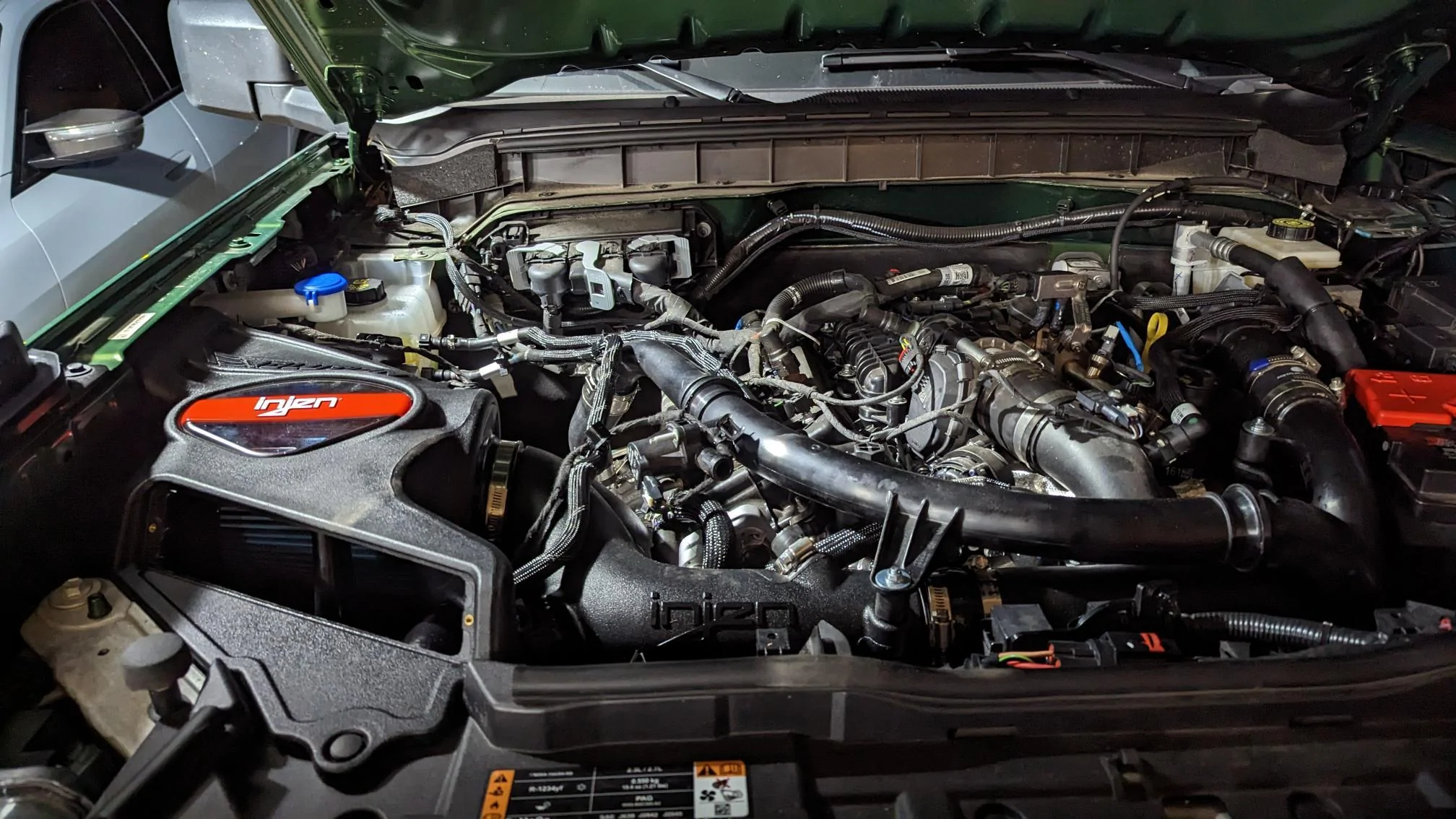

A little rundown:
be careful with the crank case vent clips, they’ll break, wife broke one and luckily the autozone had one in stock.
it’s a lot of work, I’d say the tear down was longer than the reinstall but they both have some challenges. Lots of tight spaces and hose clamps.
the kit fits well and wasn’t too horrible to put back together but I’d say 2+ hours for each part. We started around 5 and was done with the test drive at 930. I also dropped something almost immediately, an 8mm in my case,luckily it fell to the belly pan so I had a slowdown getting that off and back on so maybe could have shaved half an hour off.
I’d definitely recommend a second pair of hands, my wife helped and besides our usual bickering because we work differently, I would probably still be out there.

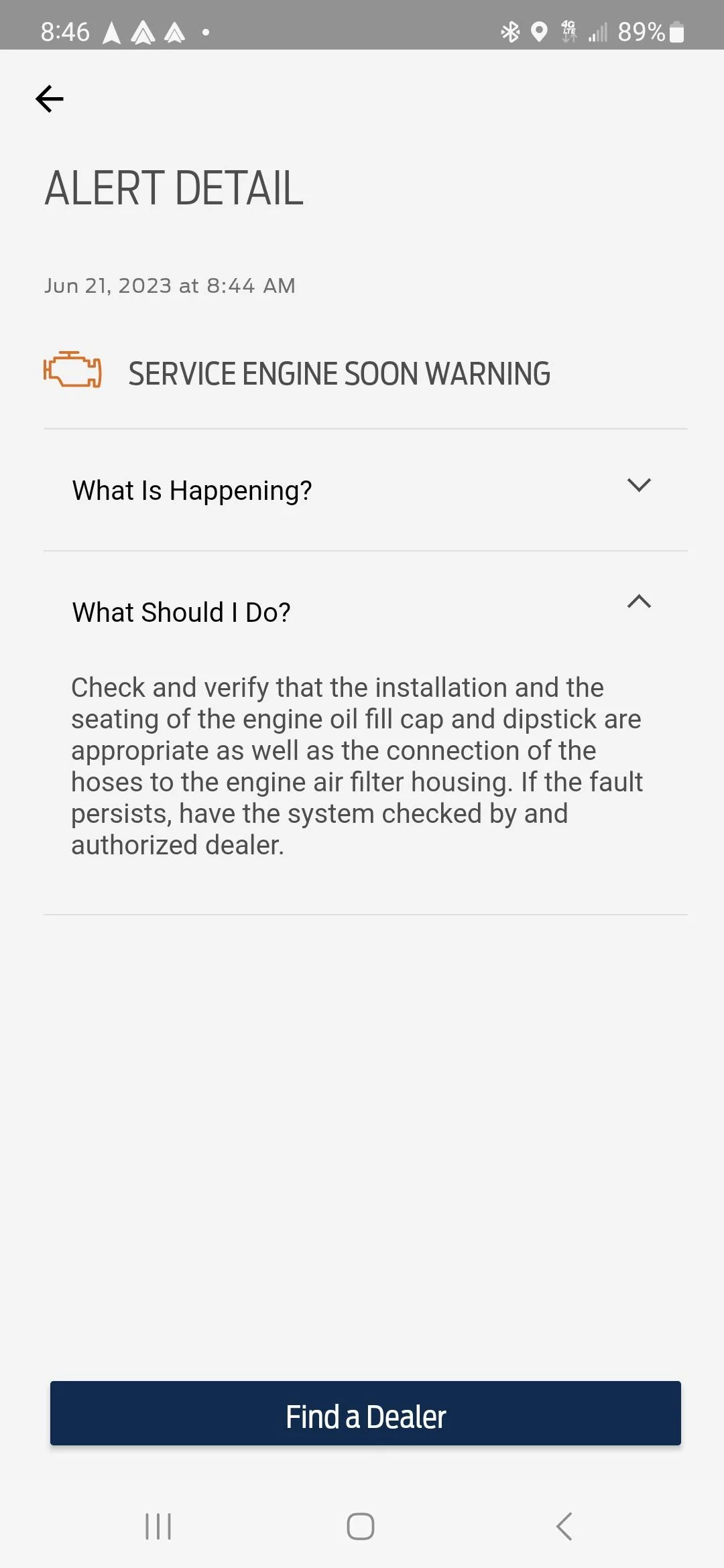

Just had mine installed yesterday grovered home everything was fine this morning I started it up I have an engine light. Throwing a code. Not sure what the heck's up with that.

Do you have a code reader? If not go to a parts store, they can read them. Report back on what it is. Probably a loose fitting somewhere.

He charged me $180. He checked and retighten all connections this morning. Don't know if it will help. We can't see anything that should cause this. I do have to stop somewhere to read the code. Hopefully we can reset with Forscan when he gets his laptop in a little e. Then hope it doesn't come back. Frustrating. Had a problem with the Mishimoto dual catch cans. Now this.

That's a good price for all the work that needed to be done. Of course, not if you keep having issues. There's definitely something loose. I see you posted in the other thread, let's just keep it going on that one since there's more info there!

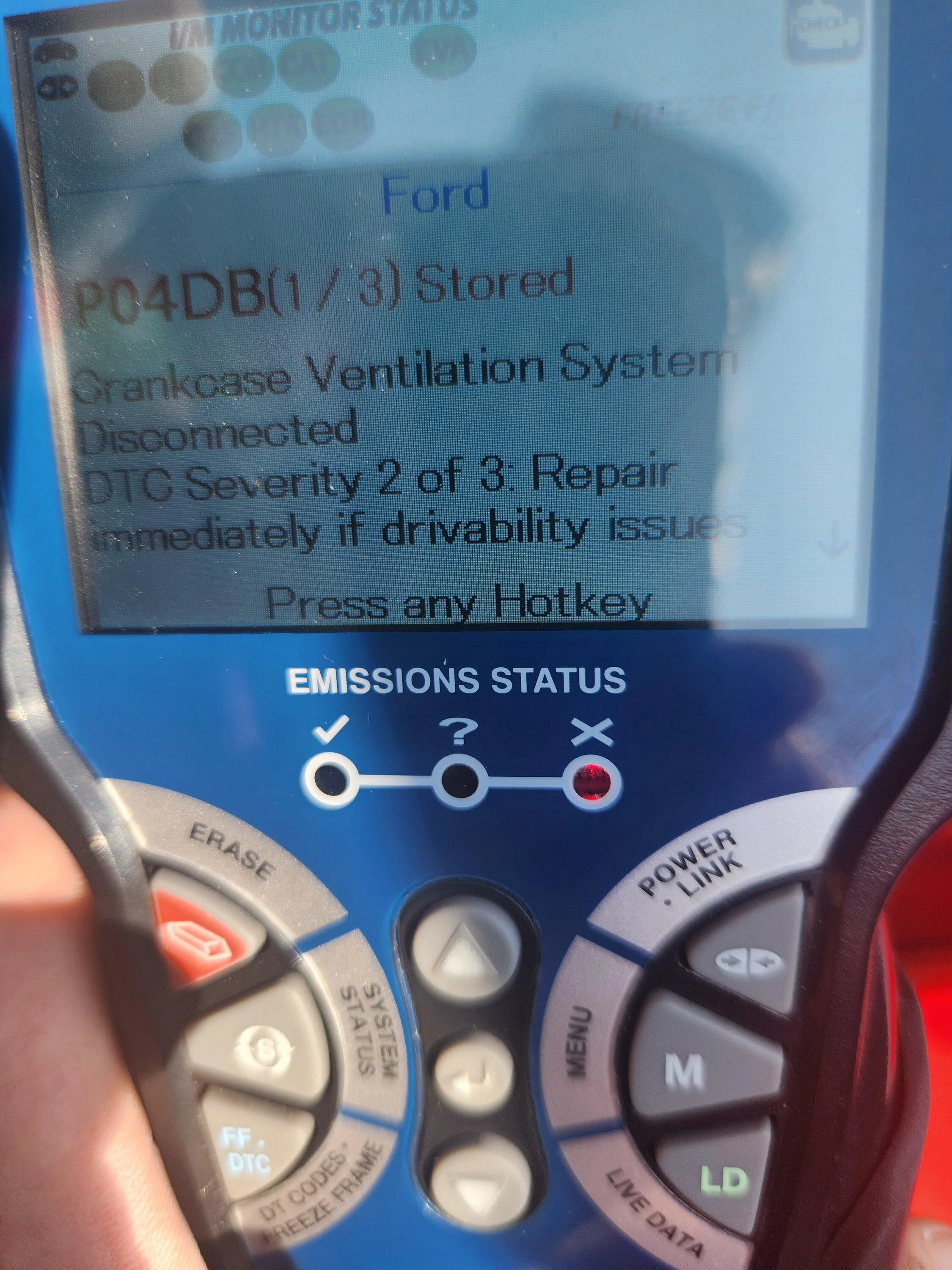

What year is yours? Mine is a 23. Here is the code. We pulled lubricated and reattached the CCV tube and reset code.🤞

This doesn't work on the 23 , it throws a code. The code is with the CCV system. Similar to the Mishimoto dual catch can system that throws a different but similar code on the 23 MY. I have been in contact with someone named Nathan with your company who is supposed to be in contact with R and D. I have sent pictures. Install is correct. Installer even bought a smoker to test the system, no leaks, everything is perfect. I watched him do it, he was VERY thorough!! There is a TSB for the 23's That has to do with a code that is different than this code, but deals with the same system . My thought is that TSB, which is a "flash to the ECU, might perimeters to similar or same as 22/22 MY. Something has to be done. I am driving around with engine light on.🤬. Please follow up. Supposedly, they will have a 23 in house this week. Because I have aftermarket CAI, and the code isn't the same as TSB, so Ford will not do the flash for me for free. Please pass along info. They should know my situation all ready.
