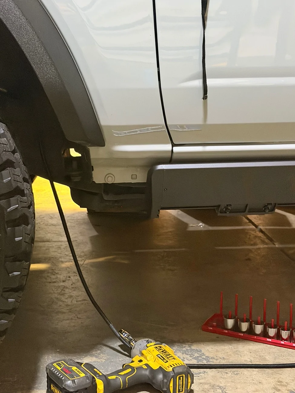

Installed Wolfbox Power Running Board
aaronkneeland
AARON
Aug 16, 2026
OH
2021 Bronco Outer Banks
Agree on being over zealous. One thing to be aware of with their steps, the wiring harness has a connector for override switch but they don’t offer it yet, to be released at the end of the year. My doors are off and they ship the motors retracted so it’s impossible to install them without putting the doors back on. I was trying to jump the connector for the override but they either didn’t program the controller yet to understand the bypass or it’s more complicated than closing a circuit. Also, the steps are on sale for $899 right now.
