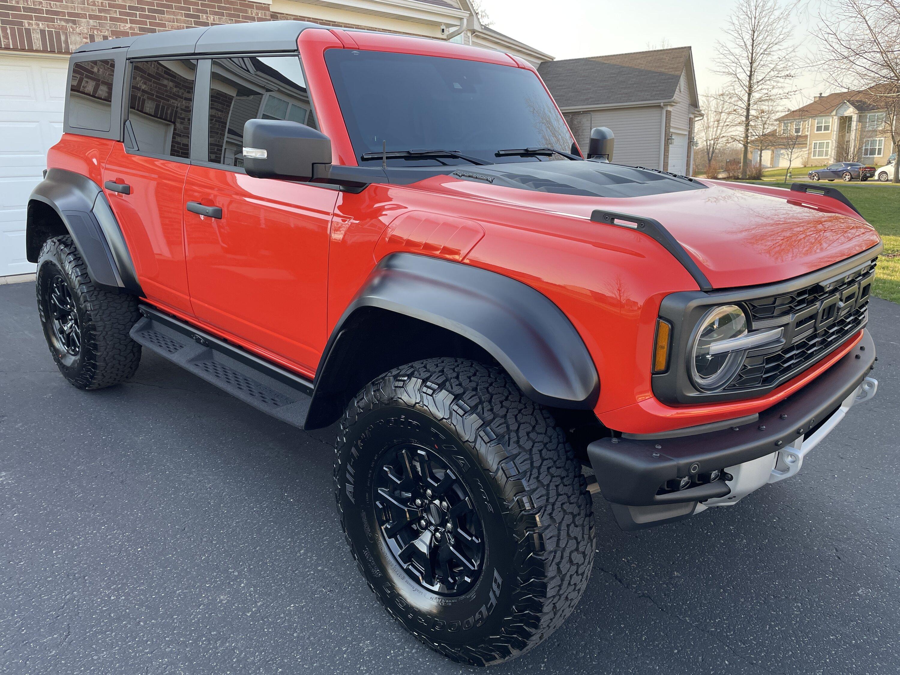

I have a 23 and due to the very dark window tint on the sides and windshield my DRL's won't stay on. The DRL's being tied to the ambient light sensor cause my headlights to turn on in the daylight because the tint makes the car think its much darker outside. I did a search and I can't find out if Forscan can program them to stay on all the time until I turn on the headlights manually? I HATE the auto headlamp feature.

Yes indeed that is the issue. I have 50% on the windshield and limo on the roll ups. I was just hoping there was a Forscan setting change that would allow the DRL's to be on all the time when the headlights were off. Oh well.
