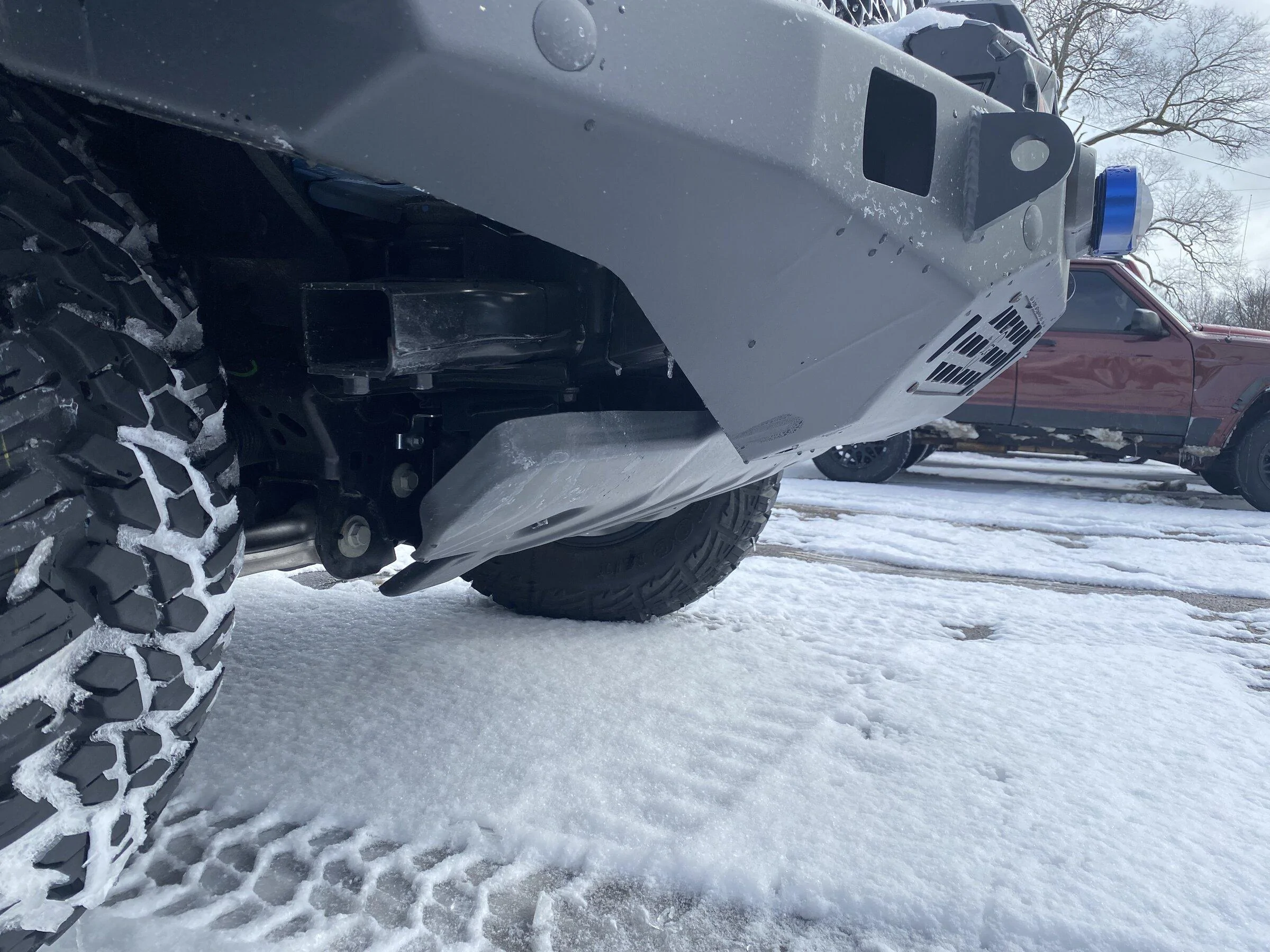

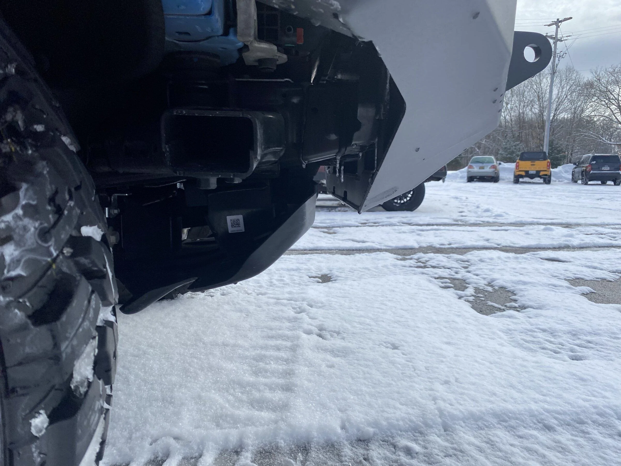

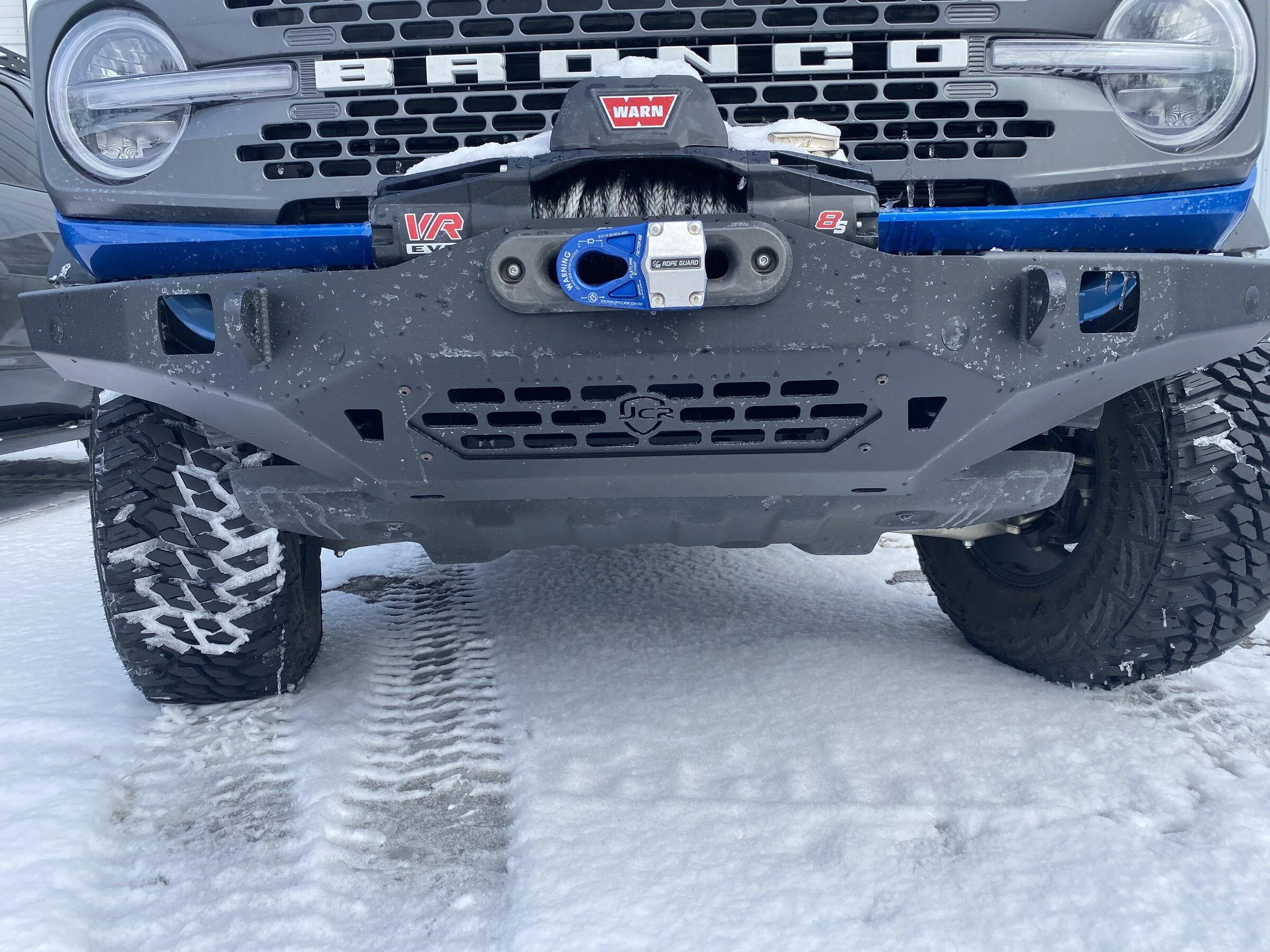

I have the factory modular front bumper with front bash plate. I have been told that with your vanguard their is a gap between it and the factory bash plate. Just wondering how large that gap is.
personally,I’d sell the base plate with the mod bumper and upgrade.

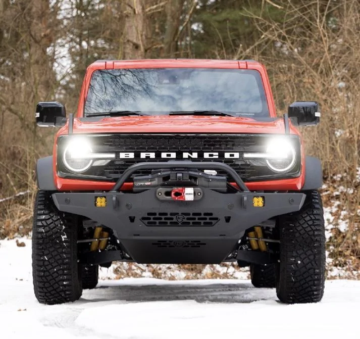

We decided to make a 3rd hoop option for the front vanguard.
Any chance they'll be one for the winch plate? That front camera is awfully vulnerable out there by itself.

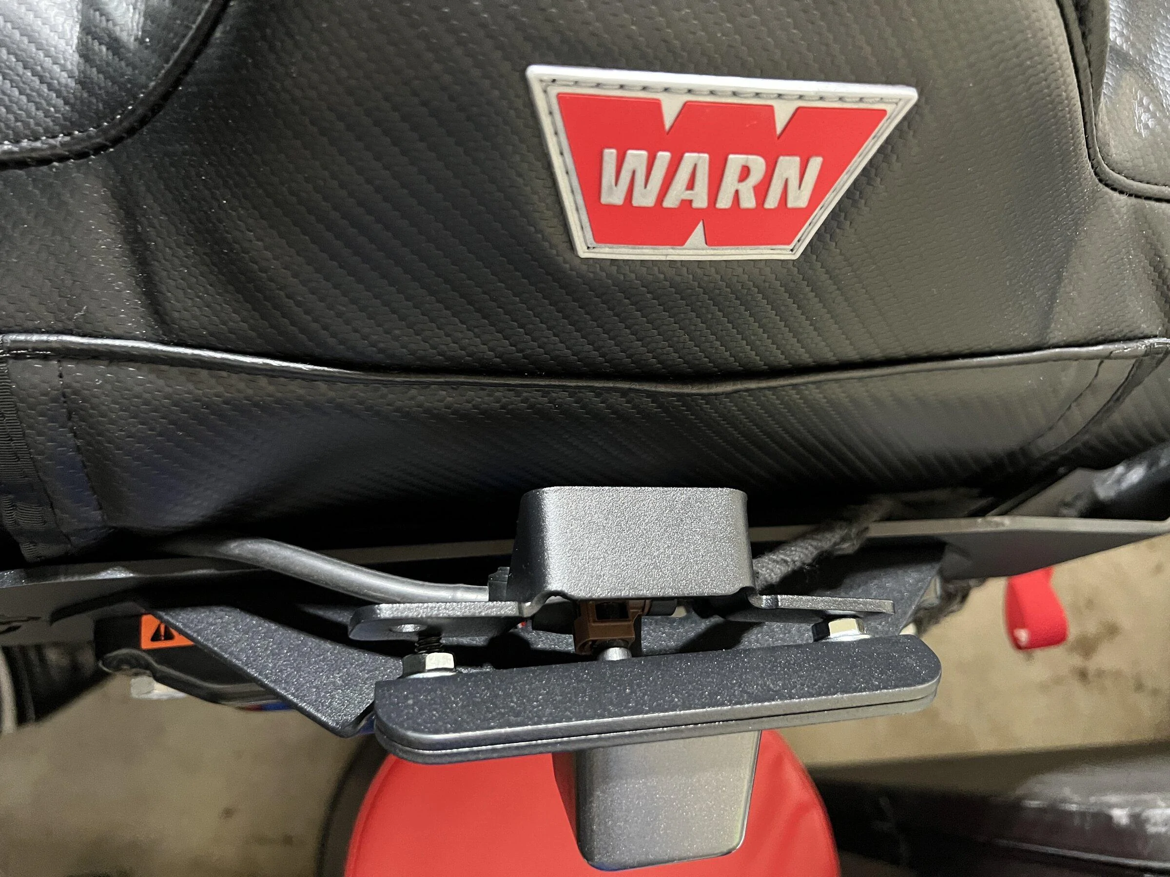

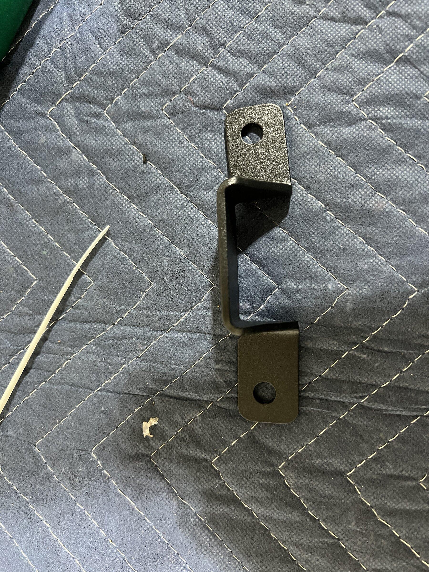

Did anyone who install the camera relocation get this part installed? The holes do not line up with the install location for me. Thanks.

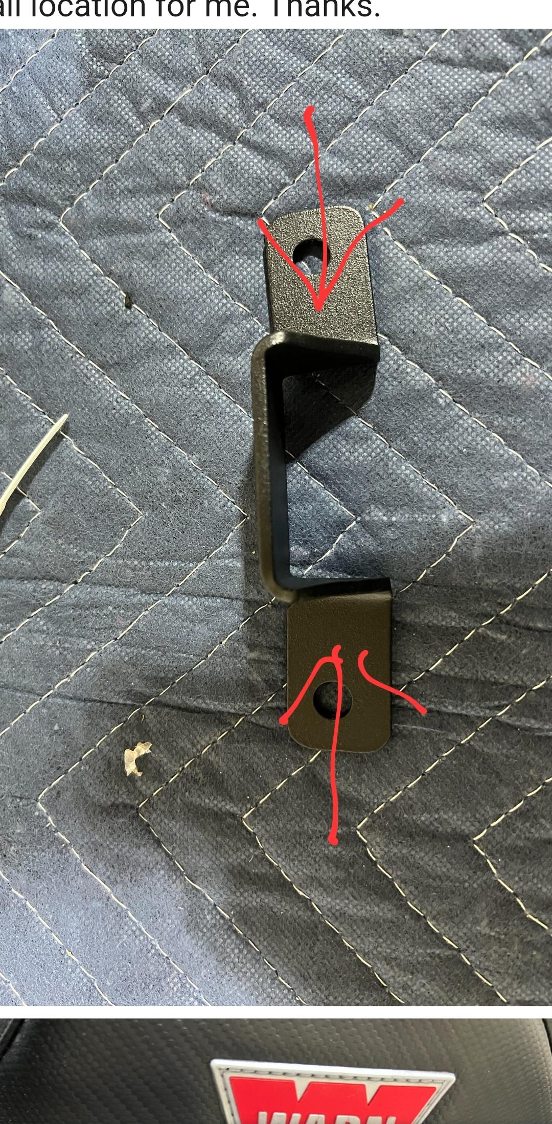

The same thing happened to me all you have to do is put it in a vise and squeeze it a little bit it just not bent properly
Once i did that it went right on.
Same here . Took a bit of fiddling. The holes obviously don't line up. I mentioned in a previous post (as well as the 20' camera cable). Basically got a shoulder shrug on the camera cable. No offer to send a correct length cable when they could be sourced. No response on the bracket hole.
I think they are sending me another one out, at least that's what they said, but I haven't received a shipping notice yet. I went back and looked at the installation video, and this part is never mentioned or installed during the video.
