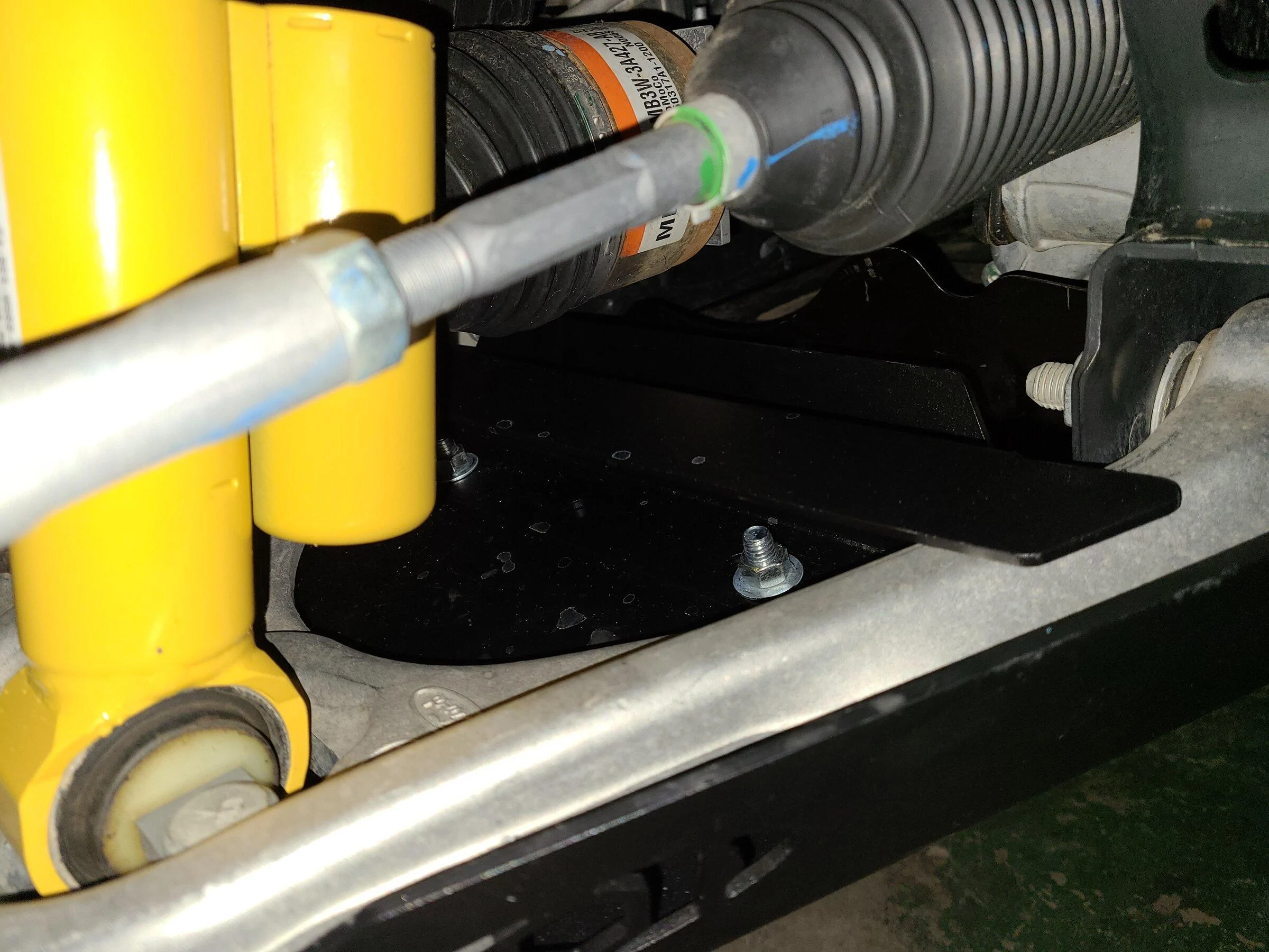

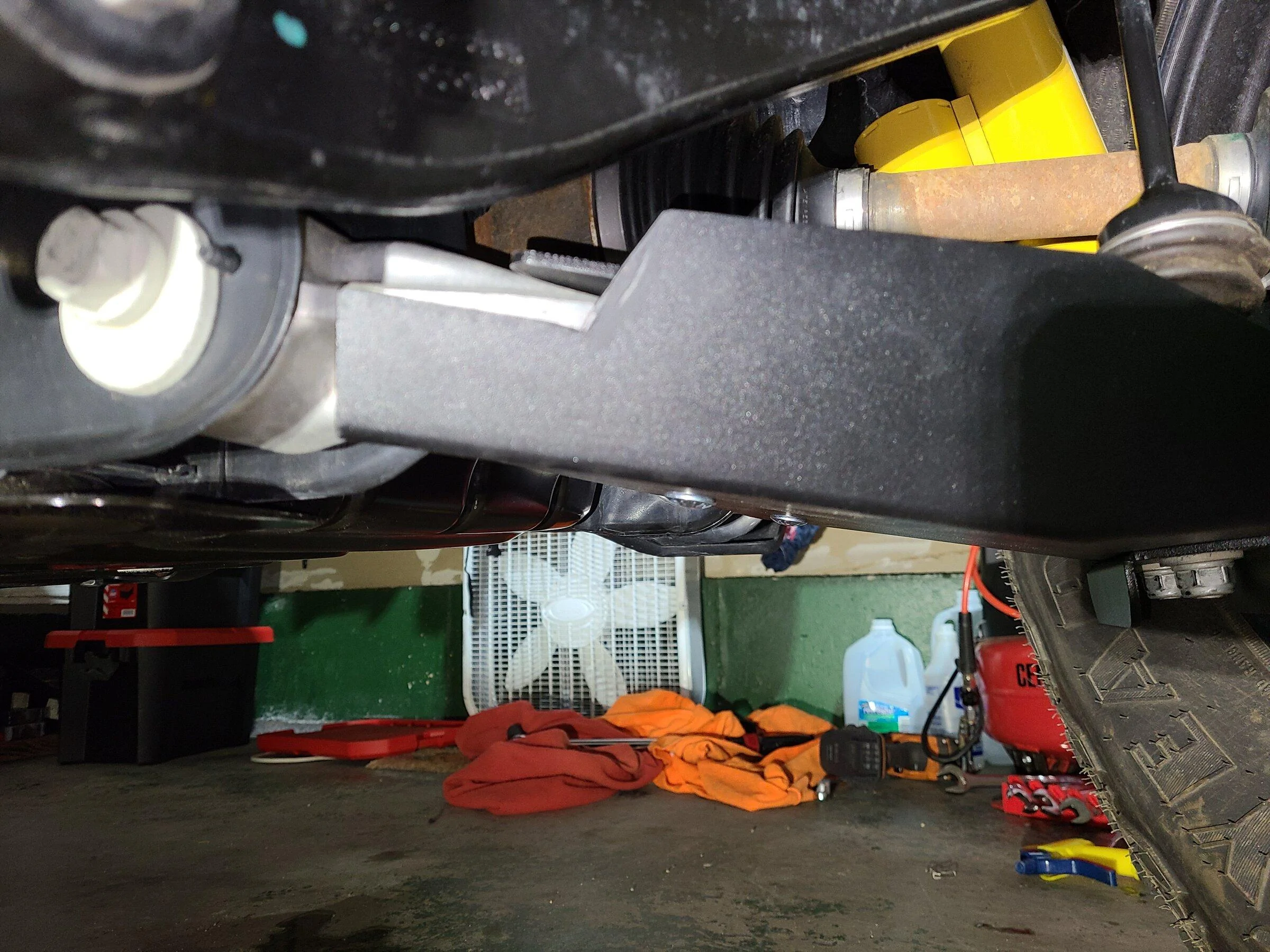

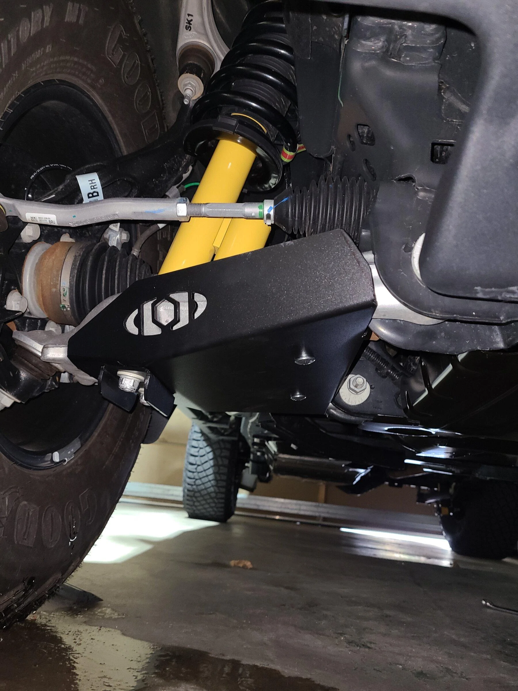

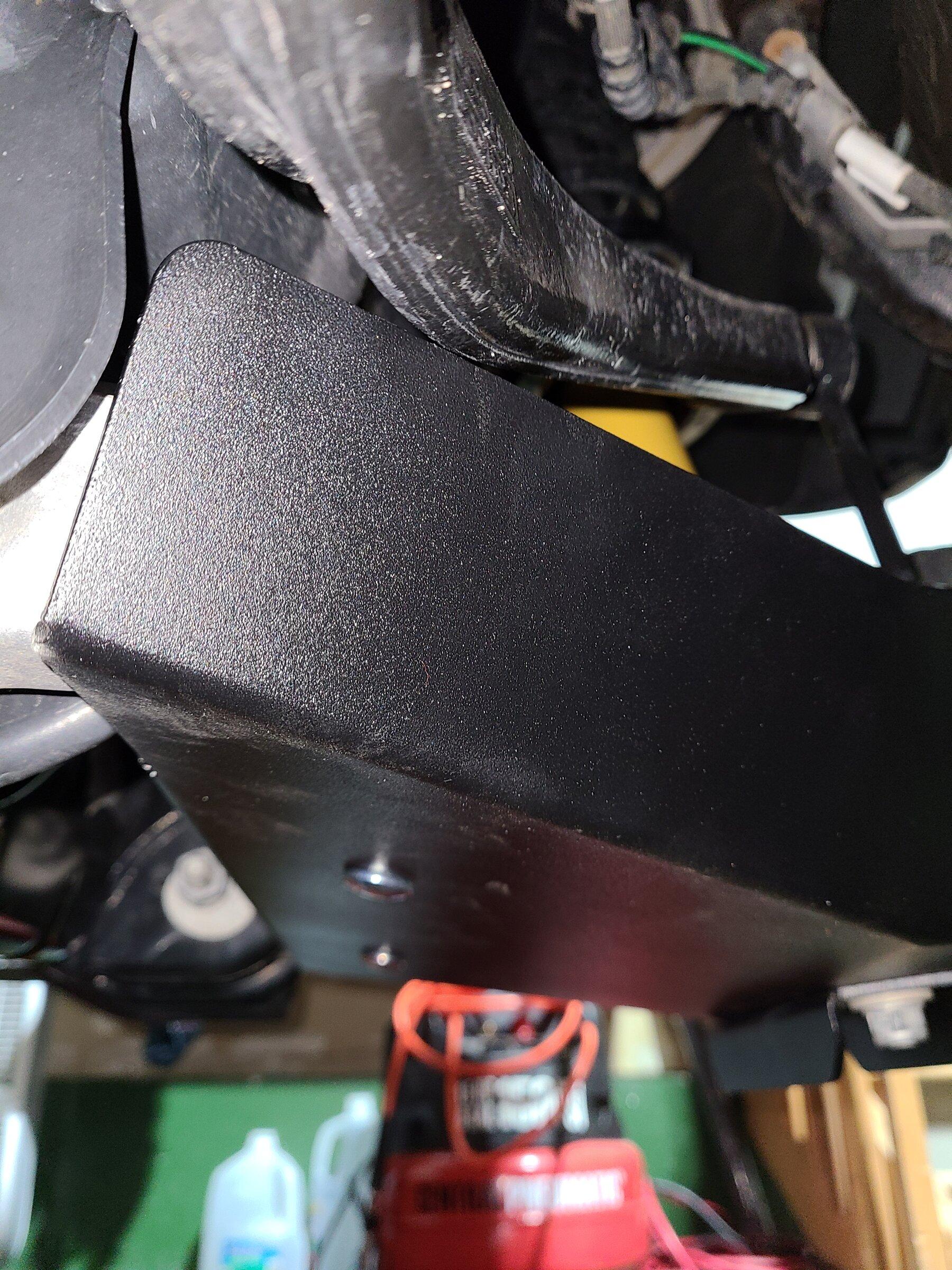

So kit came in fast! These skids are BEEFY!
The skids do not interfere with the standard OEM ford steel skids.

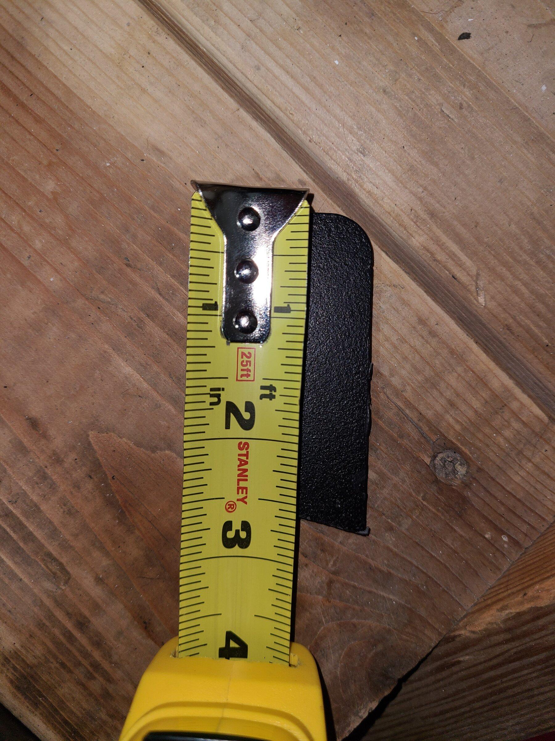

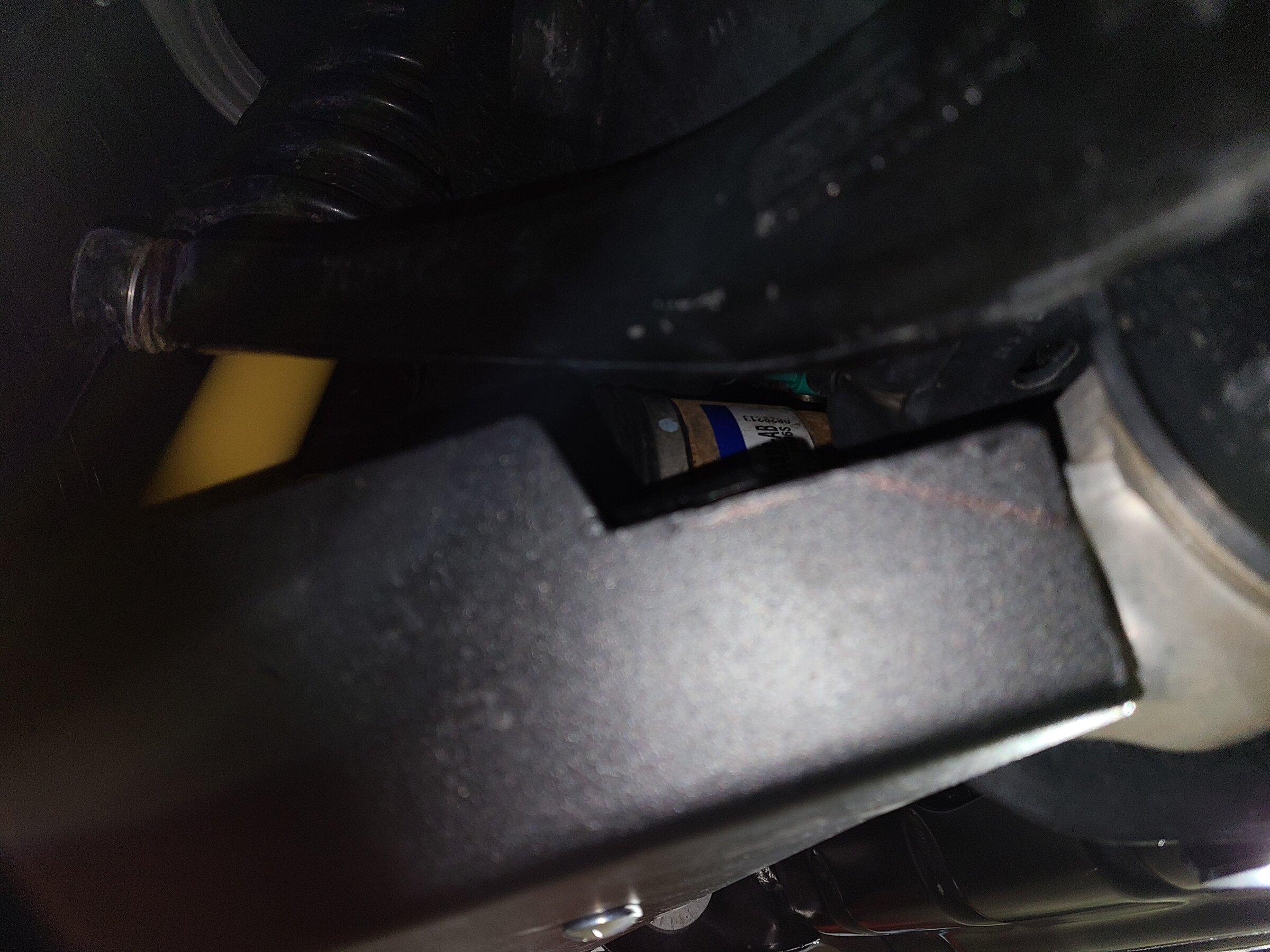

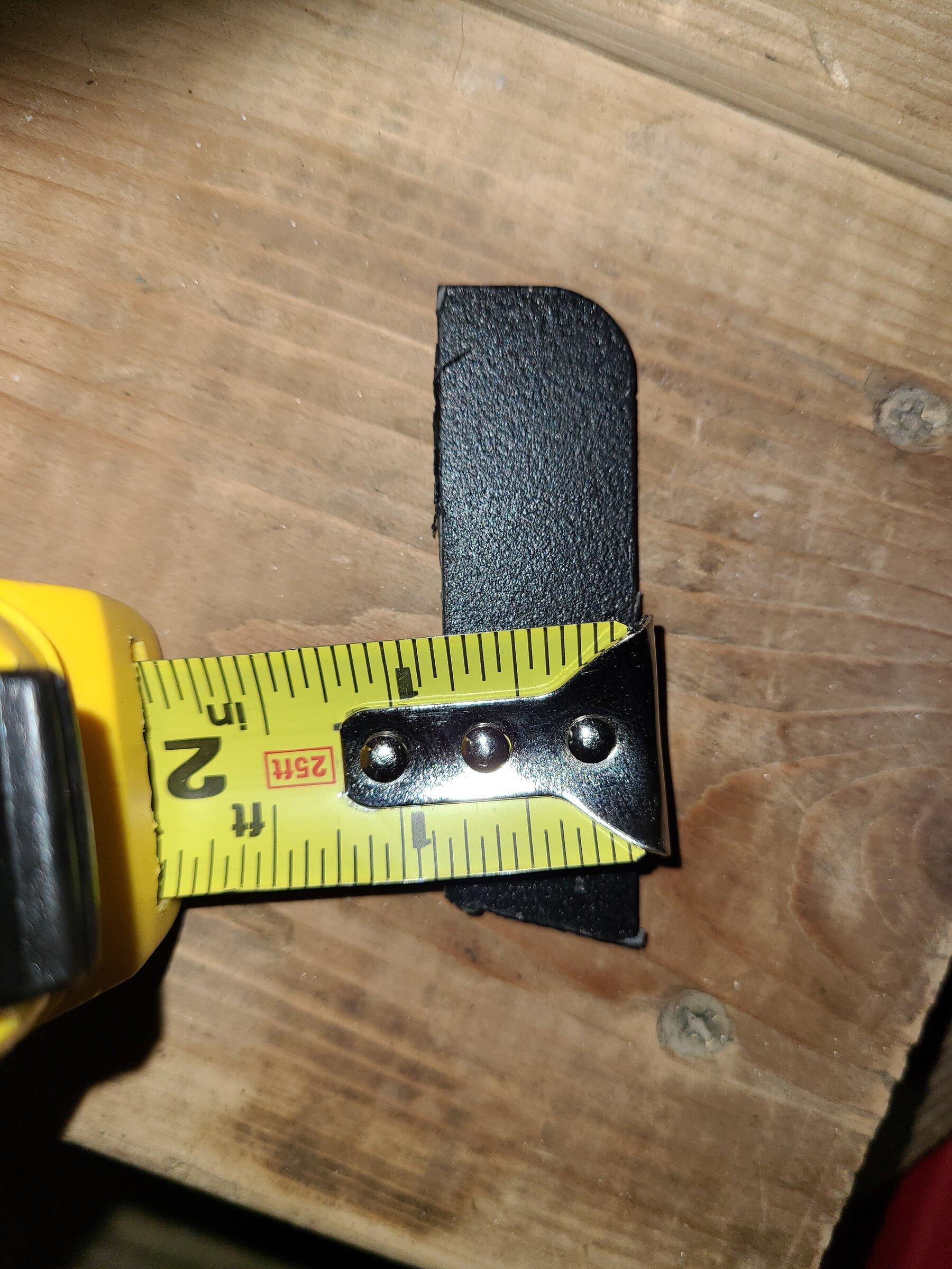

However, the skids did not have enough clearance for the disconnecting sway bar. I called LOD customer support and they confirmed the sway bar contacting the skid is a no go. They recommended me to start clearing material.
Uninstalled, cut a bit of clearance into the skids and reinstalled.
So it's not an issue of having the entire LOD skid kit, it's that these skids will not work without modification with any Badlands Broncos at this time.
Hoping the next guy can save some time off my back by reading this. Also, a drain hole would be nice.

Sorry for your trouble! Our first batch did not have enough clearance for the disconnecting swaybar. The design has been updated but a few may get some from the first batch.

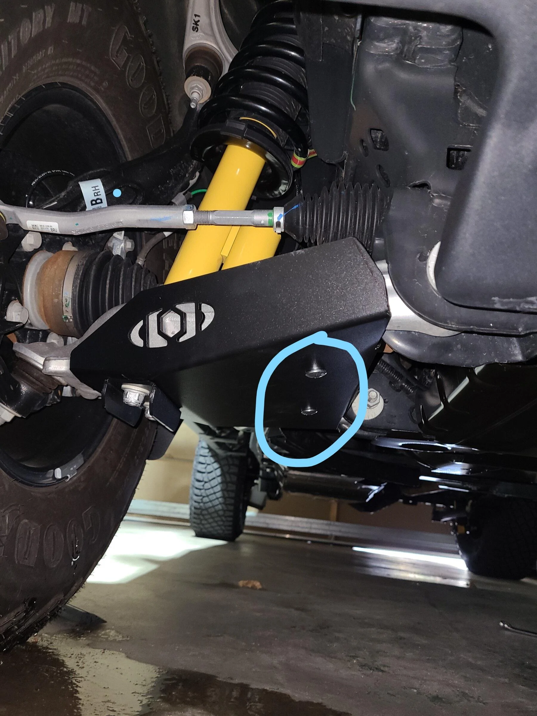

@LOD Offroad i'm curious about grinding the heads off of the mounting bolts by using these plates for their intended purpose (since they are mounted onto the "working" surface of the skid plate).
What's been your experience with this and how did it integrate into your design?

Not sure what your asking? The strut mounting bolts?

Are these structural or beauty? Full disclosure: I've not seen the upper side of these yet, just this lower angle. And don't have a Bronco to go compare against)

Press the bolts out and replace with new flipped bolts. Then you can loose the bolt guard we provide and the skid will be smooth.

Those are carriage bolts, the are nutted on from the Inside. Should have no effect on the skid performance.

Those bolts clamp the top plate as a second mounting point.
