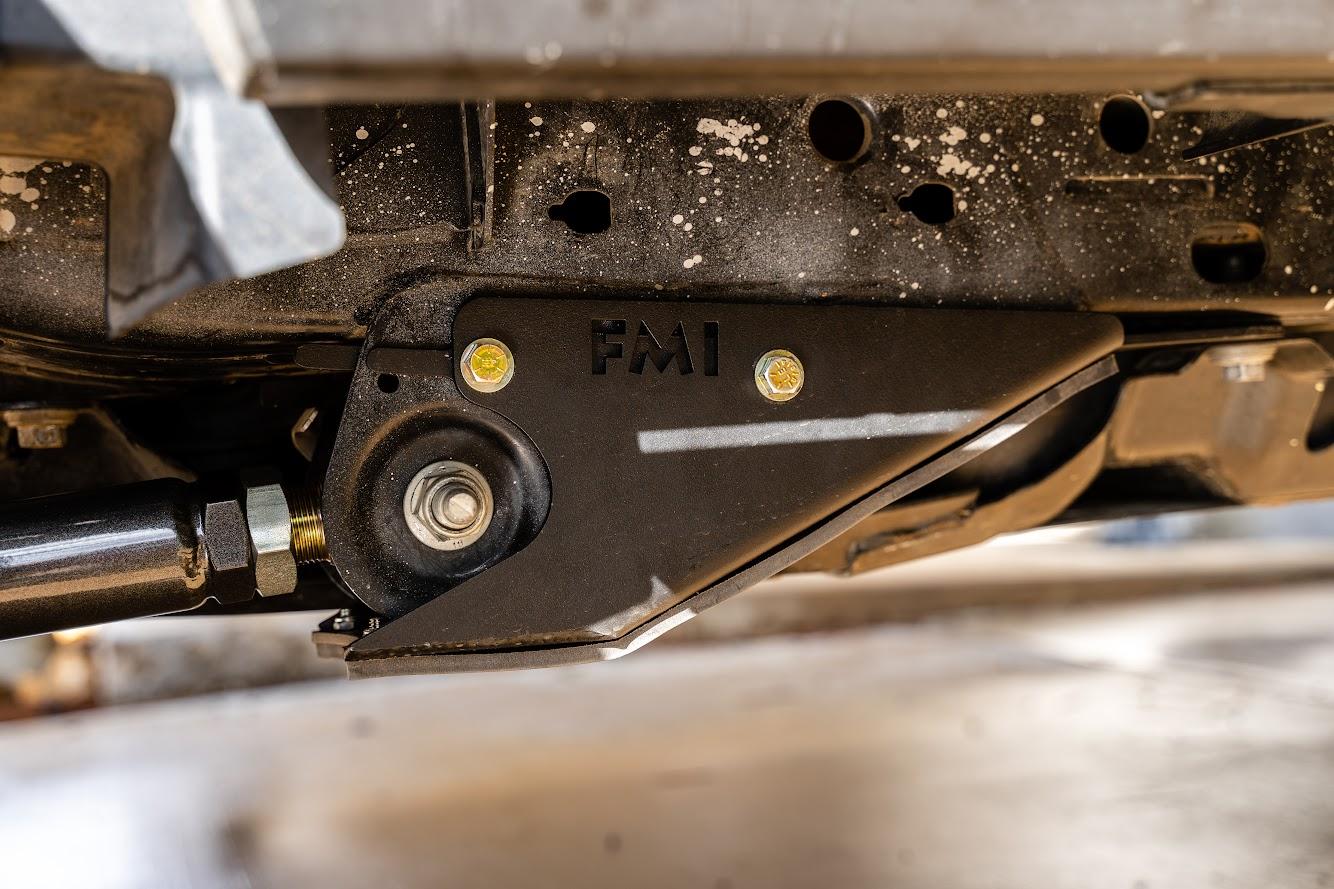

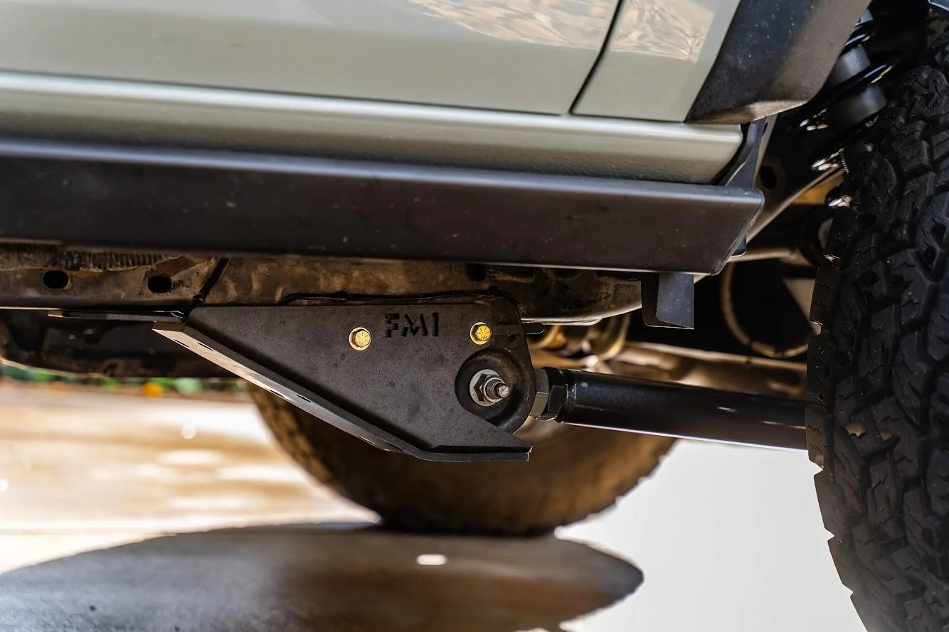

Sorry for the delay, finally got my Bronco back, and I got some time this week to finish up the install. These definitely should work on both versions, ones that have the oem welded on skid and the ones that dont. Mine does not have the oem welded skid. They are made wider then the frame and you put spacer plates on each side of the frame. They definitely designed this with the 4 door in mind though, there is a slight difference on 2 doors and I think that's why JCR says 4 door only for there's. This is for arm skids that also use the fuel tank skid bolt as an extra bolting location besides the sides of the frame, on the 2 door the fuel skid bolt is further forward then the 4 door. On my Foutz one I had to notch a small 1/2 circle slot at the end of the bottom arm skid tab so that I could pass the fuel skid bolt through. Otherwise no other issues. I passed the info onto Foutz and they were going to take a look and I imagine they might make a slight change to their design so it works out of the box for 2 door and 4 door.
