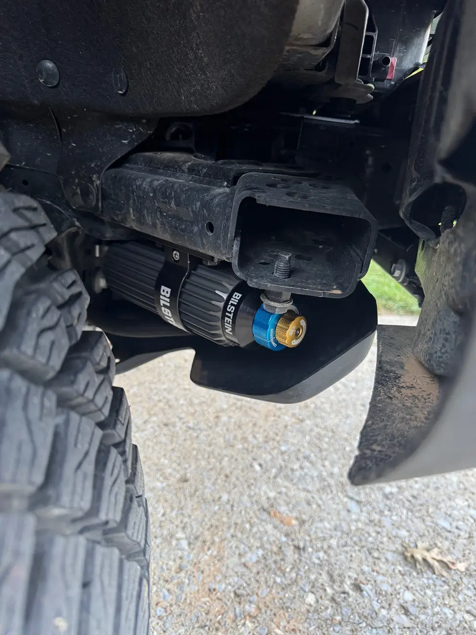

If possible I'd move this to the top.
I see why you would say that as it doesn't seem like the best spot. That is where the Bilstein install manual has them and the tolerances with the reservoir line length are pretty tight. I'm just hoping that they really did their homework with the front reservoir location because I know other kits put the front ones in different locations.

Would it reach the top of the crash bar?

The other problem with that res location is if you go 37s and get the JKS max clearance kit, that mounting location is gone.
Man you guys are really focusing on that front reservoir location haha!
I realize this particular kit isn’t for everyone’s use case, I knew going in that the 8112’s were designed for running 35’s. I have no desire to move up in tire size. This kit gave me exactly what I was looking for, a high performance suspension solution with minimal lift or need to change a bunch of components.
In my opinion there is no incentive for me to alter the way it was installed. I had a professional shop install the kit per the manufacturer’s instructions. If I have any issues I am able to at least say “hey we followed your instructions”.
