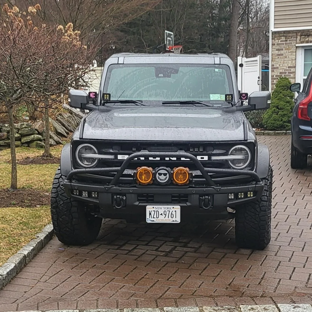

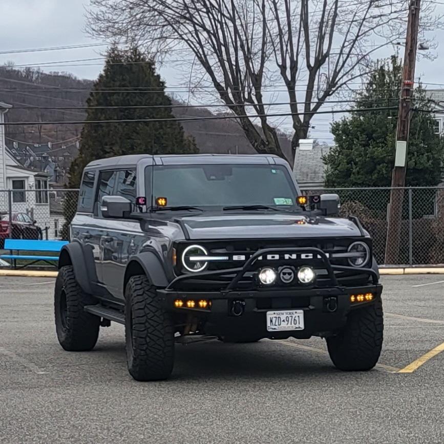

I ended mounting mine to the swarkworks bracket and buying some heavy duty L brackets to secure them. Came out perfect and super sturdy.

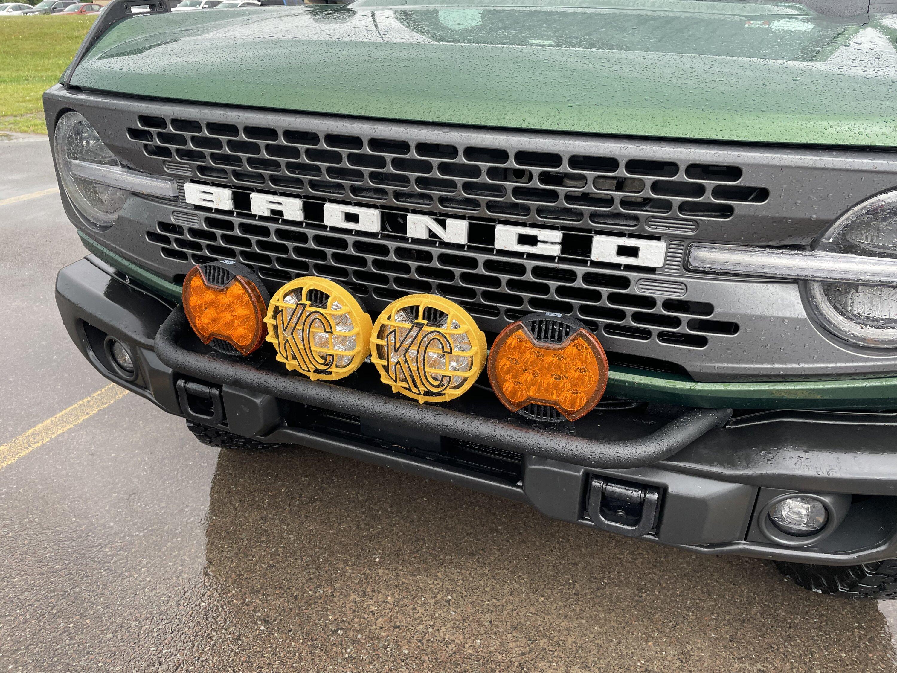

I’m not very experienced in these things, but my college age son and I put these slim lights on. The whites are aux 5, the ambers are aux 6.
Ford Bronco KC GRAVITY PRO6 BAR 8CB186A0-04C7-4274-872B-C404D5B96634
What brackets did you use? Like the look!
I was thinking about installing some extra light on my "capable" front bumper and have not found a bull bar for light mounting, or a good method to install without a bumper swap. Seeing that you have both, where did you find the bull bar attachment, and did you drill your bumper for the light install?
