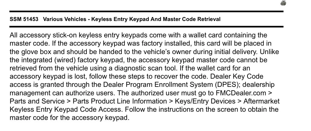

It should have come with a plastic card (credit card size) with the master code.

Look in the owners manual all the paperwork it’s a size of a credit card with a code on it

Hey guys,
I bought my 2023 Raptor Bronco about 2 weeks ago and didn’t get the factory master code. Dealer told me today they can’t help me. They claim the device is aftermarket yet the window sticker shows the accessory. The dealer tried to scan it today.
I bought the keypad after I already had my Bronco for a year. I couldn’t get it programmed and later found out I needed the code from the card that I didn’t get. However, I took it to a Ford dealer and they were able to program it within minutes.
