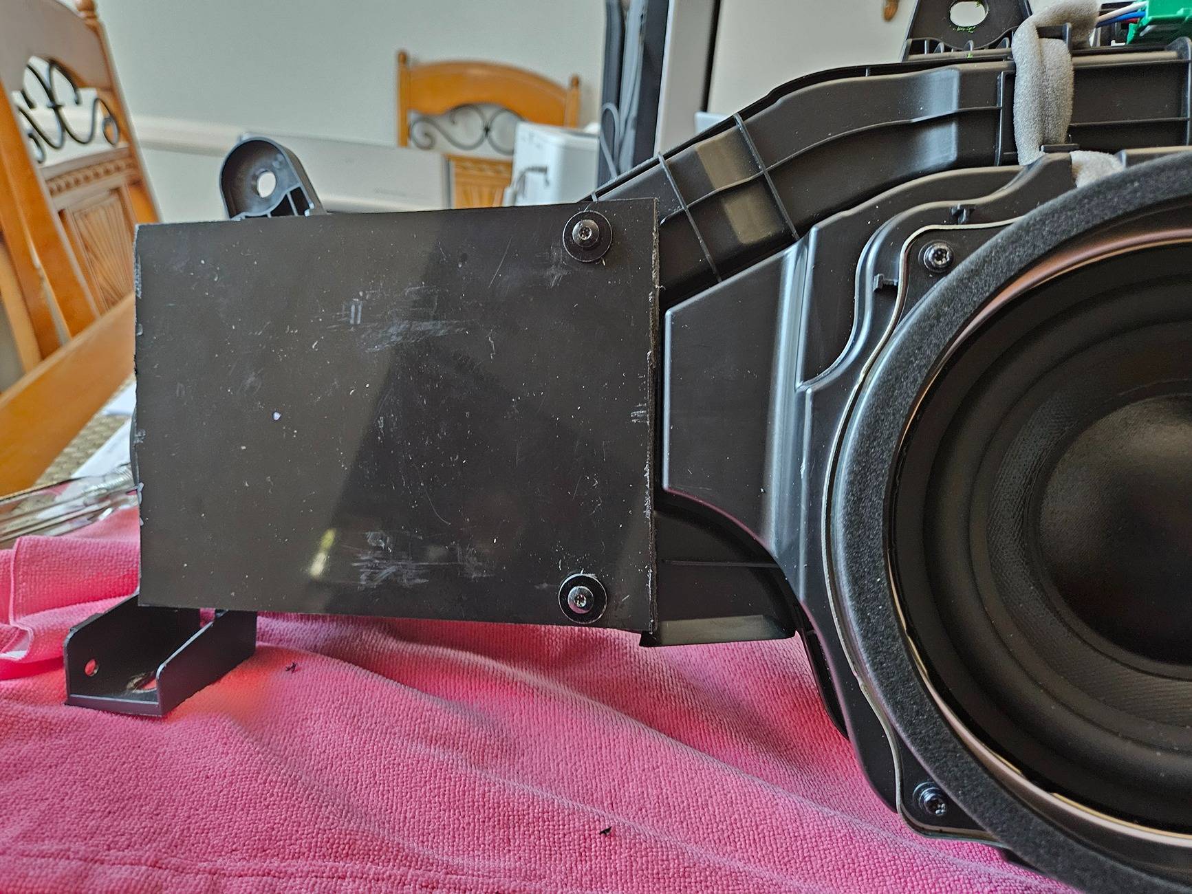

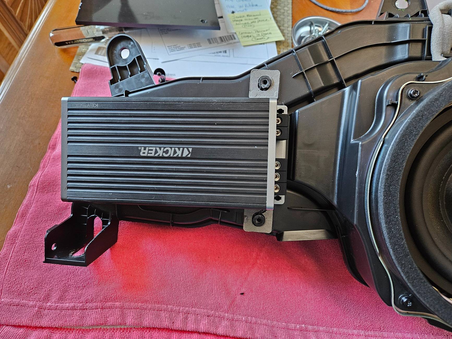

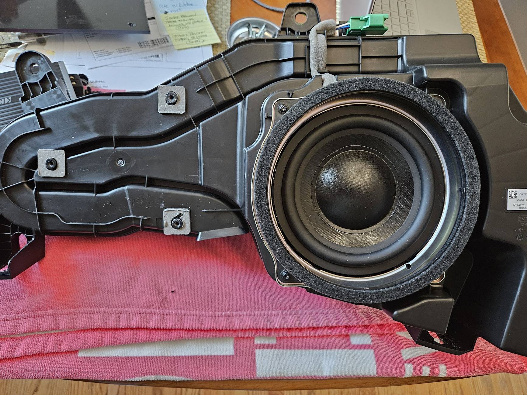

Ok so I tried the above suggestions but my sub enclosure looks different and there are only 3 holes. I test fit placing the Kicker Key directly on the sub enclosure and I could screw the front two near the subwoofer into the enclosure but the rear two are just air underneath. I also tried to fabricate some kind of plastic bracket, but if I use that I can only screw in the front two shown. If I put a screw in the third hole middle, it would push the amp up sitting on top of the protruding screw at the rear.
Frustrated and looking for any suggestions on how to mount this amp on the enclosure! Thank You.

Something similar to what I did should work. In your case use 1 existing hole though existing amp hole (upper right) then looks like 1 aluminum L bracket (lower right) and a flat aluminum bar from left to either left hole on the amp.
It will require many little bolts and nuts (nylocks preferably) and a small bit of cutting and drilling but it will be plenty stout.
Lastly, use some stainless steel pan head sheet metal screws into the sub, you can go one size larger than the factory ones to get a really good bite into the plastic.
