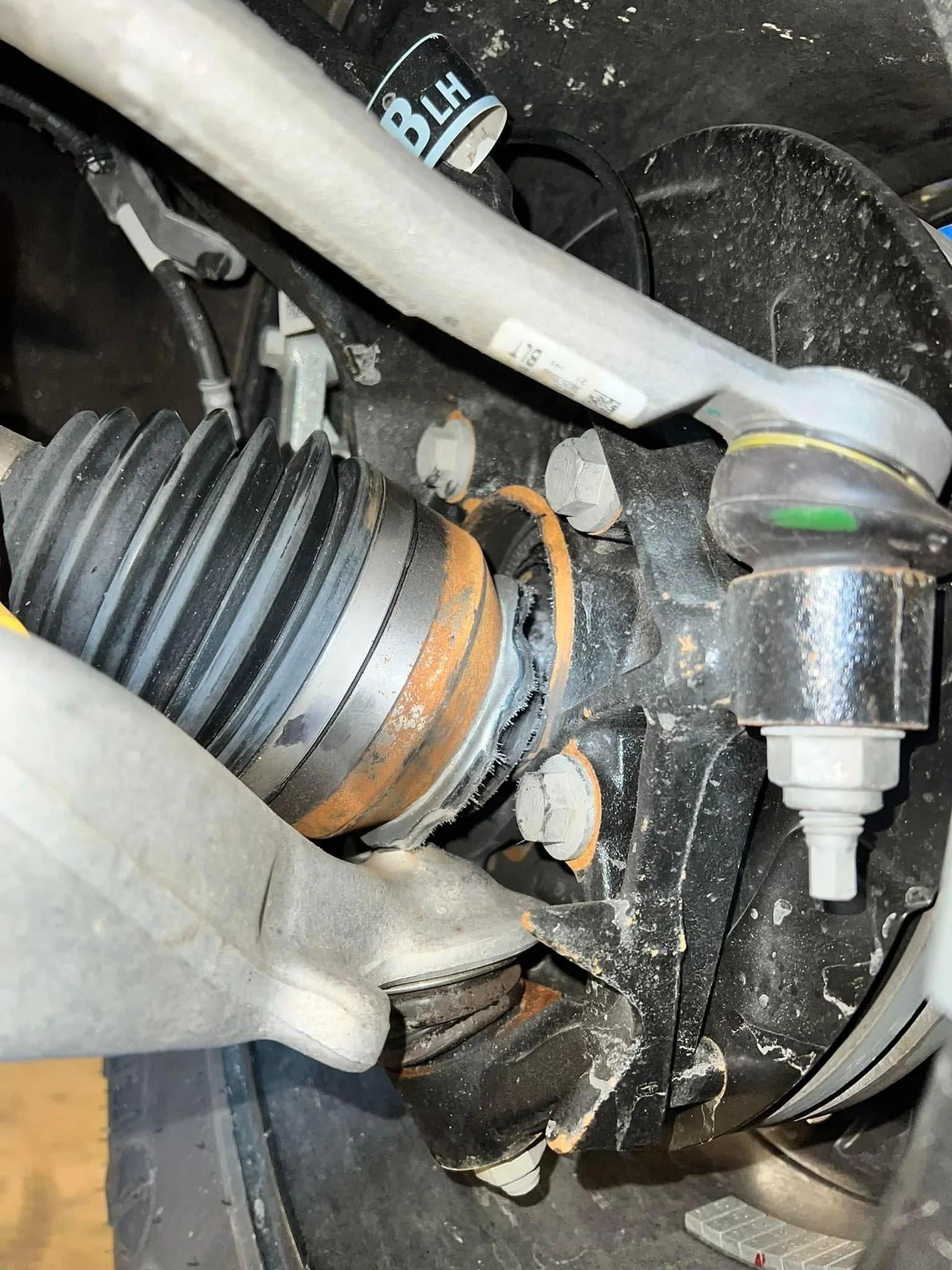

Saw this picture posted on one of the Bronco FB pages.
Ford Bronco Leaking Front Axle?!! FF6F39DB-44E6-45E2-B1FD-237AF34B364B
