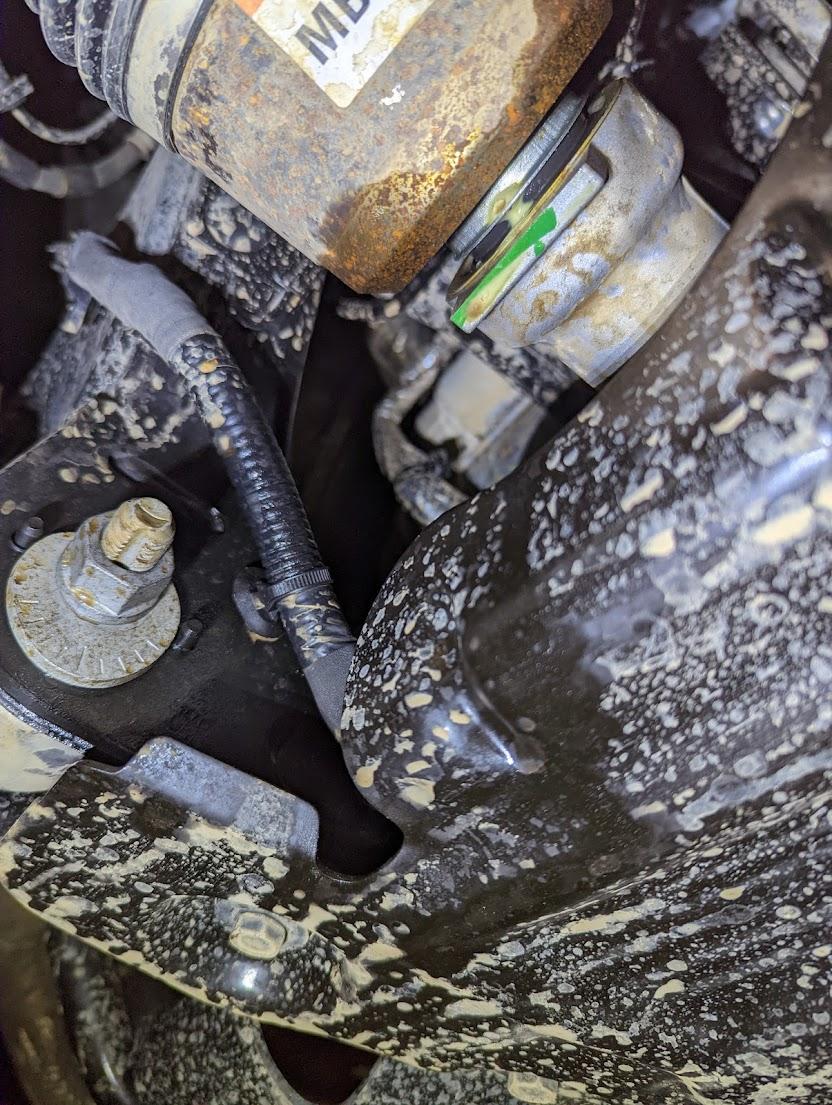

2021 Badsquatch, not even 100 miles yet, noticed small 2-3" wet spots on the shop floor but dismissed as from my son's Volvo for a couple days until I saw at work as well, checked under there and crap, leaking. Fluid *was* clear on the floor and when I checked yesterday, this morning I go to take a photo and it is *milky*, WTF?! That's new, and not at all worrying (PTSD flashbacks to my 89 Ranger engine oil after head gasket went)
Ford Bronco Leaking Front Axle?!! PXL_20220121_164808034
Not entirely clear in the photo (passenger side btw, nothing on driver's) but definitely not coming from the axle boot, this is the axle seal (not a xfer case, right? still figuring out the layout).
No way to check fluid quick and easy that I've found so far, and this was supposed to be my drive it and don't touch it rig, pretty irked my 24 yr old Land Cruiser with 150k miles has no leaks and my brand new Bronco does, any chance this is just the seals settling in or something? (never had a new truck before)
Thoughts on why it appears milky now? Haven't been through anything deeper than a puddle, heck only used 4wd couple minutes playing with modes on a rough gravel road, think it was Baja...
Advice/suggestions/things to tighten or try or test before I resign myself to bringing it to the dealer?

Minor bummer. Don't mess with it, take it in for warranty repair.
Milky means mixed with with water and maybe salt too IMO. Post back and let us know how it goes please.

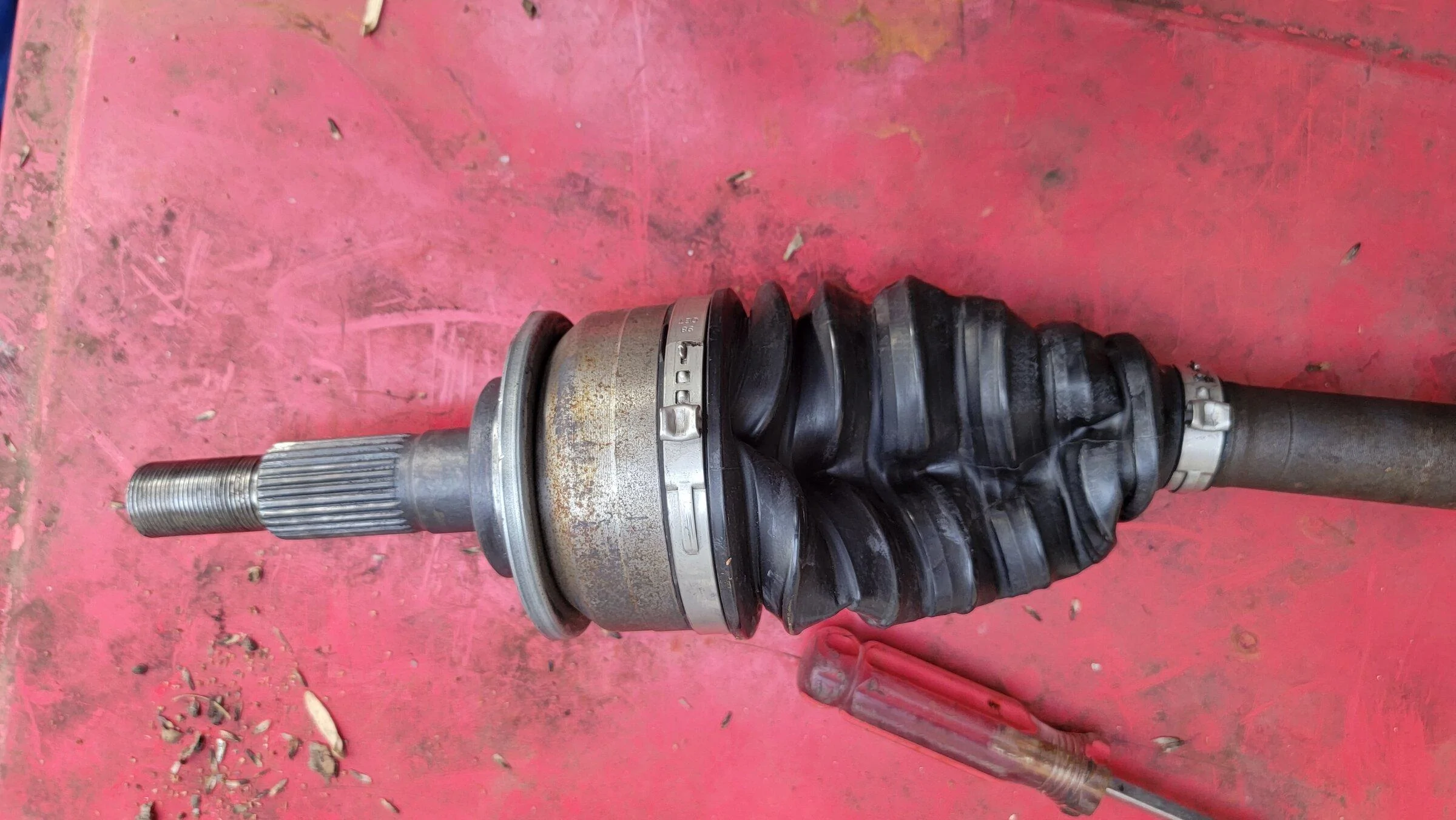

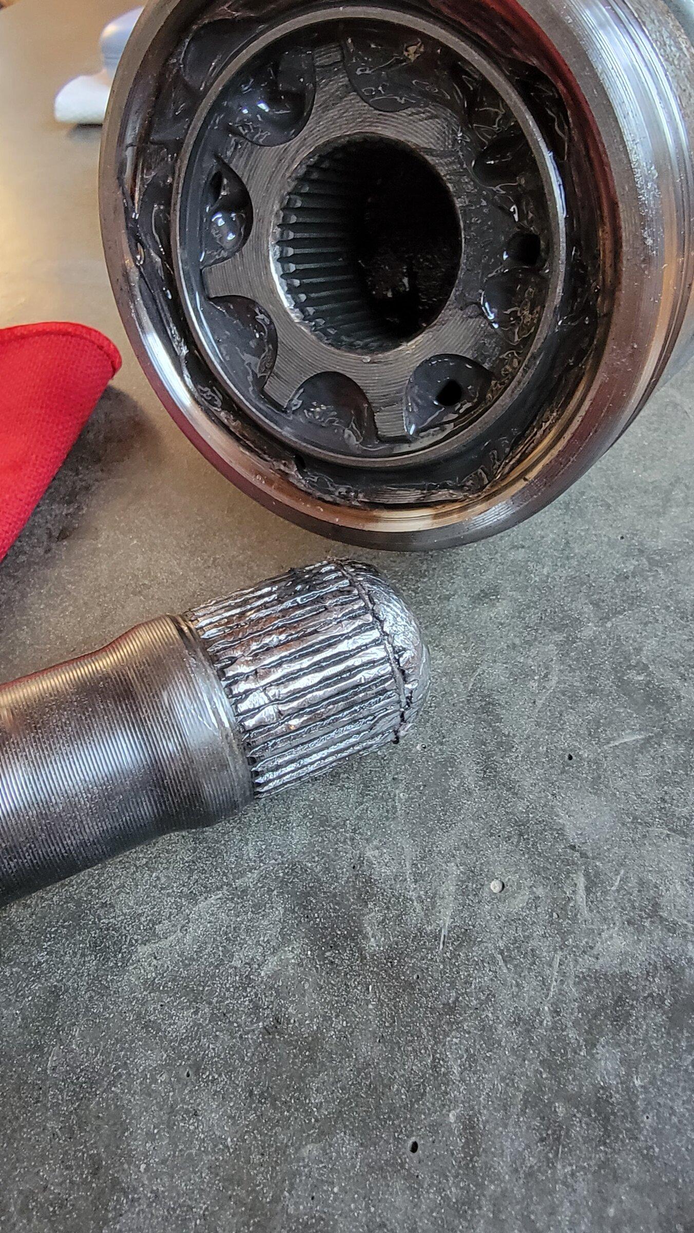

My wife got hers back and this is what was hiding inside the boot. Axle was never seated inside the outer joint. Ours did not have circlip installed and didn't give a clue until the first time I attempted 4x4 on gravel parking pad. Dealership declined the warranty and blamed it on 35" tires and 2" rough country spacer lift. Waiting to hear from Ford Corporate. They will know, with all the replacements across the country, there is an issue. How many CV axles were manufactured without circlipls and which axles were affected.
Ford Bronco Leaking Front Axle?!! 20220201_084134
Ford Bronco Leaking Front Axle?!! 20220131_164708

Yep, I was going to say. Hopefully this is because it wasn't fully seated and not that it pulls itself out and strips during articulation.
