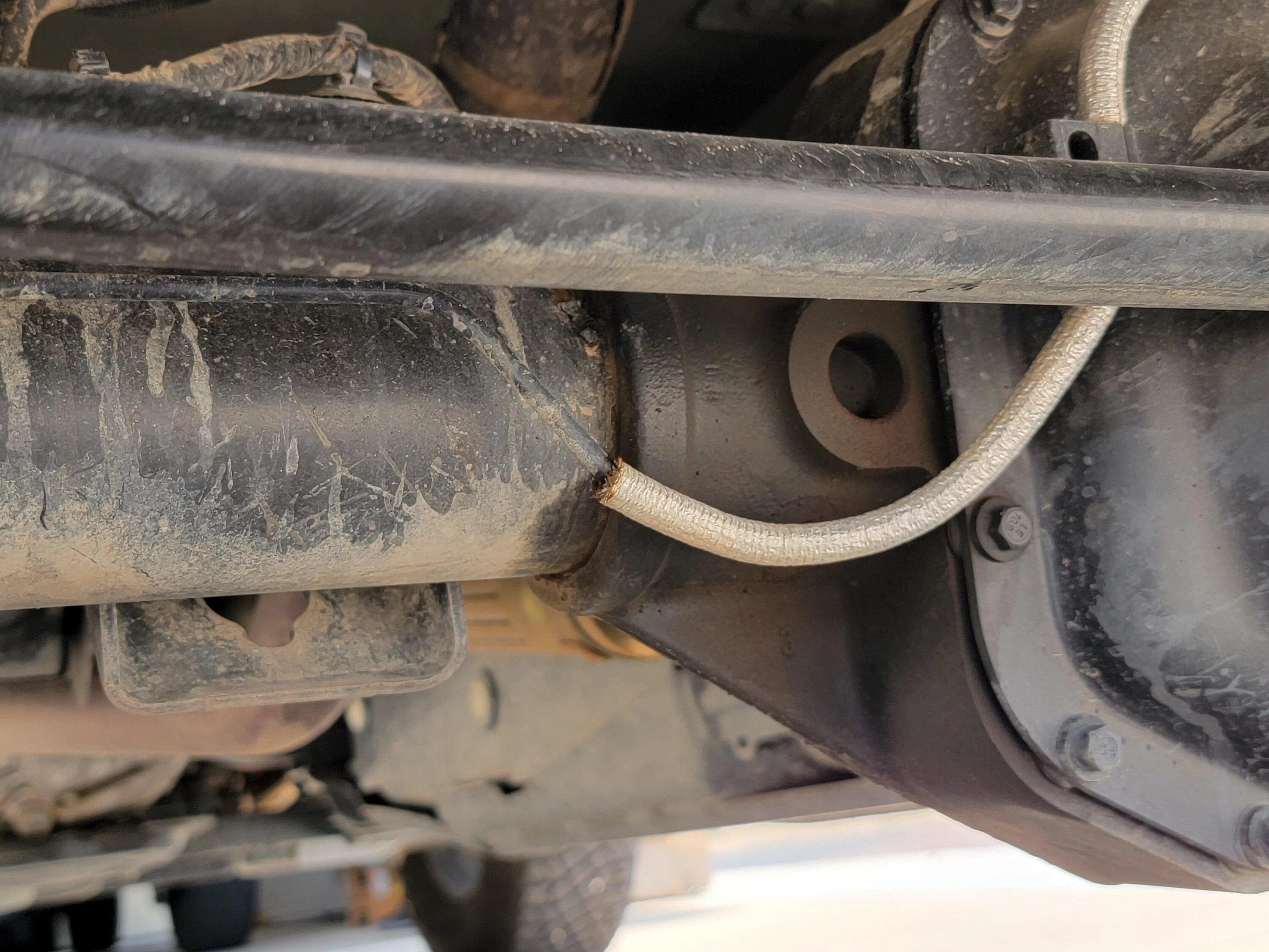

I'm pretty sure this is rear end is leaking.
2021 Badsquatch. I never used the trail turn assist.
Ford Bronco Is this rear axle leaking? rear axle 1
Ford Bronco Is this rear axle leaking? rear axle 2

It looks like oil is seeping out every potential opening, cover, plug and locker wire. Any dops on the floor? Maybe the vent ts not functioning and pressuring things up when warm, I'd check vent and/or take it in.
Nothing on the floor, just around the housing.

See any of this at the axle ends?
