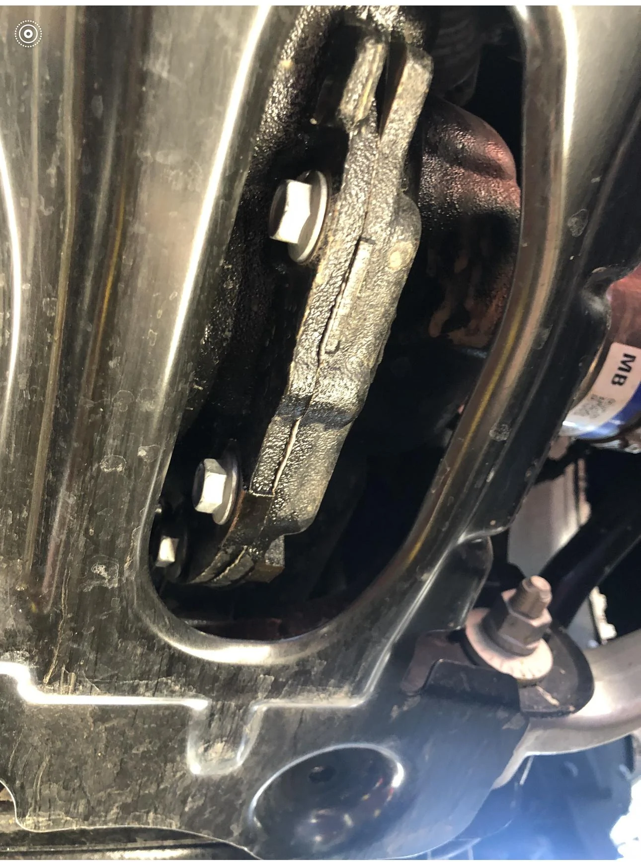

I just did my oil change today and noticed oil under there as well, but not engine oil, looked a lot cleaner. Could this possibly be the differential pinion seal yall are talking about too?

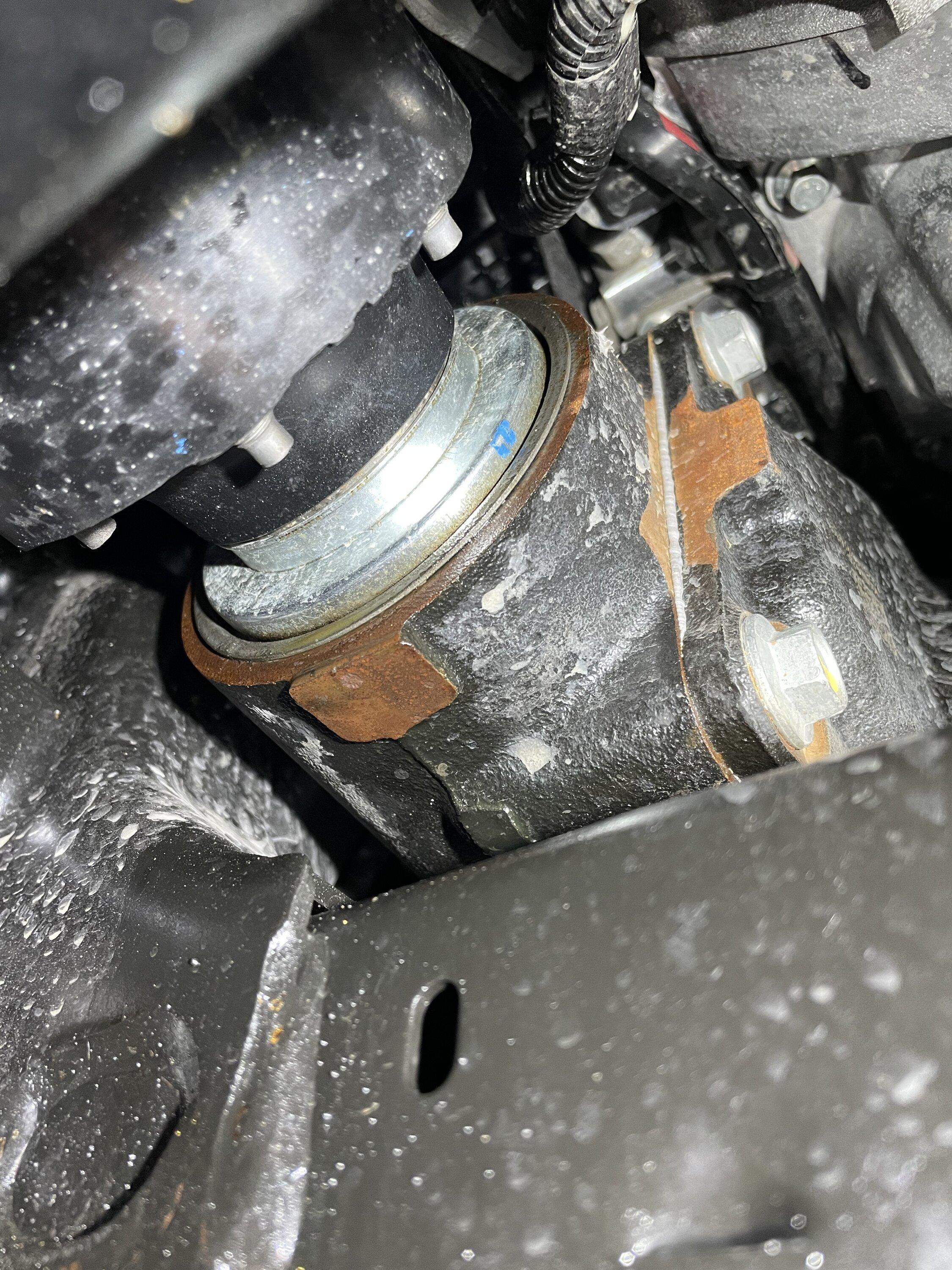

I guess I’ll join the club. 23 big bend Sasquatch 6,800 miles. I just changed the oil 3 weeks ago and it was fine.

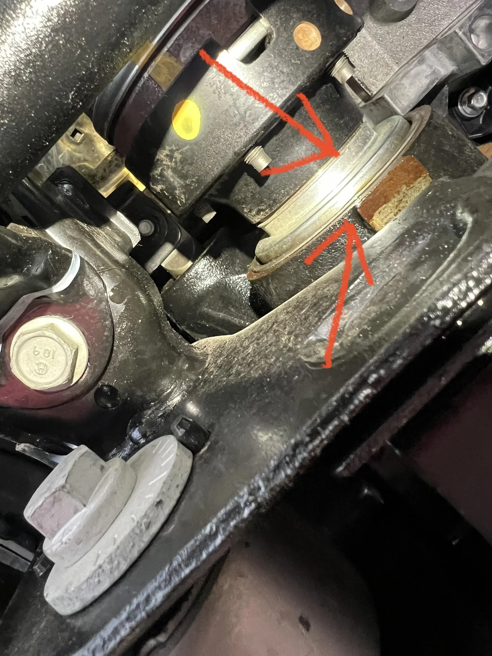

Oh boy, here we go again... The '21 Badlands has had front pinion seal replaced twice (so far it seems to be good). Now wife's '23 WT with 9k miles is leaking. It's actually more of a seep and coating the bottom of front diff and skid plate. Seems there really is some issue on the front diffs... Most people probably don't realize it unless they change their own oil and is up underneath....
