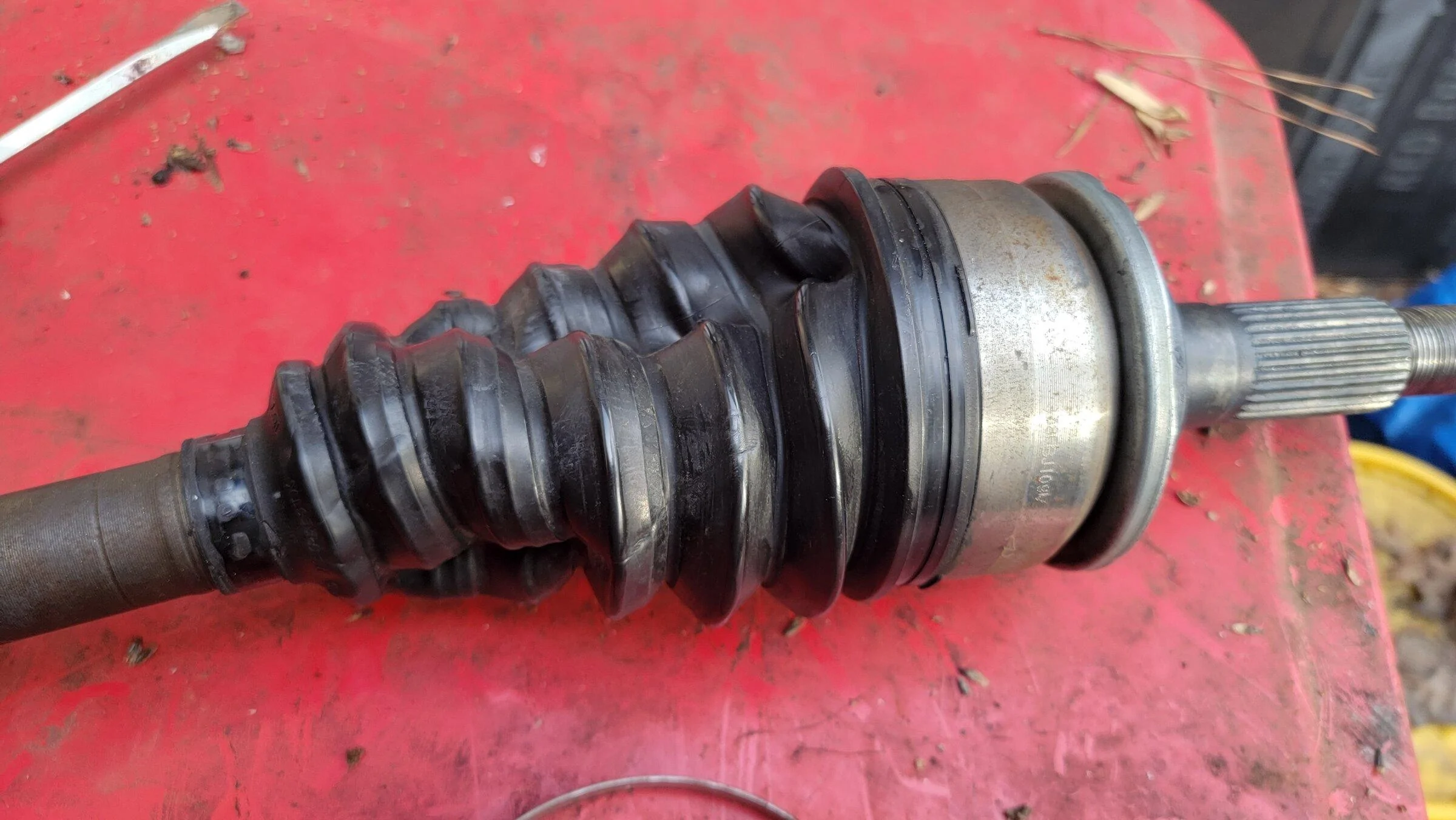

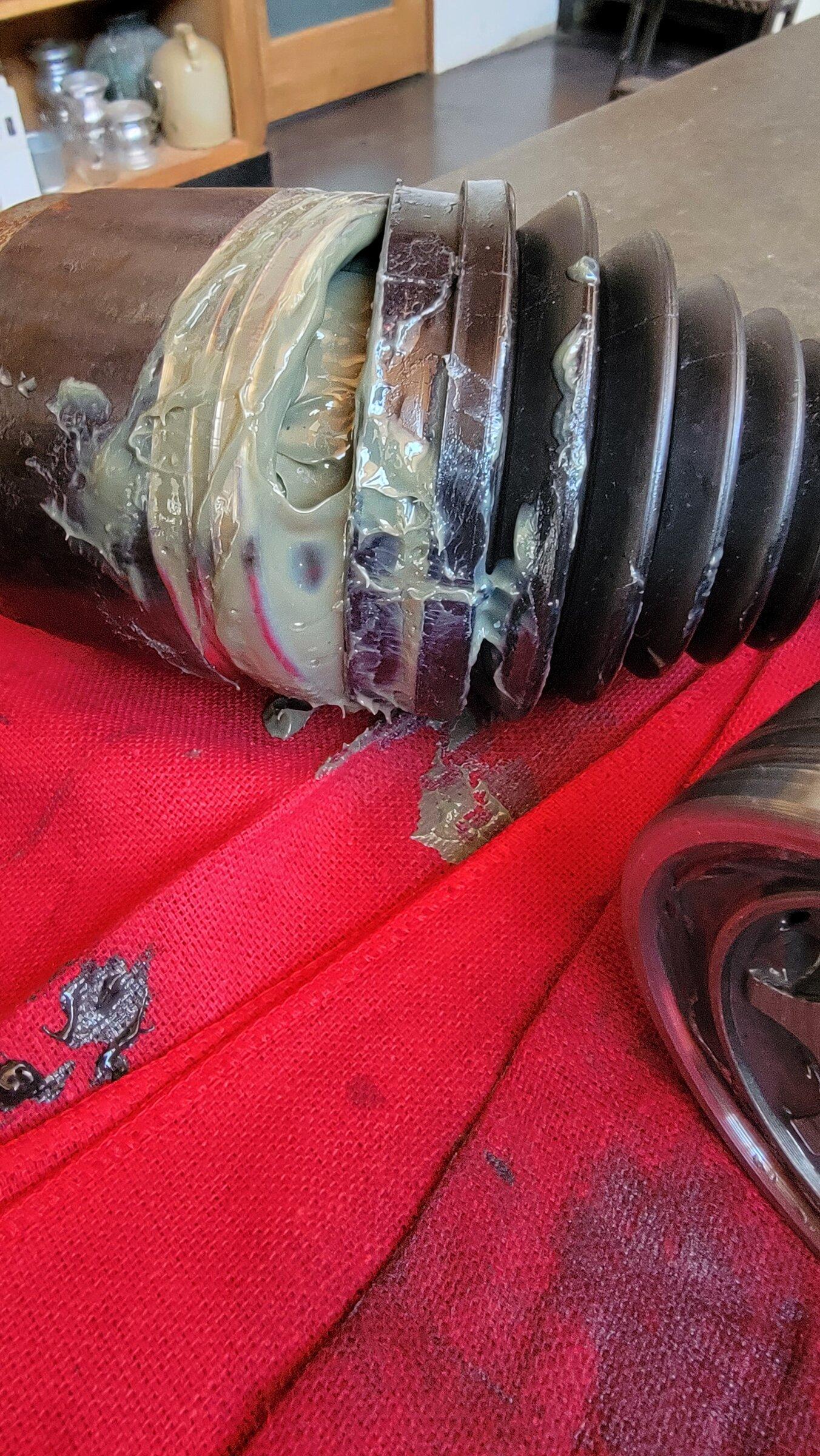

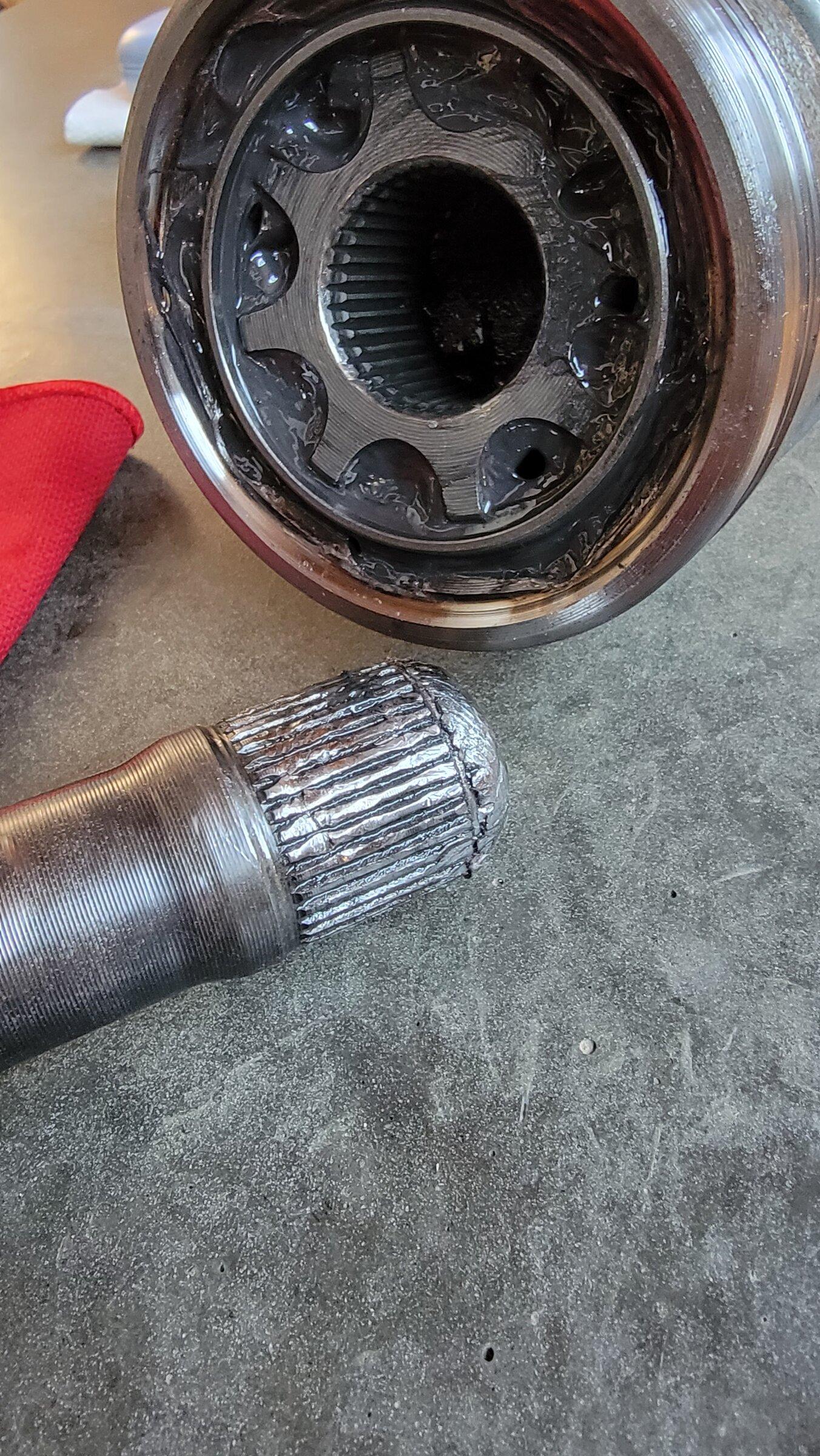

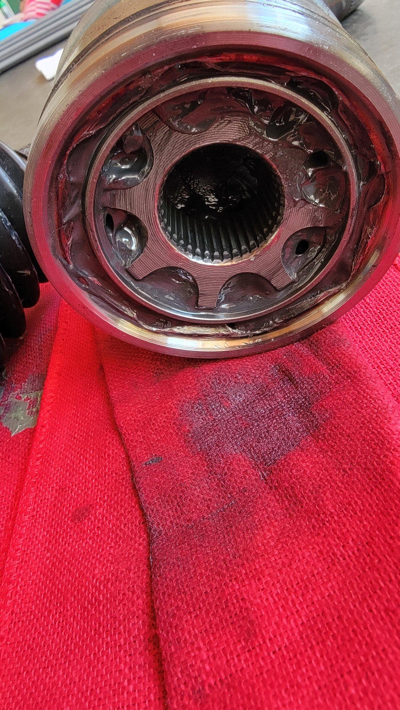

It may be limited to the CV axle. The color of your liquid is same/similar as the grease used on the inside CV joint. The outside, which is where our issue was has dark grey grease. There are many reports beginning to surface regarding CV Axle to seated inside the joint. That was the case with my wife's Bad Land. When I pulled the boots there was no circlip or the broke pieces of a clip. I predict a recall in the near future. My question is: Does my new $1,100 replacement have the clip installed.
