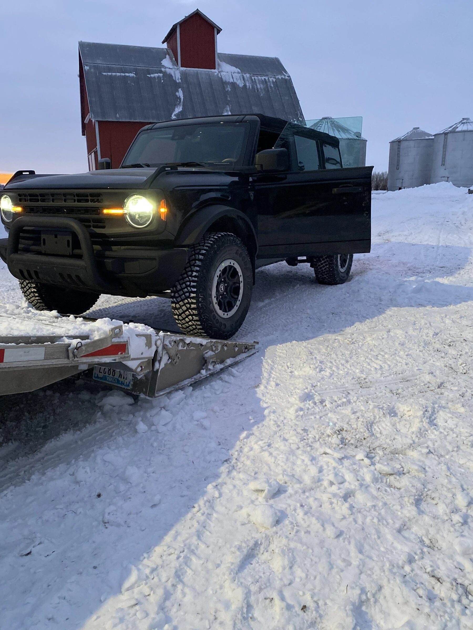

I loaded it on my trailer at the dealership so I could get mudflaps installed before driving on our gravel road. I load it up and immediately see a drip from the front differential. Assumed it was assembly lube and drove home. Got it in the shop at home, went out the next morning and had a puddle the size of a dollar bill.
Called the dealer and they said bring it back, we will get you a loaner.

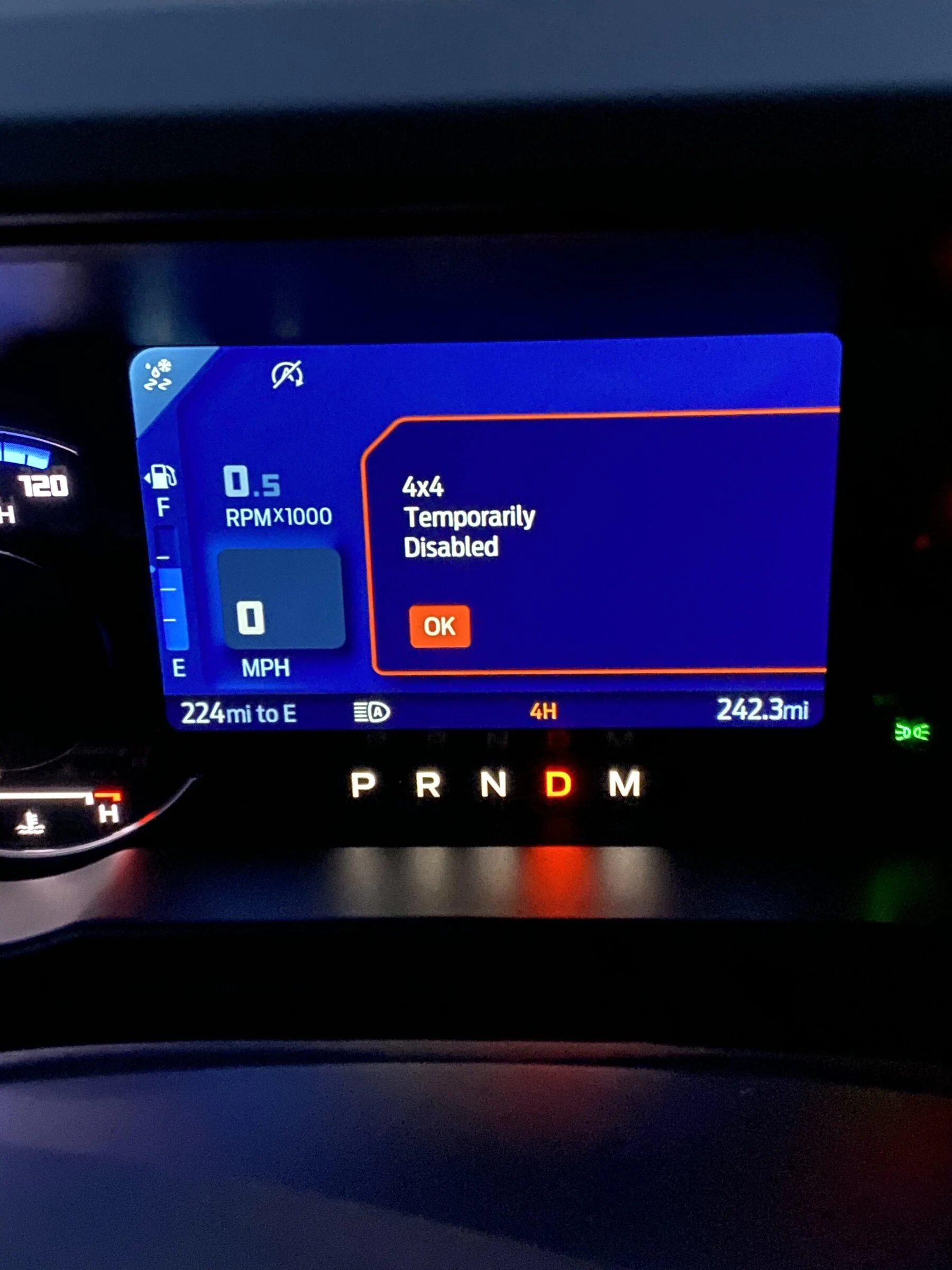

So tonight I go to load it back on my trailer again, we have snow on the ground, so as I approached the trailer, I stopped, put into N and put into 4H. Go forward, and won’t go up the ramp. Only the back wheels engaging. So I try 4L. Also, only the rear wheels engage.
So, this was the first time I tried 4x4 and will not engage. Has 242 miles. I drive 4x4s every day. Never seen this before.

Yeah, there is a T-case under there. Must not be hooked up somewhere though

You dont need to be in neutral, maybe that has something to do with it?

Why are you putting it into neutral to switch to 4H?

Seat of my pants guess is fancy sensor has detected low fluid in front diff and won't let it engage so no.go.boom.
Try putting fluid in and see if it clears.
