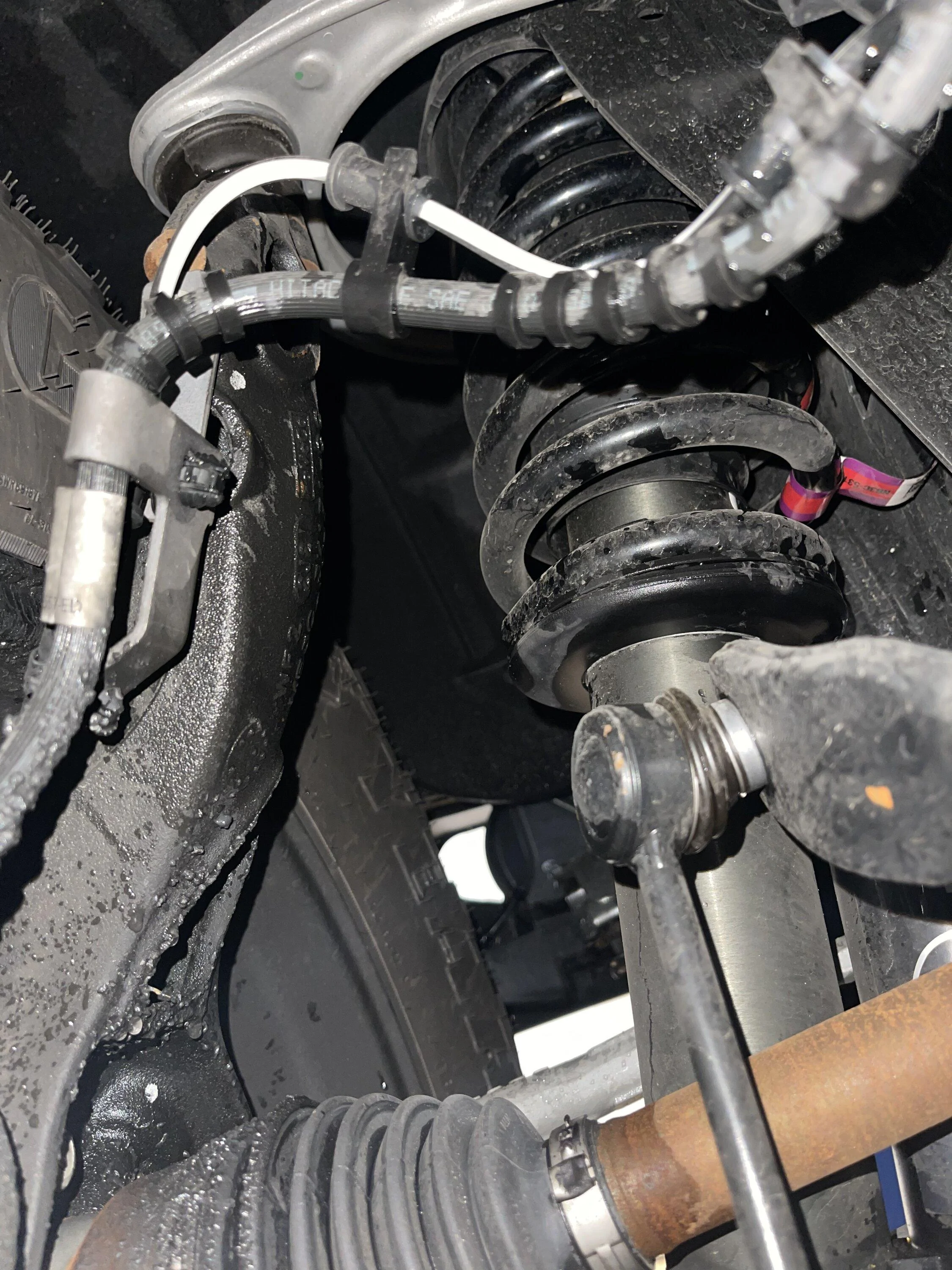

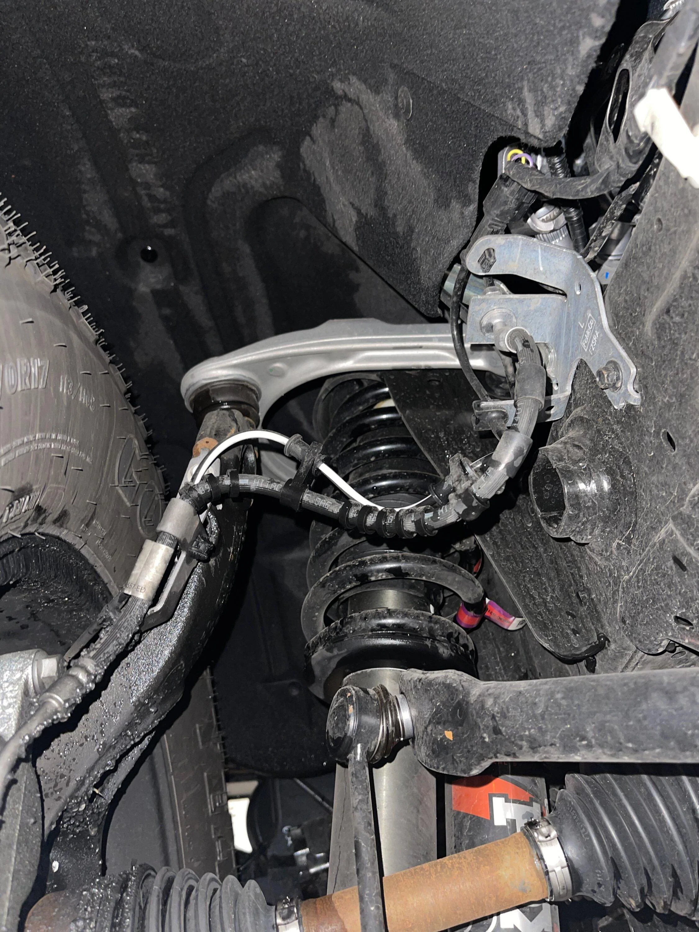

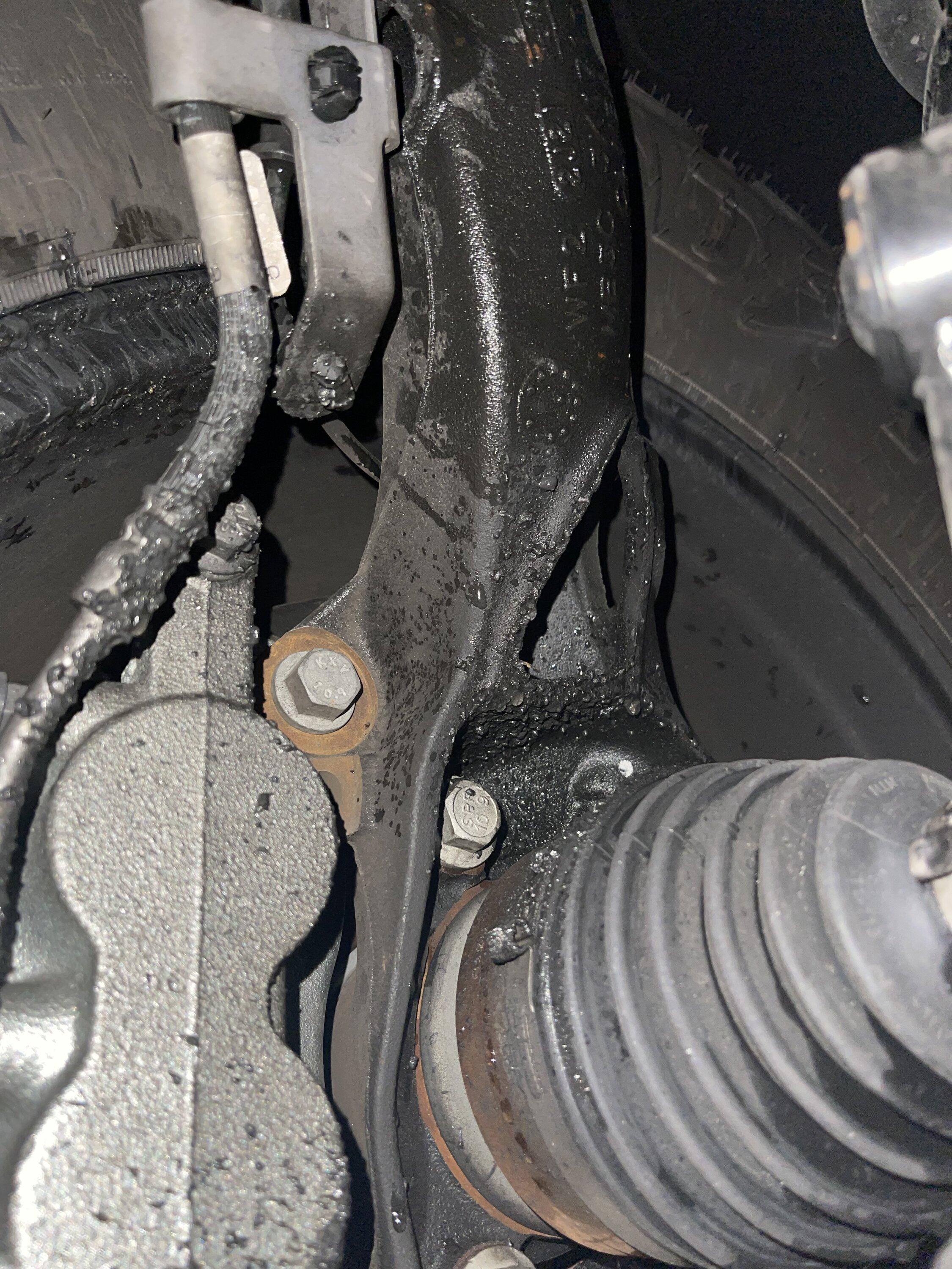

Noticed a little muck in the wheel well when I picked up from the dealer. In my excitement, I assumed - rather stupidly - it was just a bit of tar spackle from nearby road construction.
1,500mi later, I went to install some RG mud flaps and noticed that the “muck” was not tar, but grease. Seems to be flung from driver front hub area, strangely only in the rear direction. Looks like it’s coming from CV boot, but I couldn’t find any damage on the boot.
I’ll be calling the dealer for an appointment tomorrow, but curious what others think it may be.
CV? Hub?
Edit: Hmmm, looking at my own pics more closely now, I’m leaning heavily toward hub. Damn.

It's a pretty simple fix, but annoying none the less. The splits that occur usually aren't noticeable at rest but open up under articulation. It's usually cheaper to replace the whole assembly rather than just the boot. You'll start to hear clicking and clacking when they get bad enough. If there's no noise or humming, it's not a biggie to keep going till it can be addressed but it does make a mess if you don't get to it quickly. I don't know that I'd recommend driving 1,500 miles with it that way though. I mean what's the worst than can happen? chuck a wheel and see your highway neighbor catapult through the after running it over and then having it smash back into it down the highway? That'll never happen!!!

Also, good point about the articulation, I think. Even during normal driving, angle of the axle means bottom of the rotation is where CV boot stretches, which would fling grease rearward as cut/split opens then closes on the way back up.

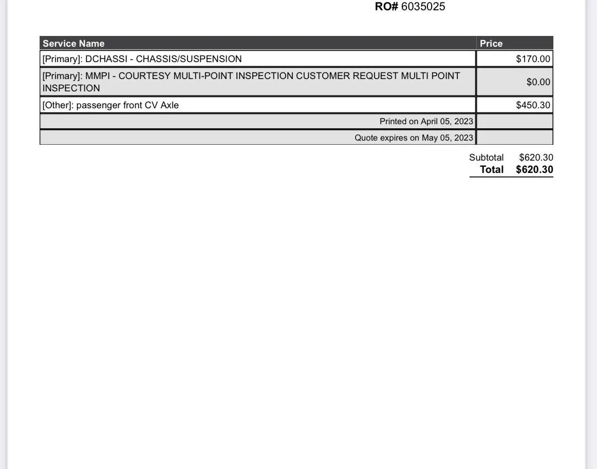

Haven’t gone and picked it up yet, but this is what they sent me. Service advisor said assembly on phone to my husband. So we will get a more definitive answer when we pick it up this afternoon. This was auto-generated, so pricing is moot since under warranty.

Yeah, looks like just the CV axle. The first two entries are probably labor to diagnose and then do a courtesy MPI.

We've seen some that either had a defect in the boot with no signs of outside damage and two that have had the outer band clamp fail.
Yeah, in my first pic, you can see an abundance of grease built up right where the boot meets the outer band clamp. Probably where the failure is.
Such defect/damage could have been introduced anywhere, I guess.
