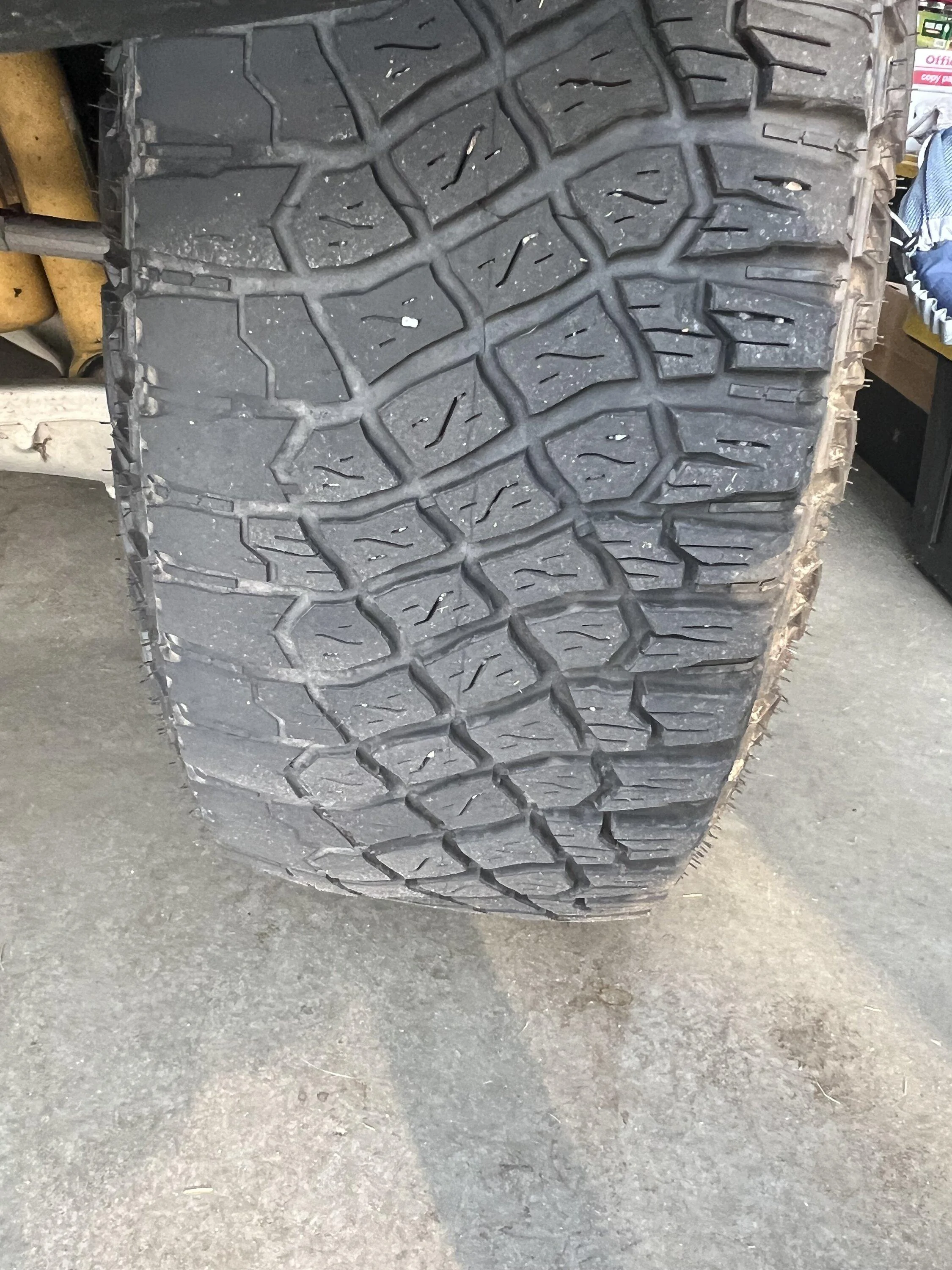

Any chance this issue would cause extreme wear to the inside of the front tires? We had our boot and drive shaft replaced in Oct 22 and they did a front end alignment. Now my drivers side front tire is almost bald on the inside

No. Replacing the driveshaft or a front CV halfshaft wouldn't affect alignment.
The alignment they performed certainly could have affected it though. Maybe they didn't adjust it correctly.

You have to pull the lower control arm bolts to do a front CV axle. Dealer should replace the tire since they didn't do a proper alignment after a job that requires an alignment.

I guess it depends how they removed the CV. There's certainly no need to remove the lower control arm to do a CV.
Just knock the upper ball joint loose from the knuckle and swing the whole knuckle down. No alignment necessary 🤷‍♂️
Either way, if they performed an alignment like they claimed to, they messed something up.

Doesn't work, only way to change a cv is pull the lower a arm bolts at the frame. Done 2 now, let not argue with how when it can only be done one way if your installing cv (broken cv practically falls out on its own).
Your right. No need to argue when I’ve done far more than 2
