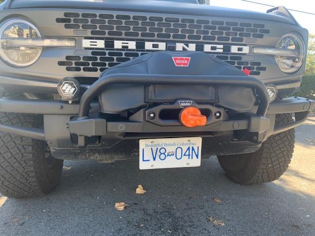

It scares me to think of an expensive piece of electronic gear hidden away with no access to clean or maintain, but it may be just me!
Up front and proud! Warn 10s with support from China...(added camera relocation shortly after the pic was taken)
