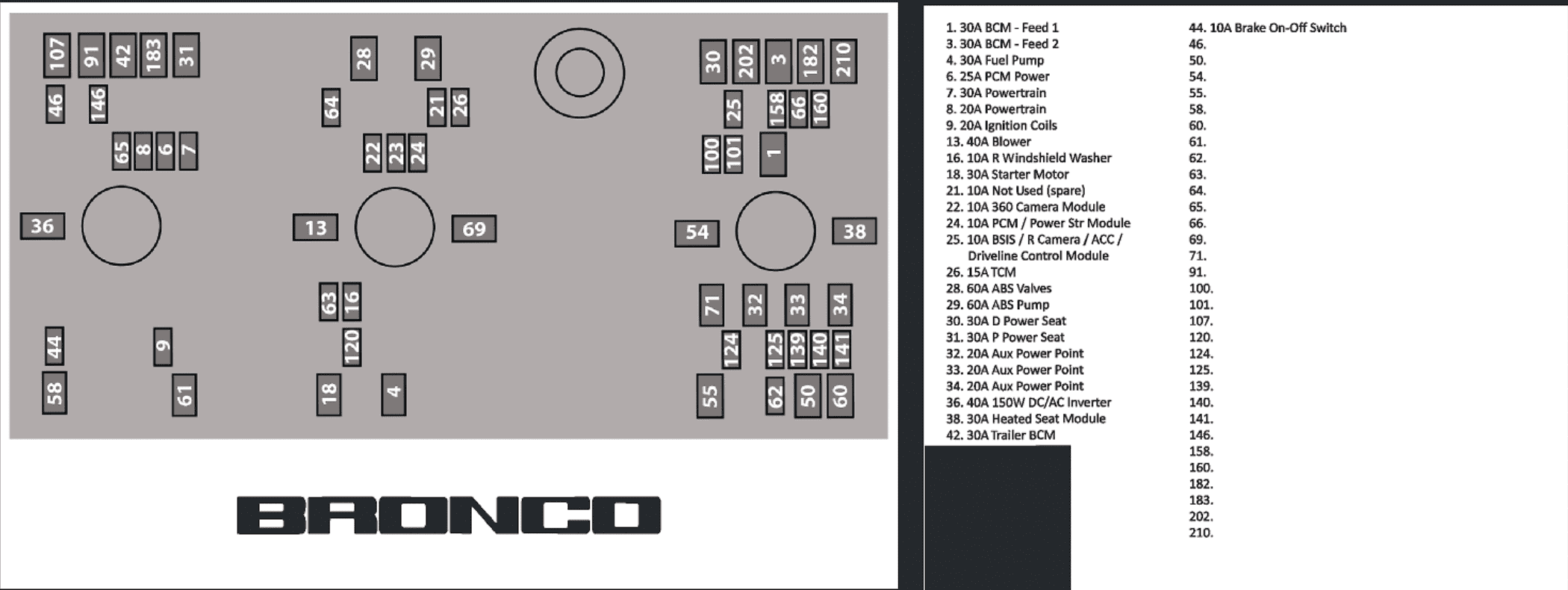

Here's a diagram of the engine bay fuse box layout from another thread in the event it helps.
Ford Bronco Looking for accessory power in engine bay 1646328732583

Hell yeah! You guys are awesome! Thanks! The diagram is what I needed.
