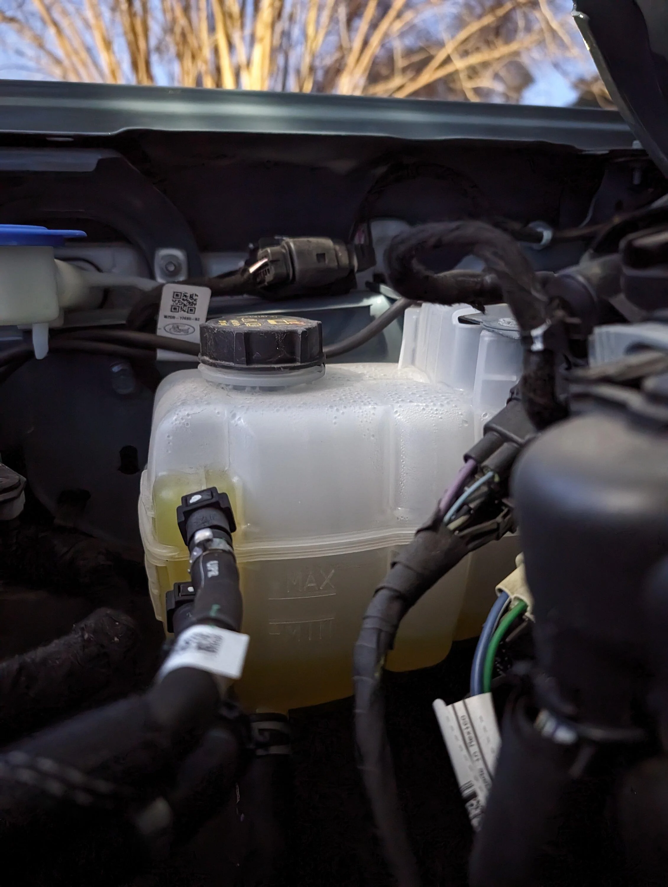

Howdy, I've got my '22 2.7l at the dealership now since I noticed the coolant was low during my last oil change. Got a gallon of the motorcraft yellow concentrate from the parts dept, but they said they were out of stock online so had to pay the desk markup. Still cheaper than what O'Reilly's was asking. I wanted to get this inspected and taken care of under warranty before installing a new Cobb intercooler along with the Panda Power Module and cooler plugs, etc. So no tune yet on mine.

The service shop said it passed both vacuum and pressure tests, so they topped it off and returned the vehicle, fyi. I'll keep a closer eye on it from now on for sure.
