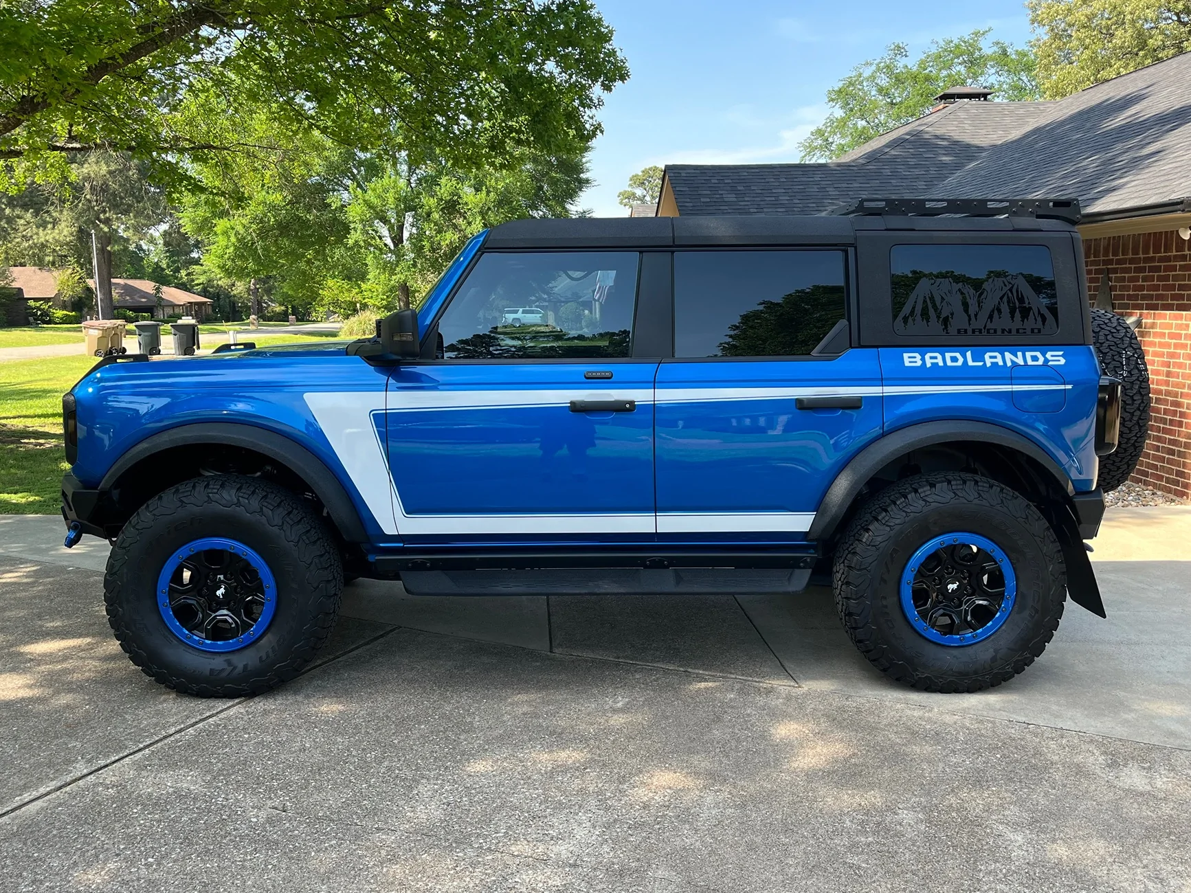

Get a set of takeoff Bronco Raptor or standard Bronco rock sliders with removable steps. I have a 21 badlands Sasquatch with 2 inches of lift and 37 inch tires and the top of the step is at 17 inches. So if you’re on 35 inch tires with no lift on your bronco the top of the step should be at 14 inches. The great thing about them is they are a lower step, but if you are going to off-road, the steps are easily removable, the step itself is extremely lightweight, and you still have the rock slider for Protection.
Ford Bronco Lower Running Boards/Steps IMG_7929
