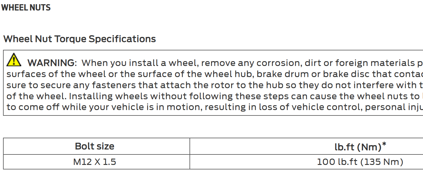

Hello, I've tried searching the forum for the lug nut torques spec but was unsuccessful. The manual supplied was not helpful either and searching the manual on the touchscreen I was unable to find anything.
Is there a table somewhere with the torques specs for the lug nuts?
I just rotated my tires and want to make sure I have it correct.
Thank you

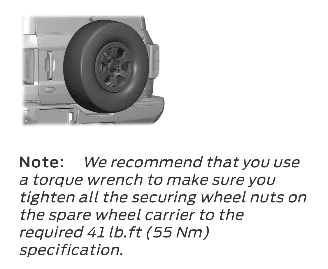

DO NOT torque the nuts on the spare tire carrier to 100 lb-ft!!! Just a PSA, the carrier is plastic and it feels like the studs will pull through if over-tightened.

Someone else on here made this handy pic which I keep on my phone
Ford Bronco Lug Nut Torque Spec PNG image

I wasn't looking for wheel nuts and was hoping it would be in the tire rotation section. I will have to check the manual again.
That's the perfect pic to add to my paperwork.
Thanks everyone

From owner’s manual…
Ford Bronco Lug Nut Torque Spec 1699301231592
