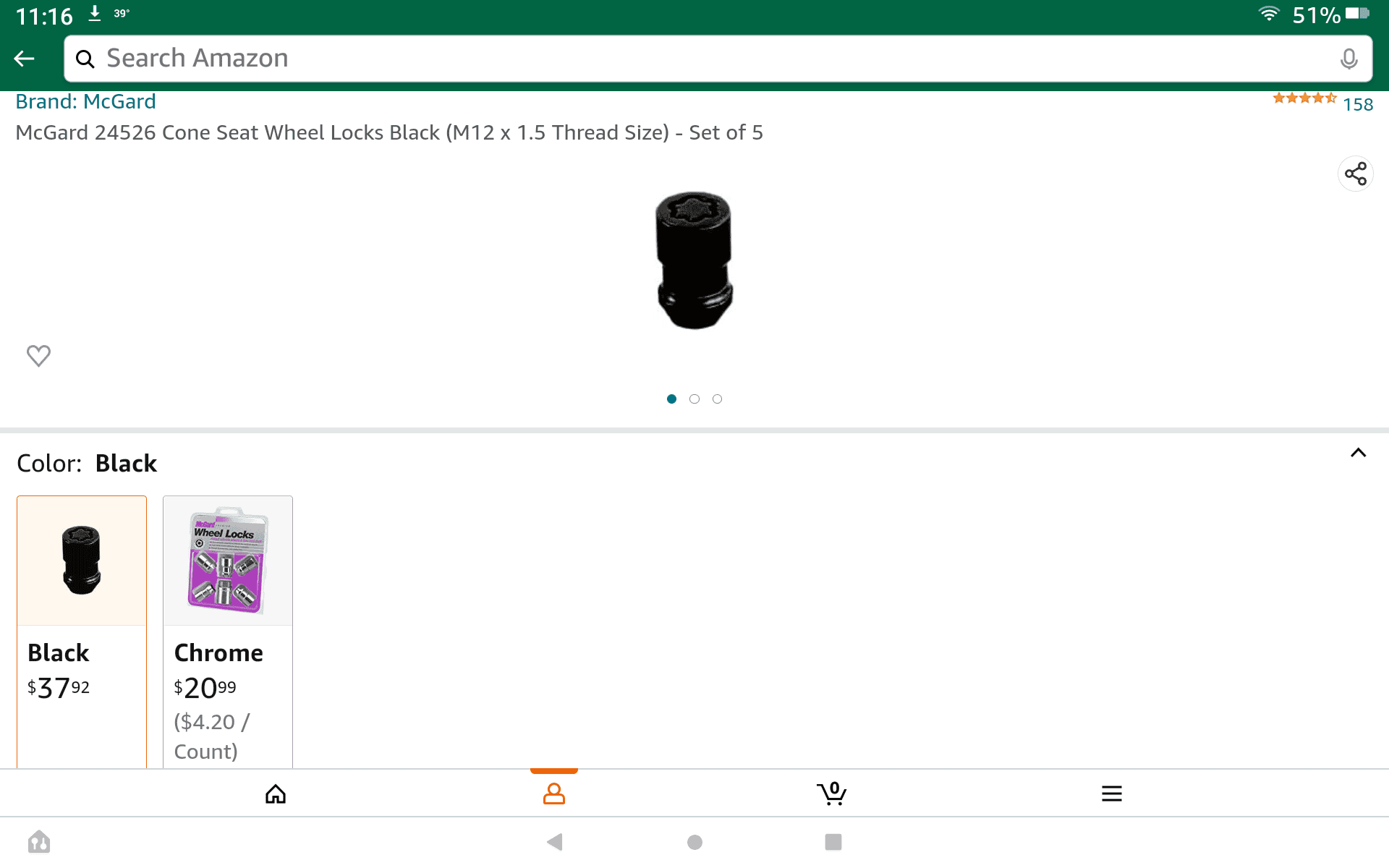

I see where McGard are American made, and Dorman are Chinese made. I'll opt for American made if I have a choice (and price is similar i.e. can afford American) and the quality is there.
Thanks for the input on both McGard & Dorman... I'm learning a lot here.
