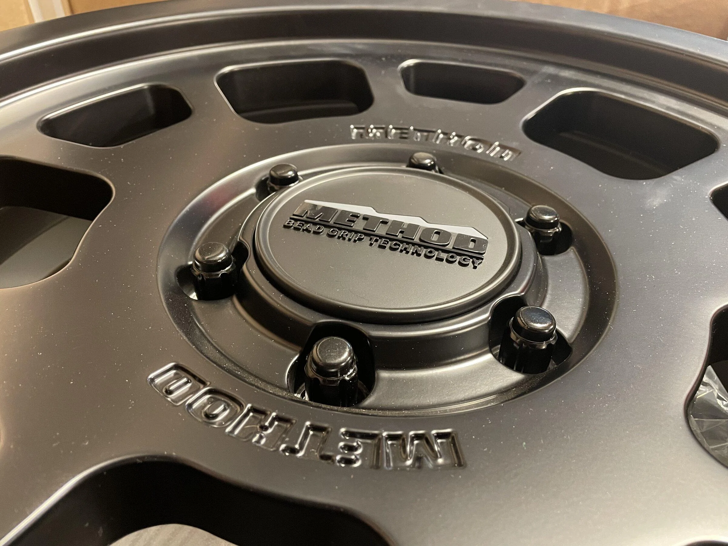

To be perfectly honest, there was no size/dimensional/style difference between my Base base (16" steel wheels) lug nuts and the ones shipped with my Method wheels.
Actually, they only sent 20 lug nuts, so each wheel has one stocker and 5 aftermarket nuts, the spare has only the stock lug nuts.
I'm starting to see a lot of issues pop up with tire wheel combos and I get the feeling folks are buying low end shit and are surprised when it doesn't perform right.
HINT, expensive does not always equal high quality, especially when it comes to what I have seen in aftermarket wheels and tires.
Although, cheap usually gets you garbage quality.
Look close, you'll see the chromie lug nuts! LOL.

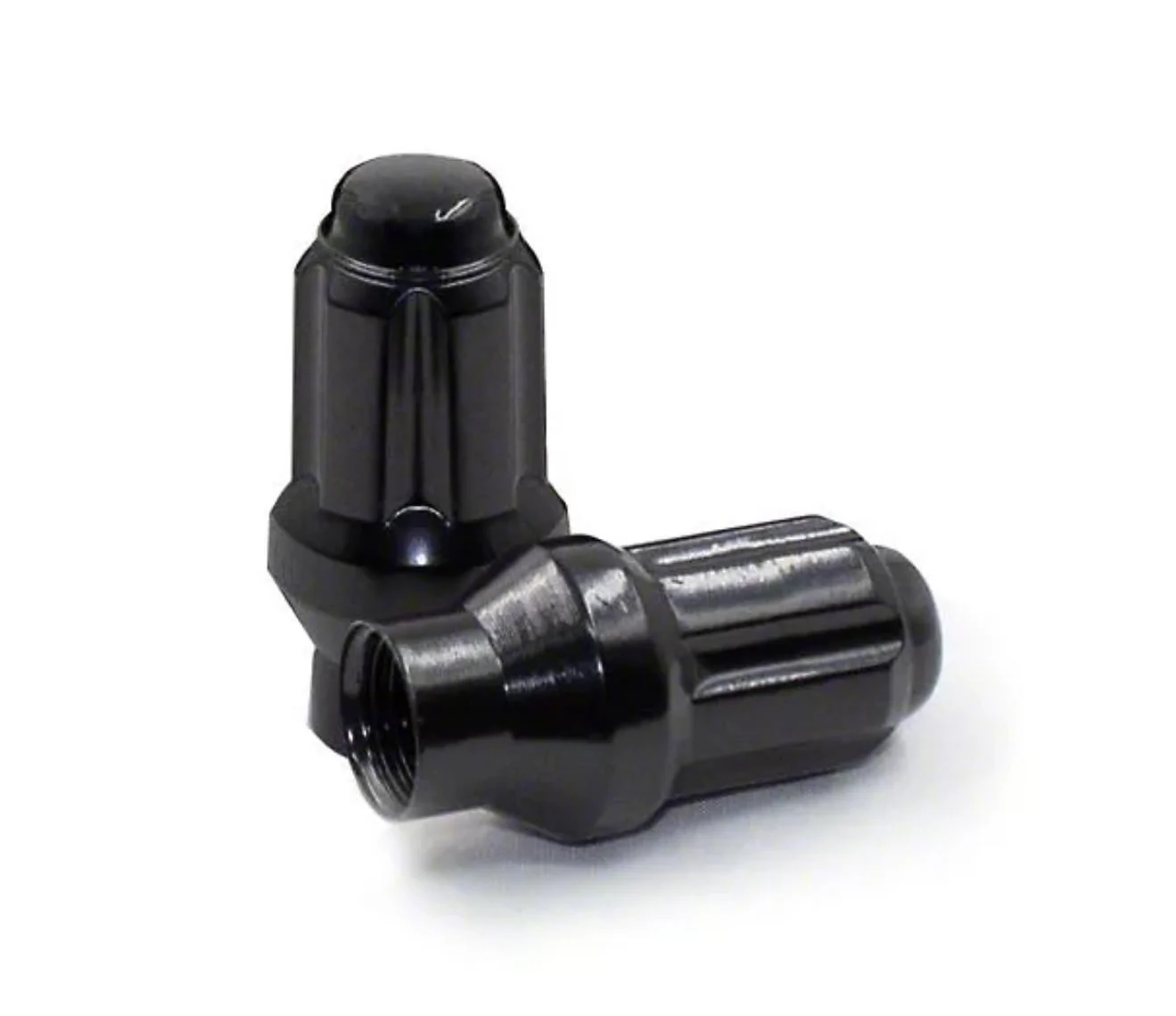

I got these from CJ Pony Parts (they specialize in Mustang). It was nice that they came in a kit of 27 (3 for the spare). They have other kits in Chrome, non-spline, etc. Reasonable price. I'm very happy with mine. Have had Gorilla before and they hold up very well. If you want/need locking lugs, a kit of 5 is very hard to find.

I’m running the same Gorilla brand lug nuts, but in the ET.

Thanks for the info. I noticed the CJPony URL you sent points to small-diameter lug nuts. Since I'm running OEM OBX wheels... I think I need the larger lugs. But -- the CJPony site seems to have a good selection of those to.
