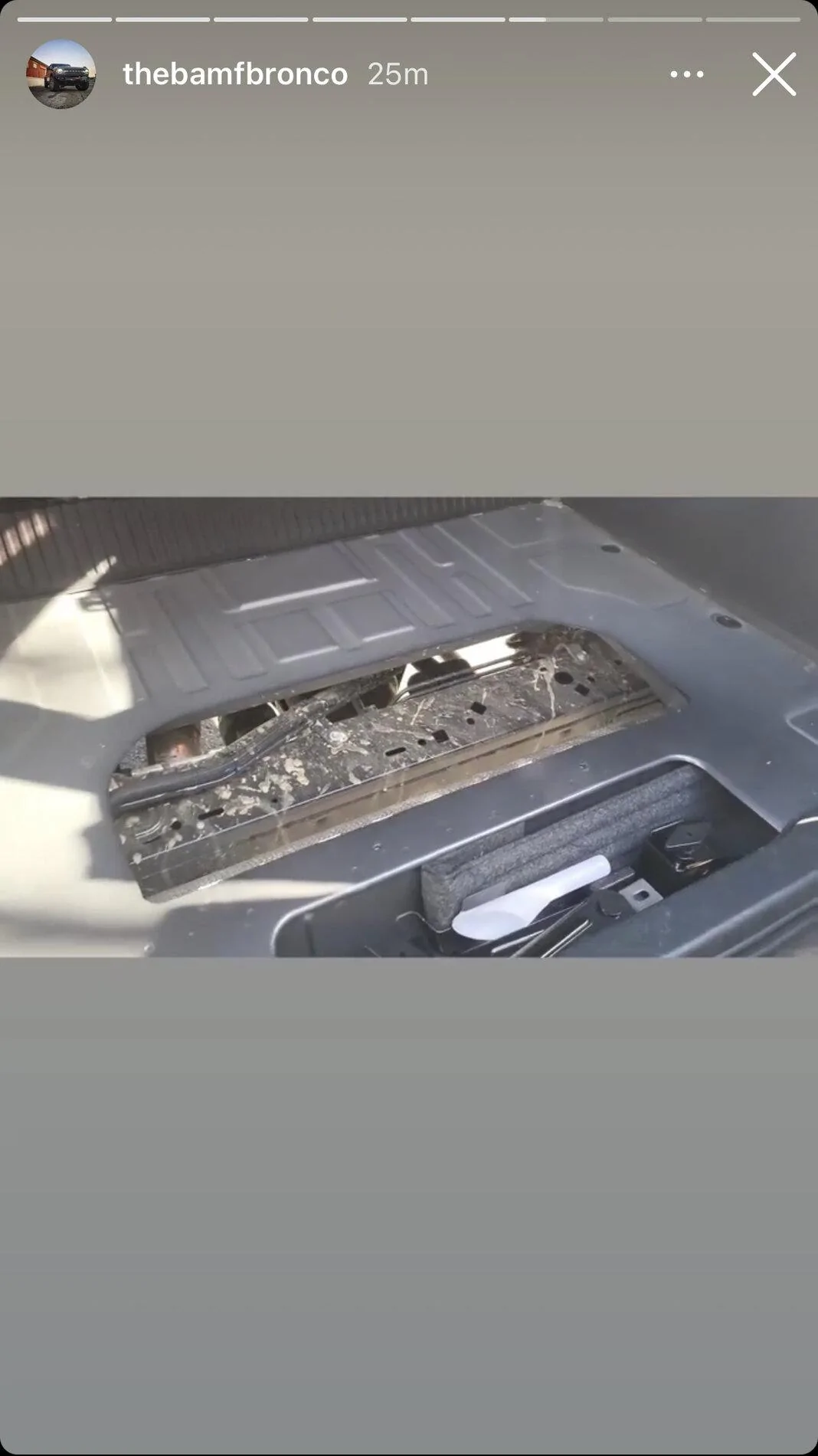

I took a screenshot of BAMF’s story on IG. Looks like you can remove the plastic tub clearly

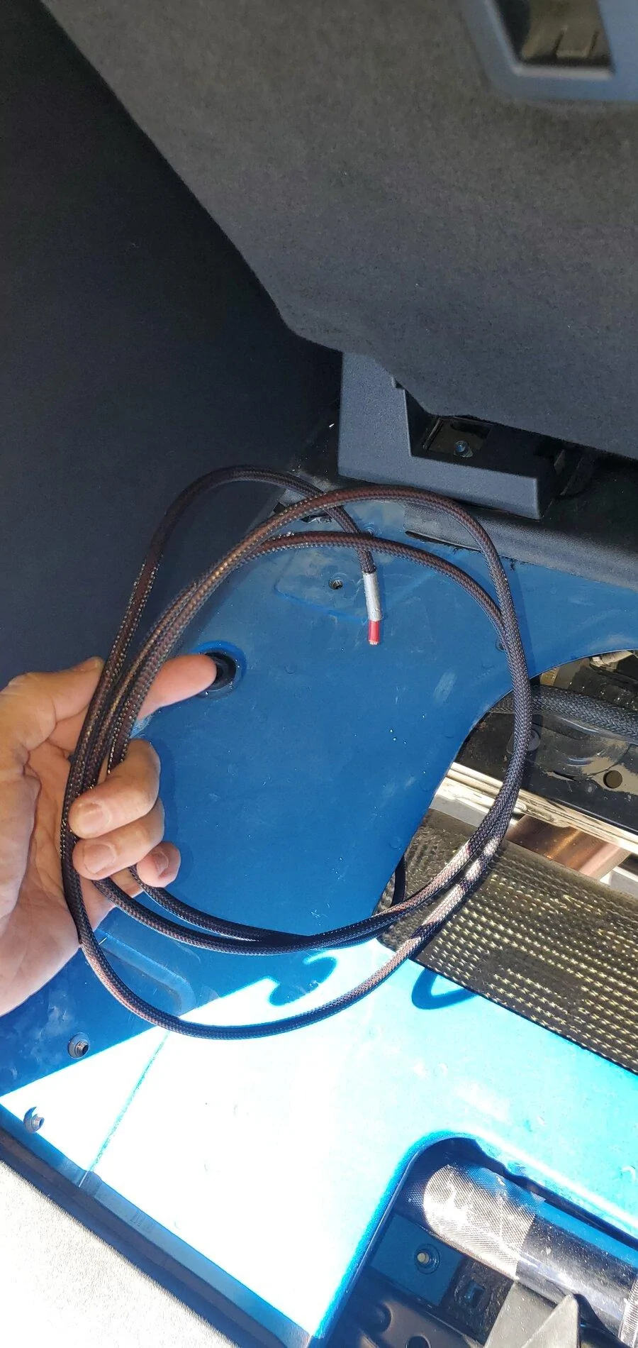

Yea thats what I did. Ran an 8 awg back from the battery distribution box. Still limiting on Amazon to get my dang breaker in though.

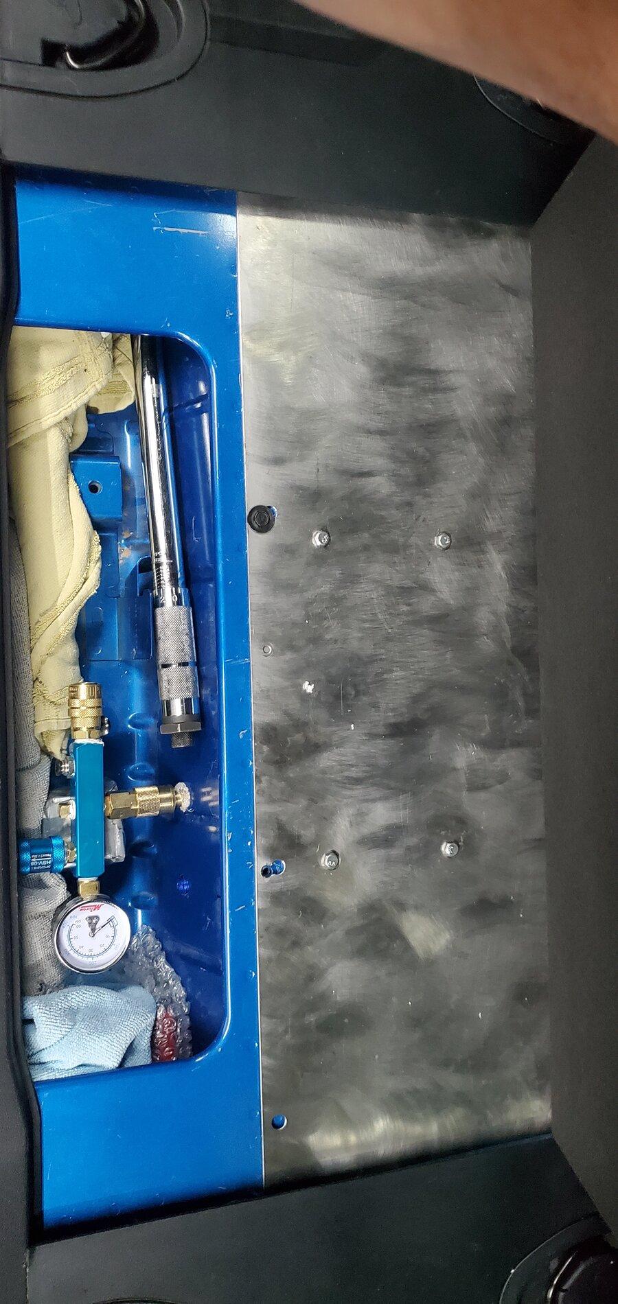

Went to a local scrap yard and got an old piece of stainless countertop of 20 bux. Unfortunately the holes in the countertop that were there already to do whatever they needed at whatever store it was in. Didn't line up. But its fine, the factory floor cover makes it invisible anyway
